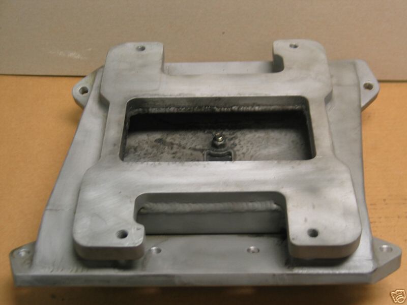

    Here are the pictures of the homemade intake I mentioned. Looks like a pretty big job, but if you can TIG Aluminium it is possible. You probably would need an original to measure and make a jig so that it does not move around too much. I think Dave can tell you about warped blower manifolds.

    that thing is a work of art
    as for jig, I would think if you bolted the peices to a core block and heads with gaskets that would be the best you could get
