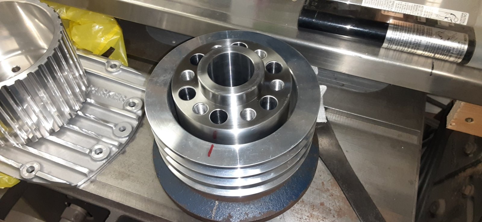

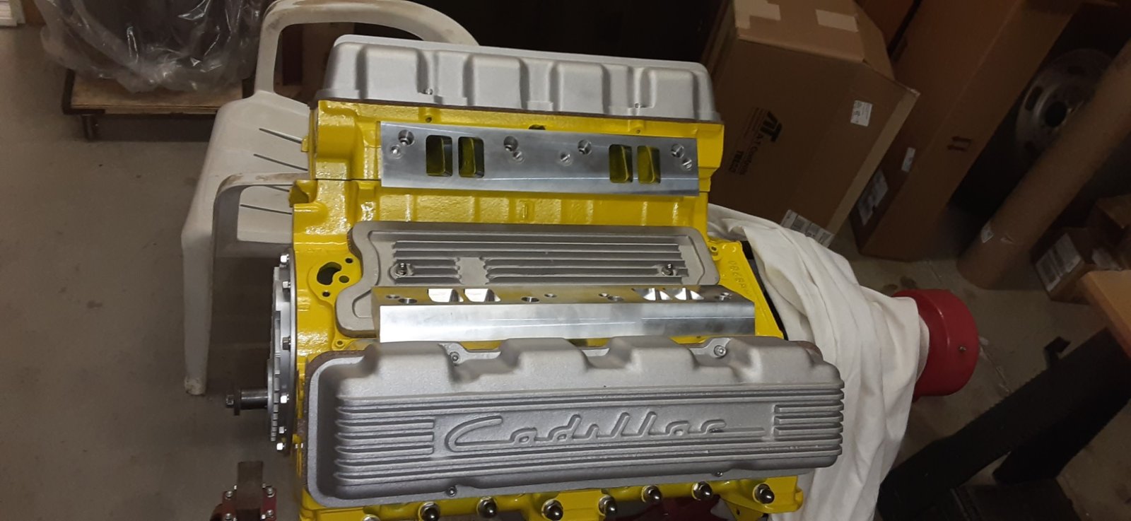

    I know someone making adapter plates to put nearly any SBC intake on the early Caddy, "me", :). Here is a 671 on a '59 block. They'll be available later this summer. I'll post them "for sale" on the appropriate page once they're ready. I want to have all the accessories fit up before I release them.
    Enjoy,
    JK

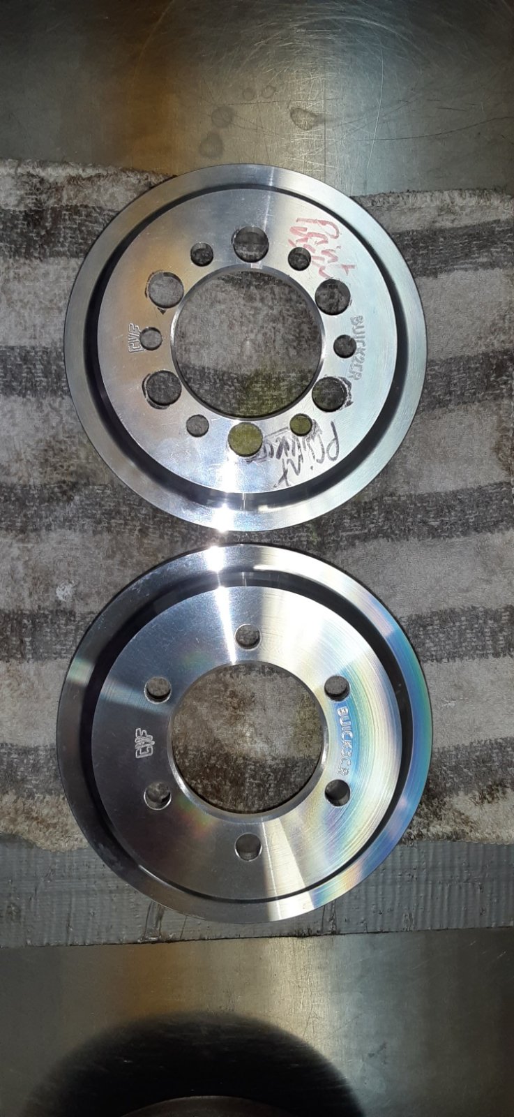

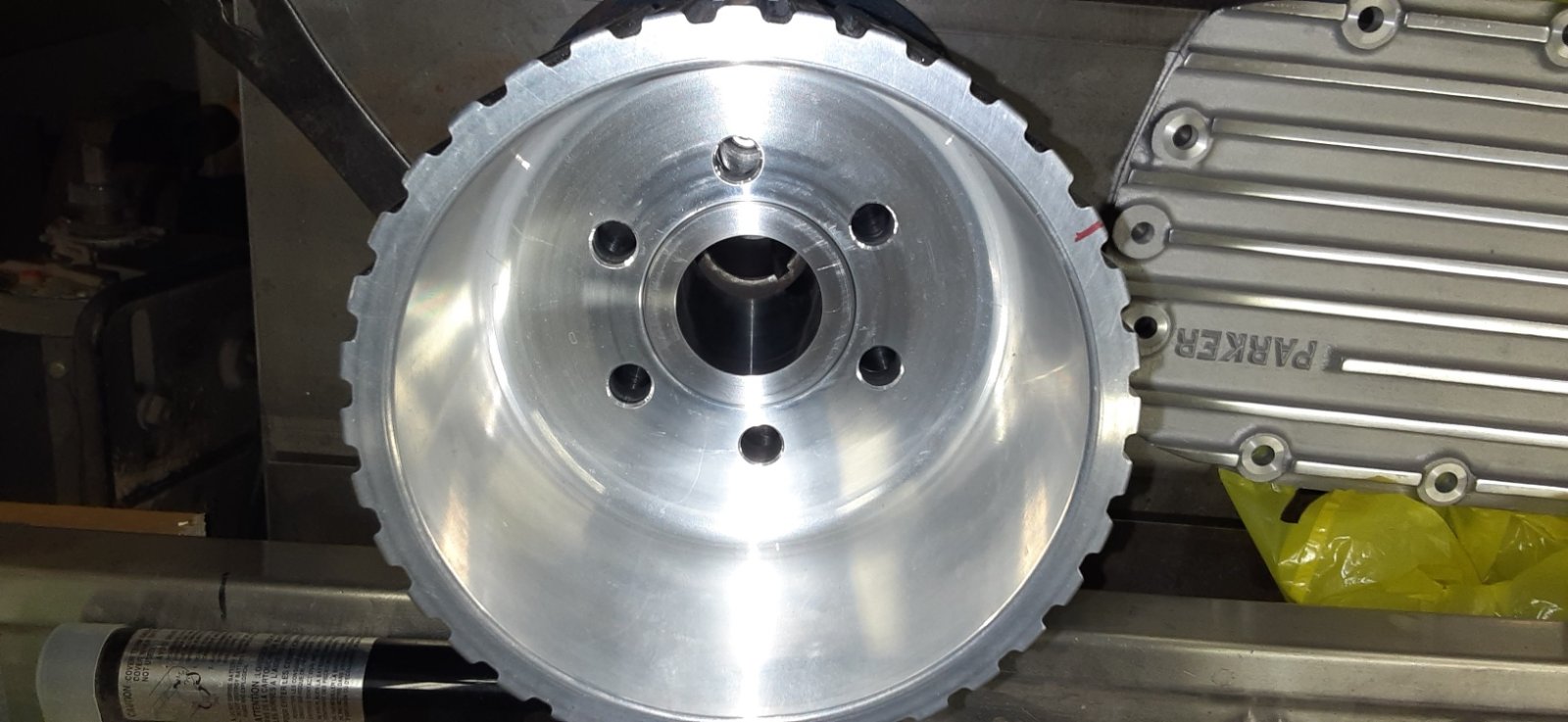

    Here is some info on the lower adapter and the shiny pullies. I used big block Buick by "CVF Racing". I have a 3D model and a 2D machinist drawing of the adapter. I'll stop stealing this thread now.
    JK
