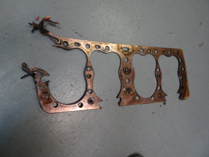

    this is what happens when you have about 9+ lbs. of boost and the head gaskets hold.

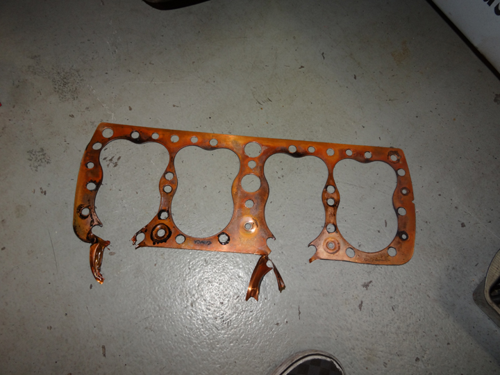

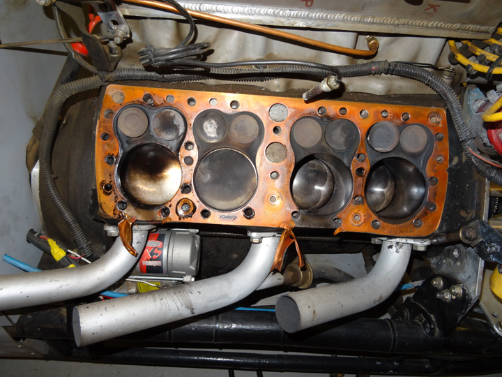

  28. Fedman
    Joined: Dec 17, 2005
    Posts: 1,163
    Fedman
  29. Bandit Billy
    Joined: Sep 16, 2014
    Posts: 17,194
    Bandit Billy
    Holy head gaskets Batman. That's incredible.
    Scotty's Garage! likes this.
  30. Kiwi 4d
    Joined: Sep 16, 2006
    Posts: 4,057
    Kiwi 4d
    Yikes. Please tell us more so we can share your pain.
