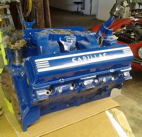

    An early hemi, or Cadillac OHV would motivate it down the road nicely too. That is if the Merc isn't enough for you.
    -Dave
