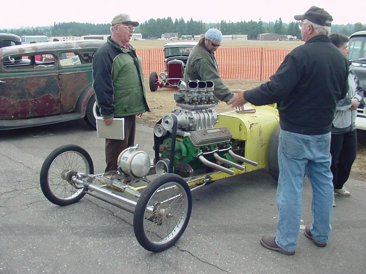

    Looks kinda familiar... did it come out of the Skagit County area?

    good eye, it does look like the same one, only obvious changes are the valve covers and timing cover

    The blower idler pulley is set up different as well.

    The picture of the blown Olds in the rail was taken at the Arlington Dragstrip Reunion about 2008. That one belonged to my nephew at the time. It came out of a '52 Olds convertible from the Oak Harbor area; he added the blower set up and put it in a couple of cars over the years. Never got it running and never tore it down to check the condition of the innards, though I told him he'd better do that before trying to start it. He was always looking for more speed equipment for it and was always adding stuff as he acquired it. Could be the same engine, or not...
    The Hydro that came off the back of it is in my roadster now.

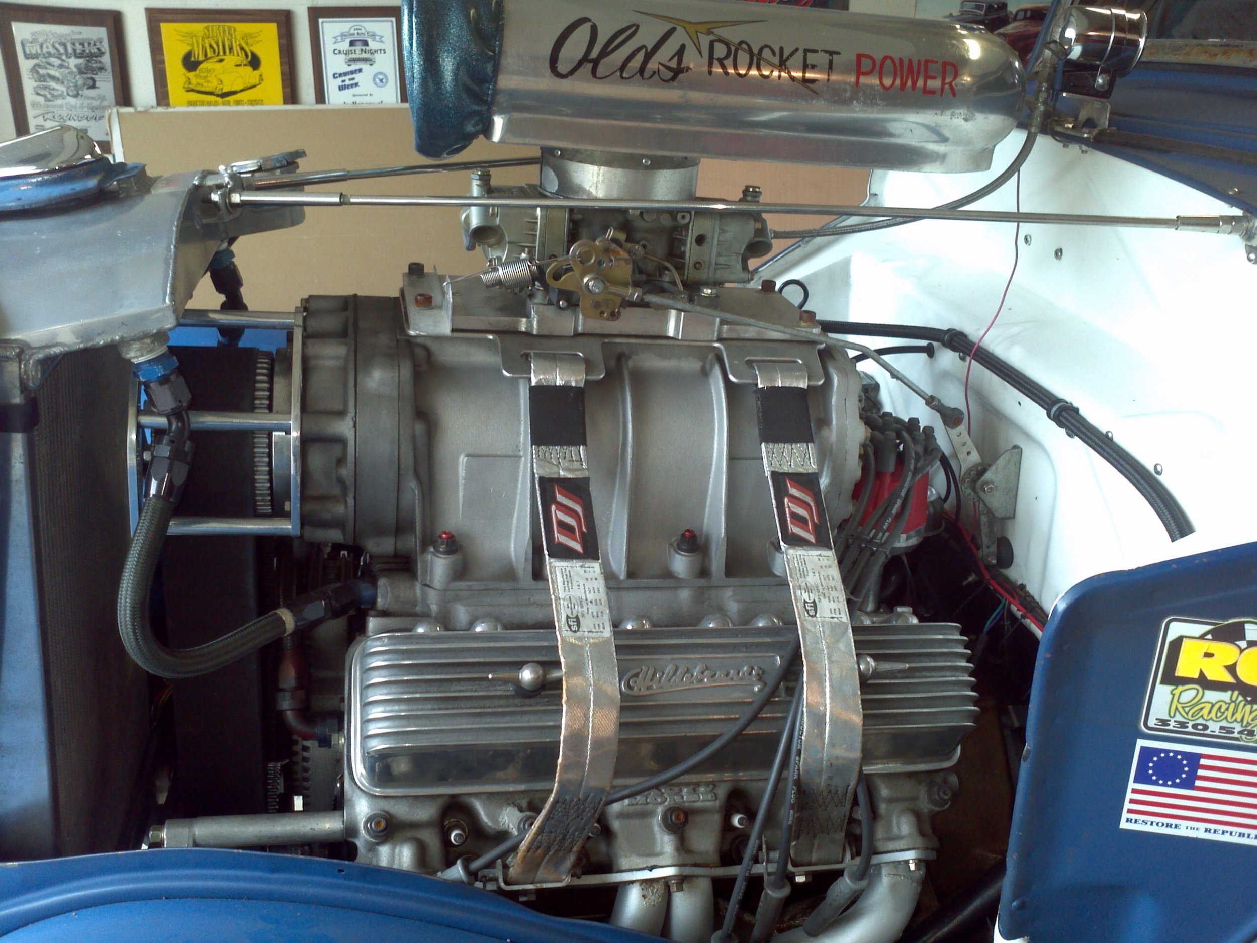

    I have been running a blown Olds (57' 371")in my nostalgia gas 34' Ford for ten years . Love the motor. For one thing it has that "cool effect" attention getter and not just another sbc/bbc. Not the fastest in the bunch but 10.17 / 130 mph is fast enough for me.. IMG_20190314_121234.jpg

    that is fast
    and dig the Ross heads!

    That's gorgeous and those Hildebrandt valve covers are the icing on the cake.
