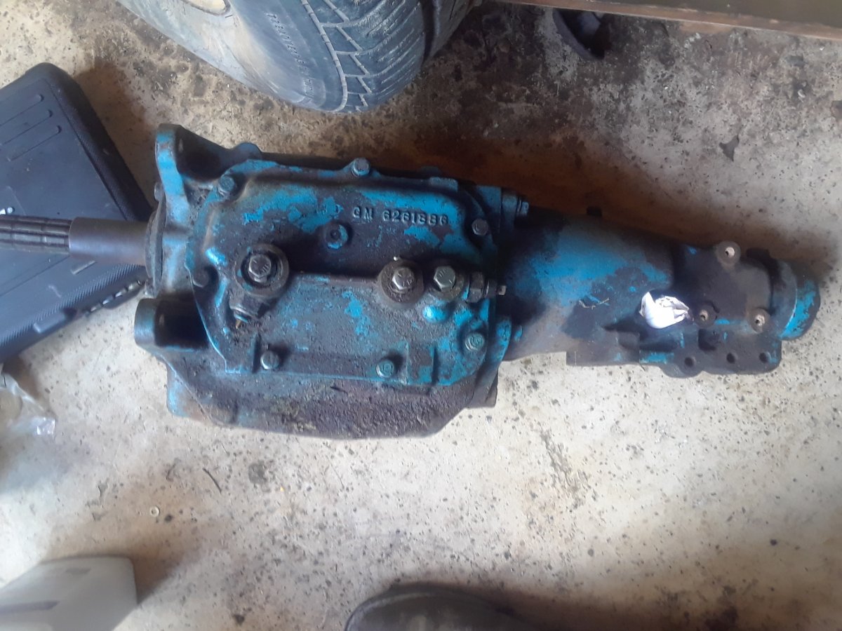

    I bought A saginaw 4 speed A couple of months ago .It 15901687152876662467411859464057.jpg has A 2 ring input shaft, 3.11 first gear and the factory color is blue. I have never seen A blue one and was wondering if anyone has seen one before. I'm just curious what it came out of.

    It might have came out of a transmission rebuilding shop that paints all their rebuilt units blue. Pretty common for trans shops to do this, although usually it's more with automatic transmissions.
    Or it could be a previous owner was painting the engine, and figured the transmission needed it too.
  3. Never seen a blue painted Saginaw either OEM or service replacement. That looks to be a early 70's due to the switch on the 3-4 selector, that was for the emission control system. I forget the original term but it completed the circuit to ground allowing vacuum advance in 4th gear. I don't remember 75 and later cars having that system but I could be wrong there, at least up to 1974 GM was using that. And to throw in a curve, it could have been a mixmaster of parts, would not be the first one I have seen. I don't have the parts catalogs to refer to anymore since I got out of the dealerships three years ago, figured 47 years was enough for anybody.
    3.11 gearing and the three holes in the casting below the extension housing is for the torque arm rear suspension, the Monza HR (fastback) and HM (notchback) bodies introduced in 1975.

    GM did not paint the saginaw 4 speed blue

    That's the only blue one I've ever seen and I think is factory paint you can tell it's been on there A long time.I was wondering if it could have been behide A Pontiac motor.That was just A guess.

    GM never painted transmissions engine color. The engines were ***embled and painted at the engine plant, not the car ***embly plant, which is where the transmissions were bolted to the engines.
    But I expect you can make up a great story for it....that's much more interesting than someone painting it blue some time in the past 40-50 years.

    It's a Vega/Monza transmission. The extension housing bosses on the bottom are where the "vibration weight" bolts on. As long as you don't "beat" on it, it should be fine. The gears are narrower on the 3.11 and 3.50 first gear transmissions. The two switches are for the backup lights and the spark retard feature. No way it was factory painted, any color. I am Butch/56sedandelivery.

    As mentioned it’s Monza and it’s clones. The torque arm bolts to those three bolt holes on the tail shaft. Messed with those years ago. Still have a trans like that in my Dads garage in Michigan.

    A lot of the 4 cylinder engines had a weight hung on the 3 bolts on the tail shaft and had the 3.10 low gear...

    I worked in a shop in the 70's that painted complete rebuilds red, repaired trans black and patch jobs silver.....................

    Ammco used to paint their rebuilds that same color blue.
