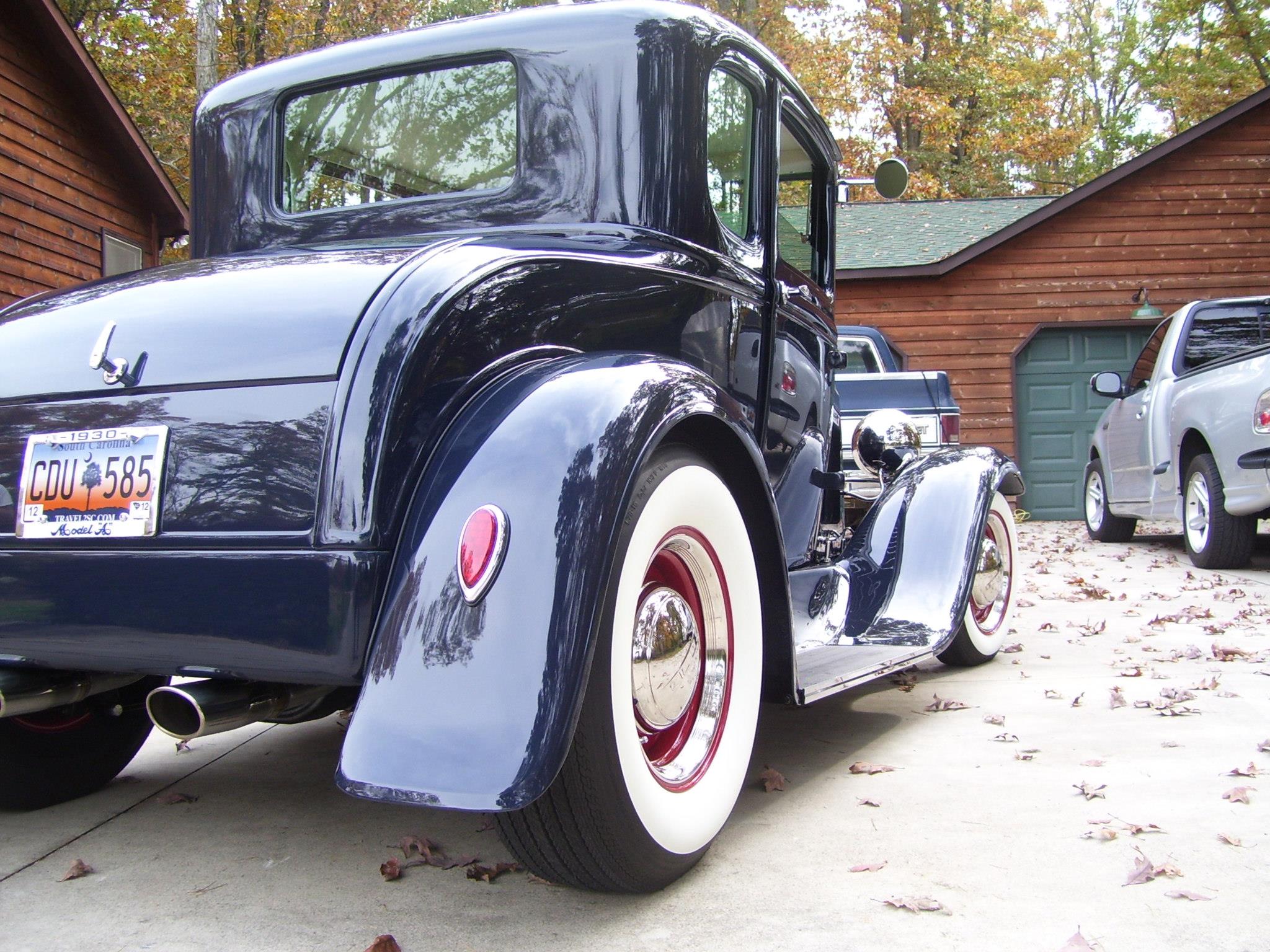

  4. Fenders
    Joined: Sep 8, 2007
    Posts: 3,921
    Fenders
    Seven inch section out of mine....
    But for fiberglas flthd31 did it right. Seam will eventually show if its sectioned.

    X2, definitely section and I would add the rolled pan with the fender tips about 2 in below the bottom of the pan.

    I'm actually in the boat business, so I have been doing the gl*** thing forever. Done right, sectioning a fibergl*** fender will be stronger than you think. It will never be steel, but if gl*** is what you have, I wouldn't be afraid to section them. The trick is to move the join line as far up into the fender as you can without disturbing the arch. This will give you a long enough "tail" section to layer the joint over an extended area - using multiple layers of gl***, each spreading further out on the feathered joint. Most people will try to make the "tail" as short as possible, and then there isn't enough area to layer the joint.
