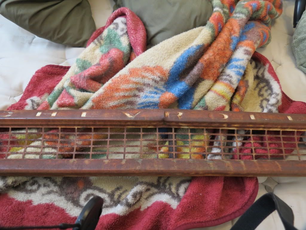

    The grille had a little gerrr in it that required some attention. Other than that, the stocke grille is in pretty darn good shape. So, I tried my hand at a little hammer and dolly work. Thanks to Chip Quinn for loaning me some equipment, and advice.

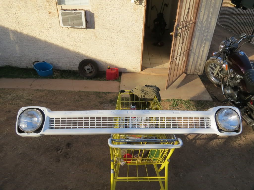

    The white fought me a bit, and I had some problems with the paint. The grille will be getting redone, but, I need the truck at night for now, so I'll have to handle that here in a few weeks.
  13. The surround is done, I'll touch up the few spots where the paint made it past the masking tape. I'm not very happy with the grille. I had a heck of a time doing the hand lettering, so, I'll consider this a practice round. So, here it is, for now. I call it "my half-***terpiece".

    I think it looks fine Bodi, How would you improve doing the letters again if you had to do it all over?
  17. It looks OK in the photos, but, when you see it in person, close up, it looks terrible. I called it "drunk 3rd grader quality", Chip more accurately ***essed it as "drunk kindergartner quality". It really is pretty bad. It's one of the first things I notice on these trucks, and I've seen many that look poorly done, so, I want mine to look good when all is said and done.
    The biggest thing I learned this first go round is that the paint makes a huge difference. The viscosity is critical. If the paint is too thick, you have to help it disperse, and break the surface tension. That translates in to a lot of relying on the steadiness of your hands. I have good hands until I need to do something important like this.:rolleyes: If you get the paint thinner, and position the grille so that each letter is flat you can use the lesser surface tension to where you are just "filling up" the bottom of each letter with paint. The edge of the lines comes out much better. I learned that on the later letters in the grille, and they turned out better. Secondly, from the advice I've read on another thread I started, a good lettering brush should help. I used a Testors model brush. I cut it down fine, but still had problems with it not being fine enough, and the "hairs" didn't lay the way I wanted. The inconsistency of that fought me tooth and nail. I'm going to go get a proper brush, some One Shot, and give it another try. If I can't get it the way I like it that way I'll do it again, and just use that masking contact paper. I'll cut the letters out with an X-acto knife, and then spray it.
    I know this is just an old farm truck, but, a poorly done black and white lettered grille on the front of these just sticks out so badly to me.
