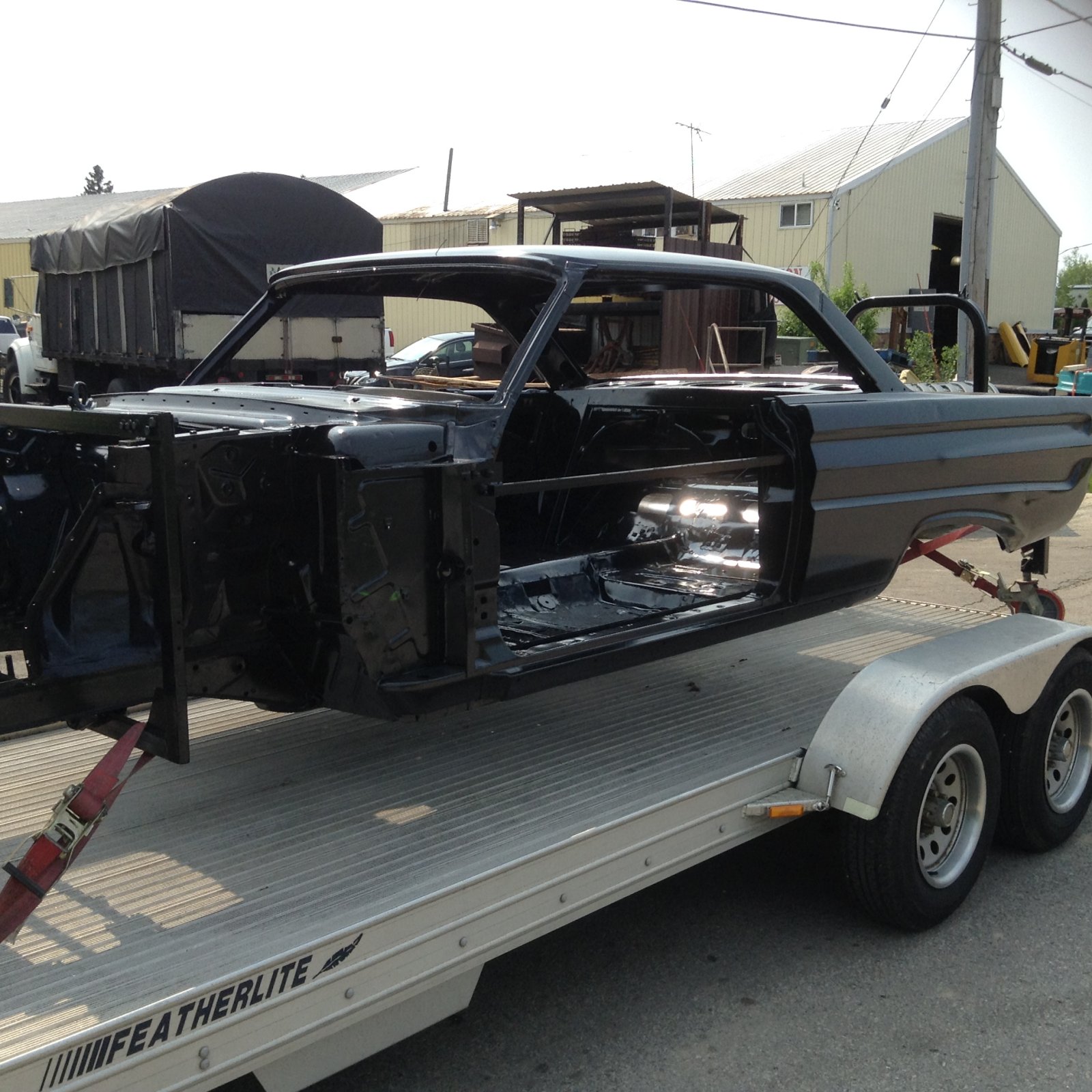

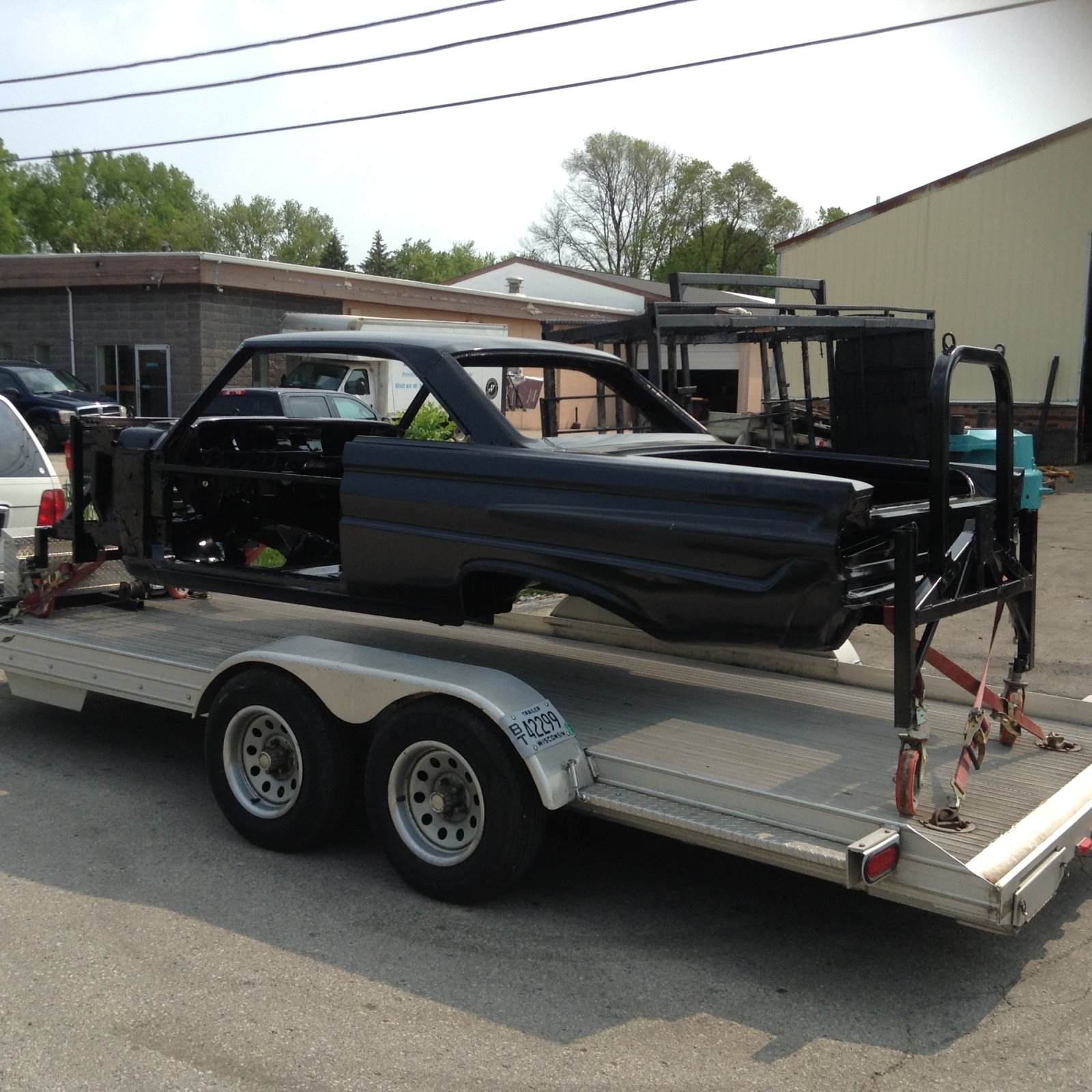

    I have been using this company for many years and highly recommend them. They are not near Florida but they may be an option for you. They have done complete body’s, misc parts, even vintage has pumps for me, most of the parts I have e coated also. (Recommended)
    http://metal-cleaning-rsi.com/Contact
    Here is my avatar after it was stripped and ecoated:

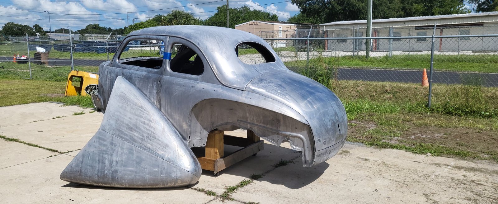

    20220906_111004.jpg Cl***ic Auto Stripping
    136 East Townsend Street
    Wachula, Florida 33873
    863.773.0869 Darin

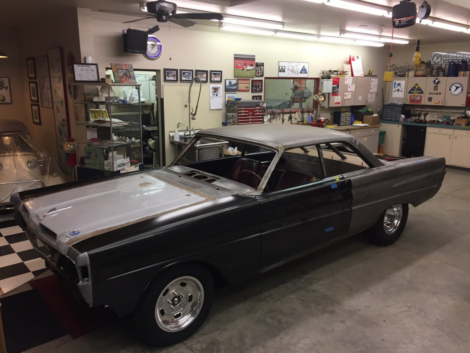

    Being the ecoat process is done by submerging the object the coating flows into every crack and crevice, the only exception might be a very tight seam where there are multiple layers of metal spot welded together. I have had doors ecoated and they have come back completely coated inside and out. I believe they “turn” the parts when they are in the tank which helps with the flow. I have not had any issues with seams after the process, but I have used a quality seam sealer in the appropriate areas after the epoxy primer. Ecoat does not have any ultraviolet resistance but if left alone and not top coated in areas like the inside of a door it will protect the metal almost forever.
    One thing that I have done is to have a body “80%” stripped then bring it back to the shop for metal work and or fabrication, after that I send it back for a final strip and ecoat. This makes working on the body easier because all the metal is clean, no paint, rust, sound deadener, etc.
    The ecoat must be removed in the area that will be welded, not an issue if it is epoxy primed after the repair.
    Here is my avatar with the body stripped 80% and the front fenders and doors stripped and ecoated, the body went back for a final strip and ecoat soon after this photo was taken.

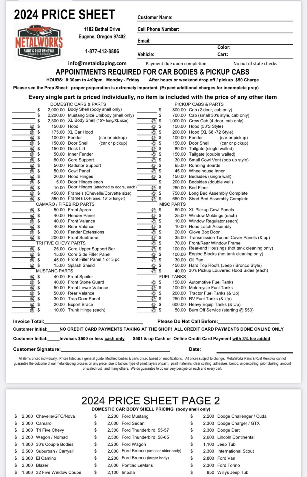

    This is who I use and have been happy with. Don’t get surprised if they have a 90 day waiting list.

    Those prices appear to be for dipping only, not e-coat.
  18. uncle buck
    Joined: Feb 13, 2007
    Posts: 2,134
    uncle buck
    You are correct. They do finish it with what appears to be a phosphoric acid treatment similar to Rust Mort
