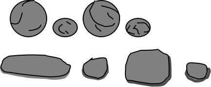

    Talc: Talc is the main body of a filler. Think baby powder as a common talc product. The are different sizes and shapes of talc used in various products. There are two basic shapes of talc used in body filler and putty: Spherical (top) and Platelet (Bottom).
    Round talc is what is used in body fillers. It is easier to sand due to the fact that you are generally sanding a smaller area of the mineral.
    Platelet talc is usually used in putties because it is easier to spread and gives a smoother finish and a denser surface structure. The easiest way to think of the differences is think of trying to cover the bottom of a box with balls or sheets of paper. You will get more spaces between the balls than the sheets of paper and thus not as dense a surface. Combine this with the special resin used in putties and you get a surface that does not absorb nearly as many solvents as body filler during primer application.
    Microspheres: Mircospheres are tiny hollow gl*** or plastic bubbles that are added to fillers and putties. These are what makes a filler a lightweight product. Micropsheres main purpose is to increase sandability. Cutting through the hollow sphere is much easier than the solid talc particles. But there is obviously a trade off in they are not a solid particle that will add stability and density to a surface like talc will. Filler companies use this to their advantage to make cheaper fillers that sand really well without having to use more expensive resins and finer talc grinds by adding more microshperes which sand better but don't provide as dense or hard a surface.

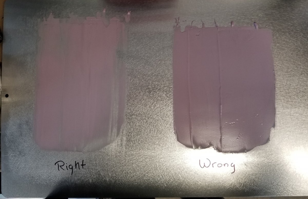

    Ok now we will talk a bit about mixing and applying. With the exception on one product all body fillers are a 50:1 mix ration or 2% weight by volume. You should always kneed the hardener tube and stir your fillers before using to ensure everything is mixed up as they will settle and separate over time. The easiest way to eyeball the correct amount of hardener to use is with a simple ribbon method. Place your filler on your mixing board and let it self level. You can bang on the bottom of the board to speed this up. Then depending on the size of the puddle you run a ribbon of hardener across the puddle. A 2" puddle you run the hardener half way across, a 4" all the way across, 6" all the way across and 8" all the way across and then another strip half way across. This method has been tested with a scale and is well within the accepted ranges of hardener use.
    Note: Do not use porous surfaces like cardboard to mix fillers or putties on as they will absorb the products and can change the ratios.
    Over and under catalyzation are the cause of the vast majority of issues with filler. Too much can lead to filler becoming brittle and cracking. It will also increase the chances of pinholes forming. Under catalyzation can led to shrinking and movement later on down the road which can lead to mapping of the repair area. so make sure you try and keep pretty close to the about ratios.

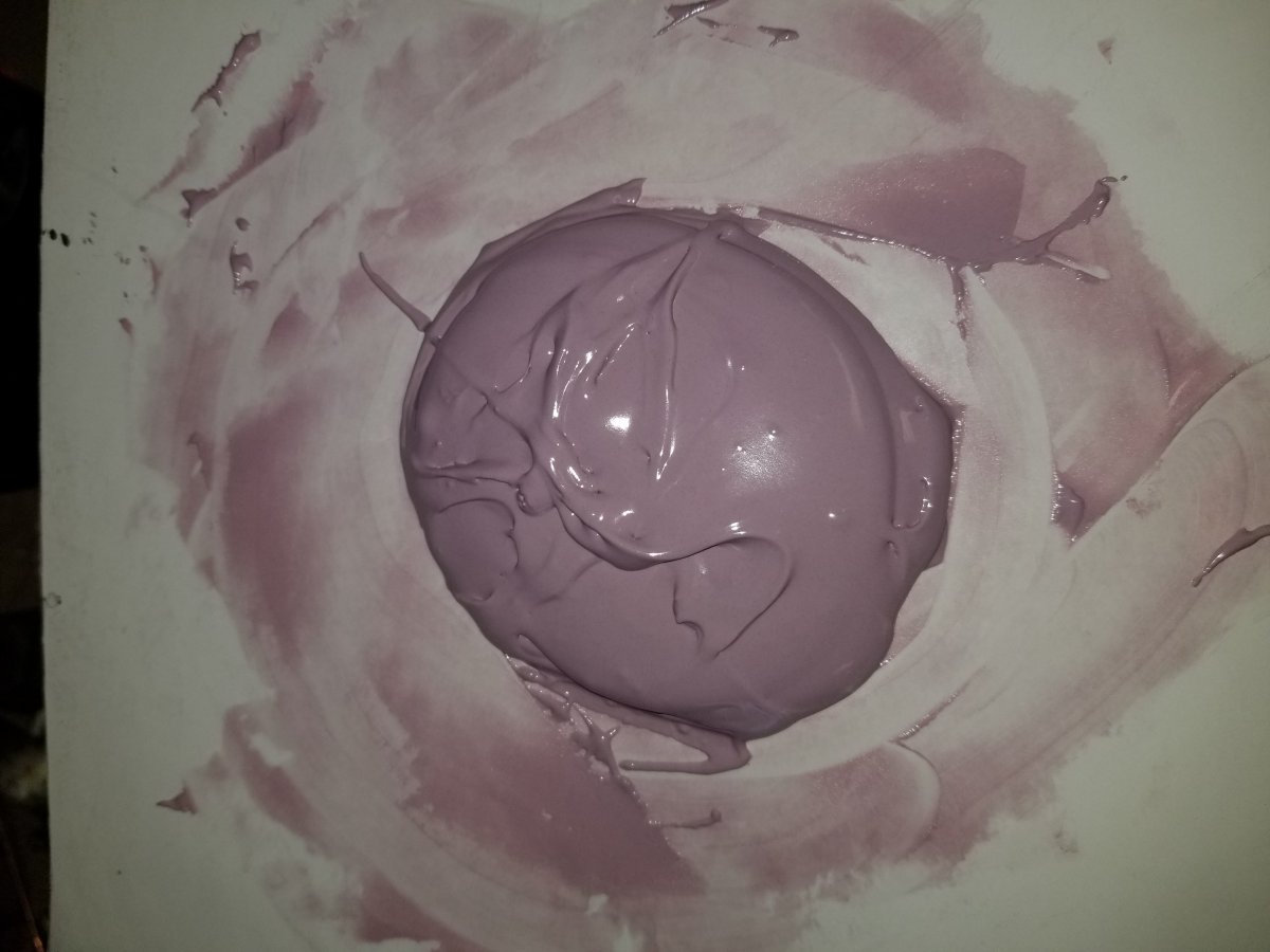

    The best way to mix the product is to try and fold it over itself rather than stirring. This tends to add less air to the mix. You want to mix it until you get a uniform looking product. You do not want streaks of hardener in the mixed product. It should look like this

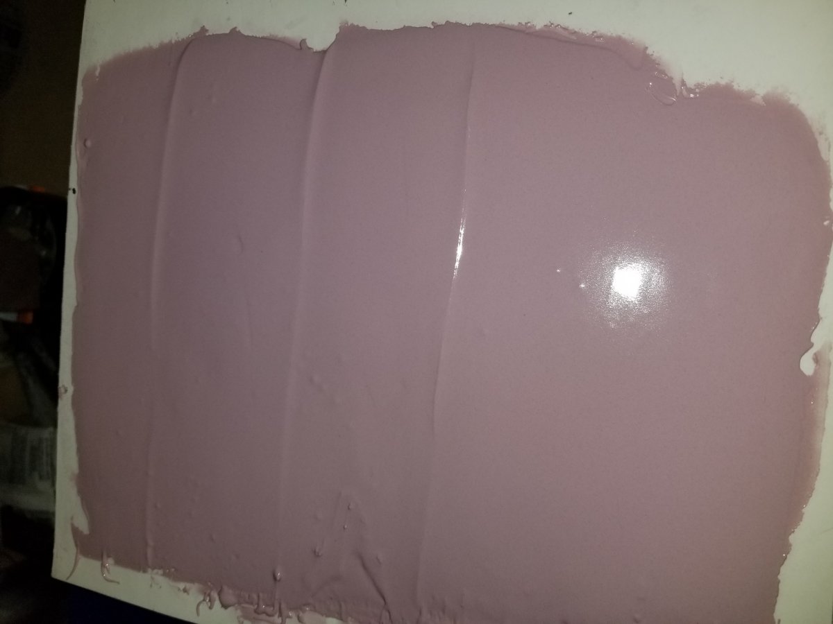

    A little tip when you have finished mixing your filler is to spread it out over your mixing board rather than leave it in a pile like the picture above. This will do two things. It will slow the catalyzation so you will have more working time and it will let any air you have added during the mixing process escape.

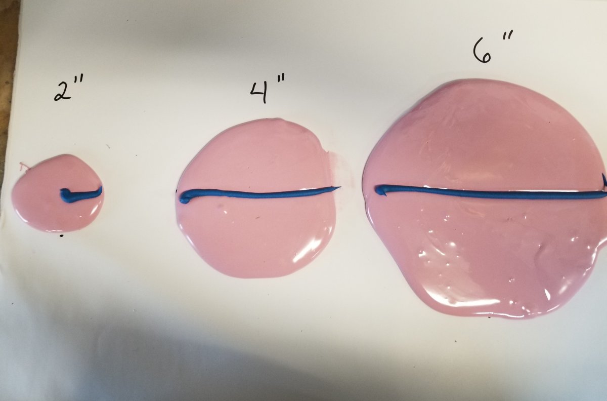

    A little closer look.

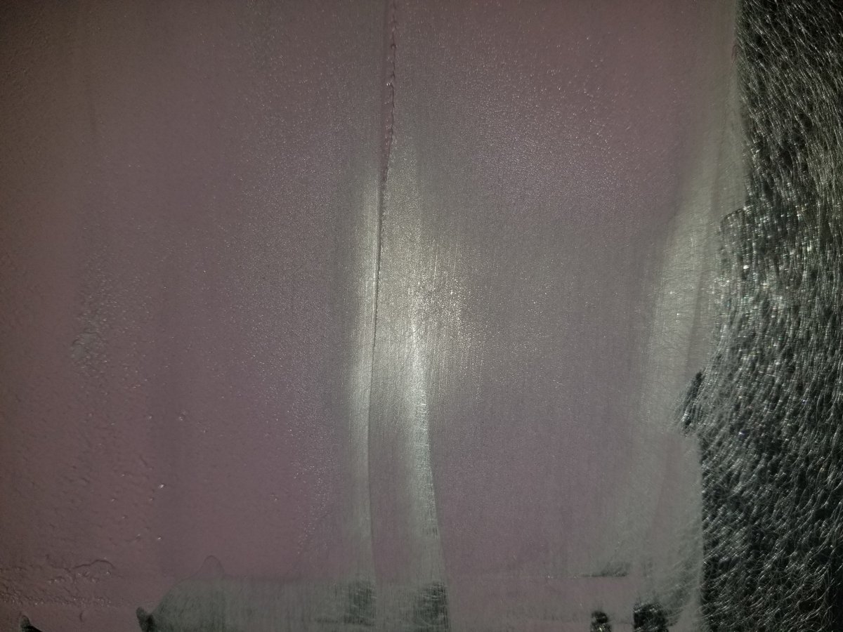

    Let it dry and sand, reapply as needed. Once you have filler down you should not use solvents over top of it as they can be absorbed and then kicked out later causing failures. Just blow it off and reapply.
