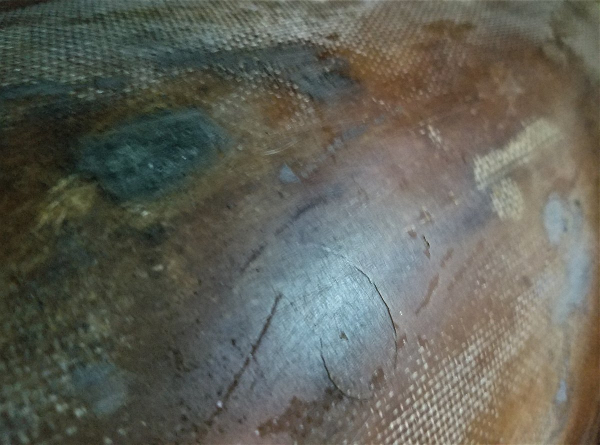

    Very interesting thread. My question if for the grit of the sandpaper. I only do metal work. I only do drywall work on my own stuff, not on anyone else's. I grind the welds down with 3M green corps 01991 wheels on a die grinder. I have been using 36 grit 3 inch roloc discs for the final finish on bare metal, once all the weld bead is gone.
    The only negative feedback I have ever gotten was by one painter who *****ed that the 36 grit marks were hard to cover up. My response was that he obviously didn't need any filler in those areas, BUT, perhaps I should be going to a finer grit to make everyone's life easier. I always figured the co**** grit scratches were a good thing, to enhance the surface grip.
    I do pretty much zero bondo work, but everyone knows you are still going to need a little filler. I use 24 inch stainless steel ruler, laid flat on the panel surface. If I can see light under the ruler I bump up the lows, and/or take down the highs with shrinking disc. (I find it much more satisfying to do metal work than to sand the filler)
    I don't promise anyone that they won't need a little filler, but it will be damn little, so that is why I ask about the co**** grit sanding paper on bare metal before filler application. Your comment on body shops wanting to use 80 grit made me think about that. Thanks. Great thread.

    I can't think of a primer that is designed to go over 36 grit. The minimum is usually 80 and more often than not 180. Rolocs put in the worst kind of scrartch to try and cover because they are straight line scratches that require a lot of primer to bury and can often lead to problems like sand sctrach swelling or die back. Now having said that the standard procedure should be to sand the bare metal before applying anything anyways so a shop should be doing at least one step of sanding prior to any product being applied. Probably best to ask whoever you are doing the work for what they prefer. Lots of old school guys down in the Lethbridge area that are hard to convert to new ways. Believe me I have tried.;)

    Thanks. Biggest reason I use 36 grit is that after about 2 minutes they are 60 grit, and another 2 minutes they are 80 grit it seems. I am a cheap sob, I guess. I think I'll try some 80 grit next time I buy a box. Appreciate the info.

    When I managed a body shop I wouldn't let my guys use anything co****r than 80 grit. It may take longer but I didn't want issues later with primer/paint shrinkage and sanding marks showing back up later.
    If im shaping I'll use 36 grit but I come back with a body file and then finish of with 80. I actually enjoy using the metal body file.
