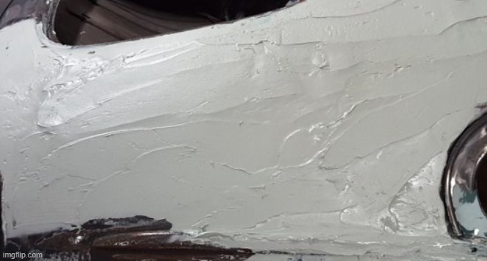

  4. I’ve see guys slather filler and it looks like they frosted a cake and post pics of it.
    Then there’s a squad of guys following and saying ohhh great job.
    You damn sure gonna need a cheese grater to get anywhere doing things like that
    Roothawg, alchemy, fauj and 2 others like this.
