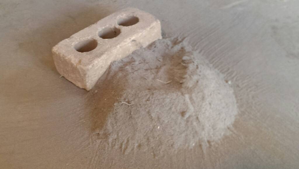

  18. luckythirteenagogo
    Joined: Dec 28, 2012
    Posts: 1,271
    luckythirteenagogo
    from Selma, NC
    Model T1 likes this.

  21. tb33anda3rd
    Joined: Oct 8, 2010
    Posts: 17,587
    tb33anda3rd
    wow, how far down did you find the brick?:D
