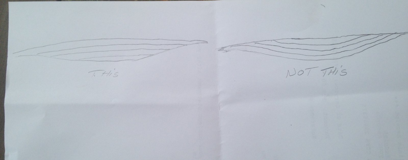

    Its best with better metal work but if necessary filler in manageable layers.
    Just be sure to break the surface fully with sandpaper before adding the next layer. Try to keep each successive layer bigger than the last, meaning each batch is mixed bigger and covers more area. There's not much worse than finding a low spot in a panel that's been filled and blocked and then trying to fill that and block it down - it messes up the earlier work and you just about gotta start over with one more coat.
    The example on the right will make you work 5 times as hard, put more mud on the floor, more money out the window, for a result that makes you "one more coat" insane.
    If you have a panel that has 42 dents, fill 42 dips. Maybe you need to fill and DA them twice to get them up. THEN skim the whole panel. Don't skim the panel, block it all down and try to fill 33 of the 42 dips you find left in the blocked mud.
    Knowing when you're ready for the final skim coat means you only have to skim coat and block the whole panel once.
    It's the high spots in the metal that really ruin a days fun of body work. To get a car straight the entire surface of the panel needs to come up and meet that hight spot in a smooth transition. High spots go away with a hammer and dolly and or shrinking.
    Think of a polished granite counter top, now glue a Nickel in the middle of it, that's one high spot. How do you build up to that high spot? Cover the entire surface by the thickness of that one Nickel .

    Thanks for the pic '31Vic. Great point about filling the individual lows first and then skimming the whole panel. I'll be paying more attention to that in the future. If I ever try plastic filler......:D
