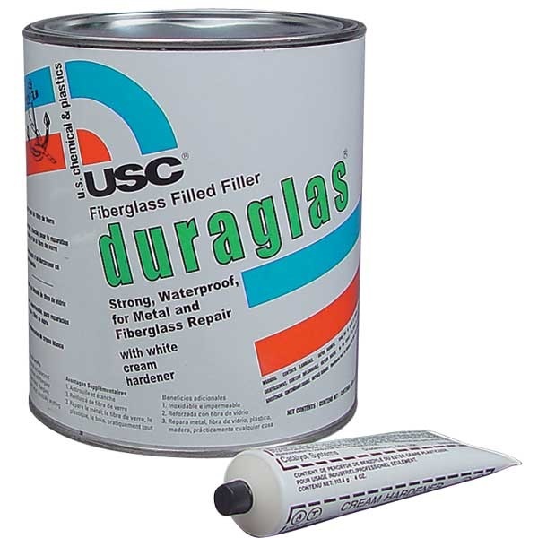

  14. See on the can:
    With white cream hardener.
    It's been a while since I've actually gotten the white with the dura gl*** though.
    Model T1 likes this.
