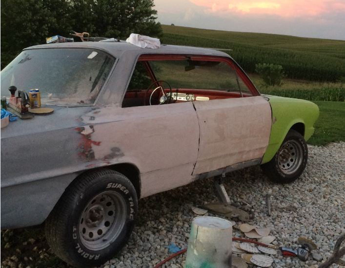

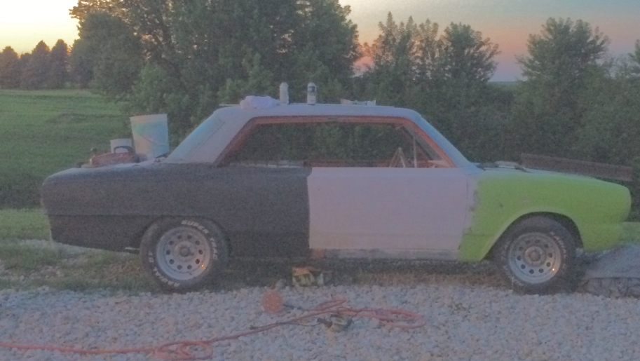

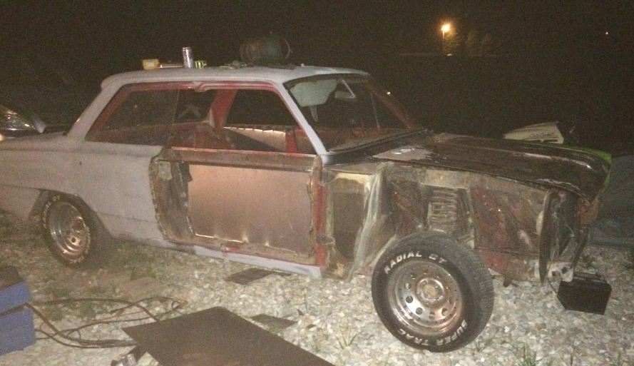

    In case anyone is interested, here is what I'm working on.

    That is EXACTLY my thinking. When I decided to buy my first project, I didnt put much thought into. I bought a truck that had been primered, and the more I looked at it, the more scared of ****ty work I became. I ended up finding a untouched body that had a lot of rust, but at least I wasnt re-doing what someone else had already half *** done. Now that the rust is fixed properly, If I ever decided to paint it, itll be done right.

    RamblinPat
    I think it depends on the scope of the build a bit as well. As you can see from my pics above, this car has quite a bit more than normal. However, this was a 4 door inline 6 sedan that as a full restore would bring maybe 2500? I really wanted a 2 door, but they have gotten incredibly scarce in the last couple years. I have also learned a ton about body work on this old girl. I think I went into this project thinking "I will never be able to sell this once I start cutting". However, the same could be said for the car the way it was.
