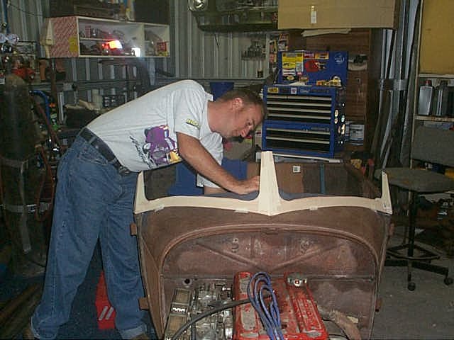

    After doing some research, and identifying some crucial dimensions (like the angle the glass lays at, the overlap required to secure the glass, and some basic overall dimensions) I made a ‘mock-up’/pattern of the frame using the balsa wood, trimming and shaping to ‘replicate’ the traditional look which lusted after.

  4. After creating the basic pattern for the ‘outer’ skin, I traced it onto the 3mm alloy plate, cut it out with the plasma (although that’s my friend in the photo, my bald spot isn’t as bad… [​IMG])
  5. Then file it all nice and smooth (remembering that you want a bit of ‘green’ as you will be trimming/shaping to match the top of the tank).
  6. The outer pattern, and the plate...

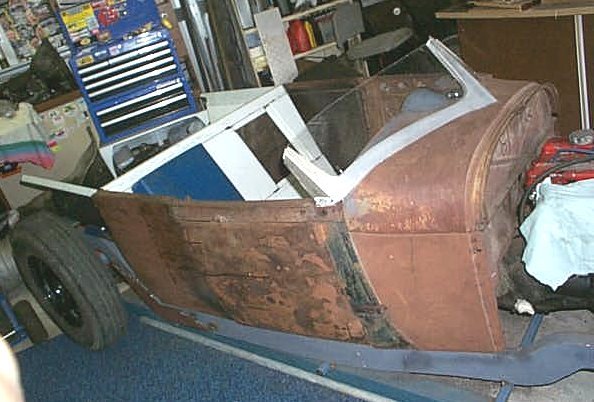

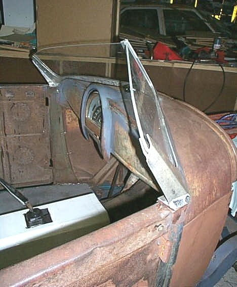

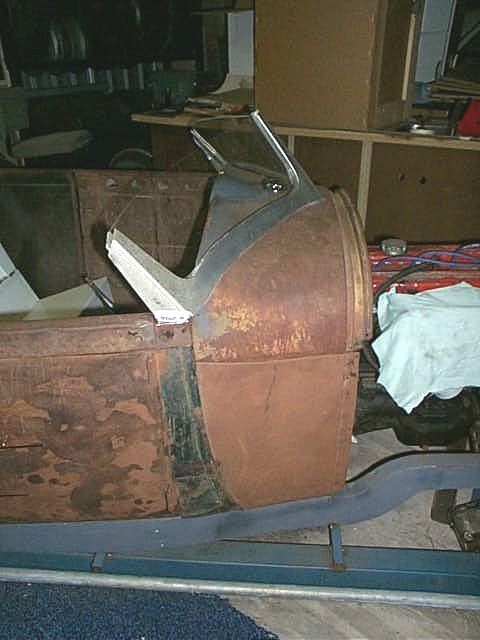

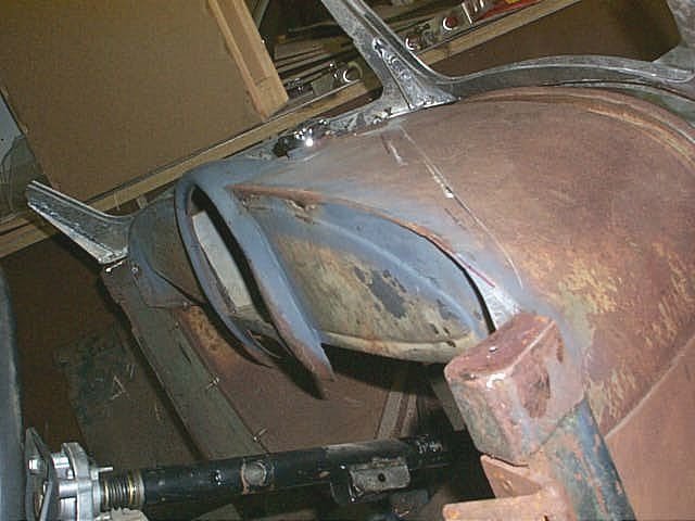

  8. Be aware that you will need to trim the old fuel tank, and more importantly, you will need to cut off the top of the old windscreen frame mounts, weld on a plate for the new screen to mount to. One very important feature that you need to include is the provision (i.e. nut) welded to the underside of the mount as it is very awkward to hold a nut under there when fitting the screen [​IMG].
  9. Another view...

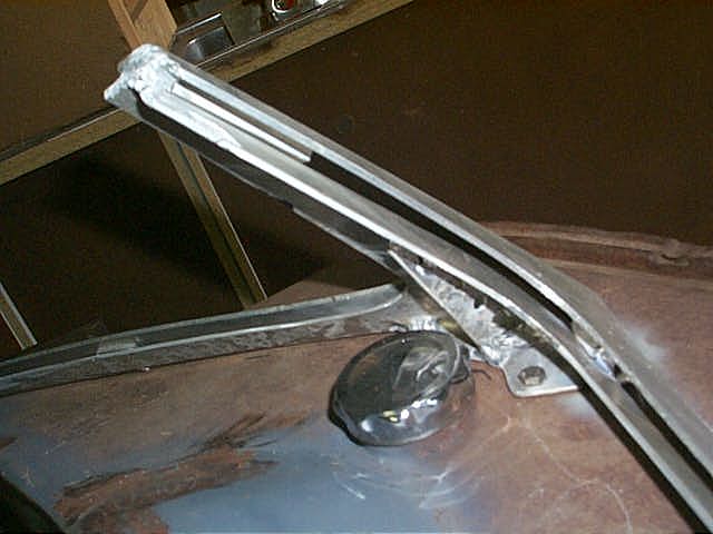

  10. Obviously you need to bend the plate at the centre and at the ends, and then make an inner pattern (so that you can sandwich the glass).
    I spaced the two skins 10mm apart (the glass used will be 6mm thick; with a rubber packing used either side to fill the gap).
  11. After welding it all up, and doing a lot more filing/fitting/filing, the screen starts to take shape.
    I made a pattern out of thick cardboard for the glass, trimming till I got the shape I desired.
    Temporarily I’ve got some Perspex, although it will be replaced by laminated safety glass when it comes time for rego.
    Anyhow, the following photos are of the car now. I still need to tidy up some of the welds, and give the basic surface finish some ‘quality’ time with some fine sandpaper to get a nice and uniform satin finish, but that can wait till I get ready to paint the car.
    Note: I’ve mounted the screen to the mounts (i.e. 2 x ¼” holes in the tank at the leading edge, and 1x ¼” hole on the outer perimeter) using S.S. bolts and nylock nuts with spring washers all round. Also notice that I gusseted and braced the frame to give it some structural integrity, as the air pressure at speed will want to deform the frame substantially.
    Also, whilst the comfort levels are small, I have made provision for a roof. The level of work required for one to fit easily has been sacrificed as I wasn’t prepared to compromise ‘the look’ of the slightly curved top edge of the glass, none the less, it will still have a roof of sorts, eventually.

    Was tig welded (by my welding teacher) using a high frequency unit. It took more time to clamp in place than it did to weld.
