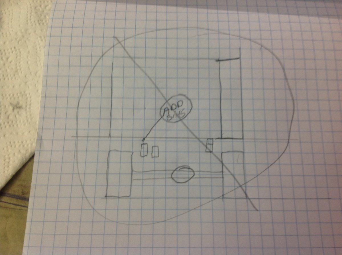

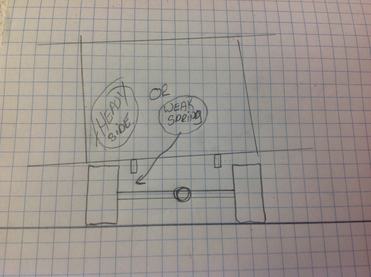

  16. These pics might help, but it's up to you find and to correct the real problem.
    Measure frame to ground - that needs to be accurate
    Adding shims to top of the low side frame rail is not correcting the problem but it fixes the symptom of a list. Shimming one side of the body and realigning the body panels is about 30 times more labor and the problem is still there
  17. If you shim one side's (A) spring the frame will rise on that side, yes.
    As the frame rises the body will pivot on the opposite side's (B) spring, yes.
    On side A, every thing from the rocker to spring B will come up , yes
    One side B. Everything from the spring to the rocker will go down, yes
    That will make the low side come up and the high side go down and reach a livable equilibrium that doesn't look listed.
