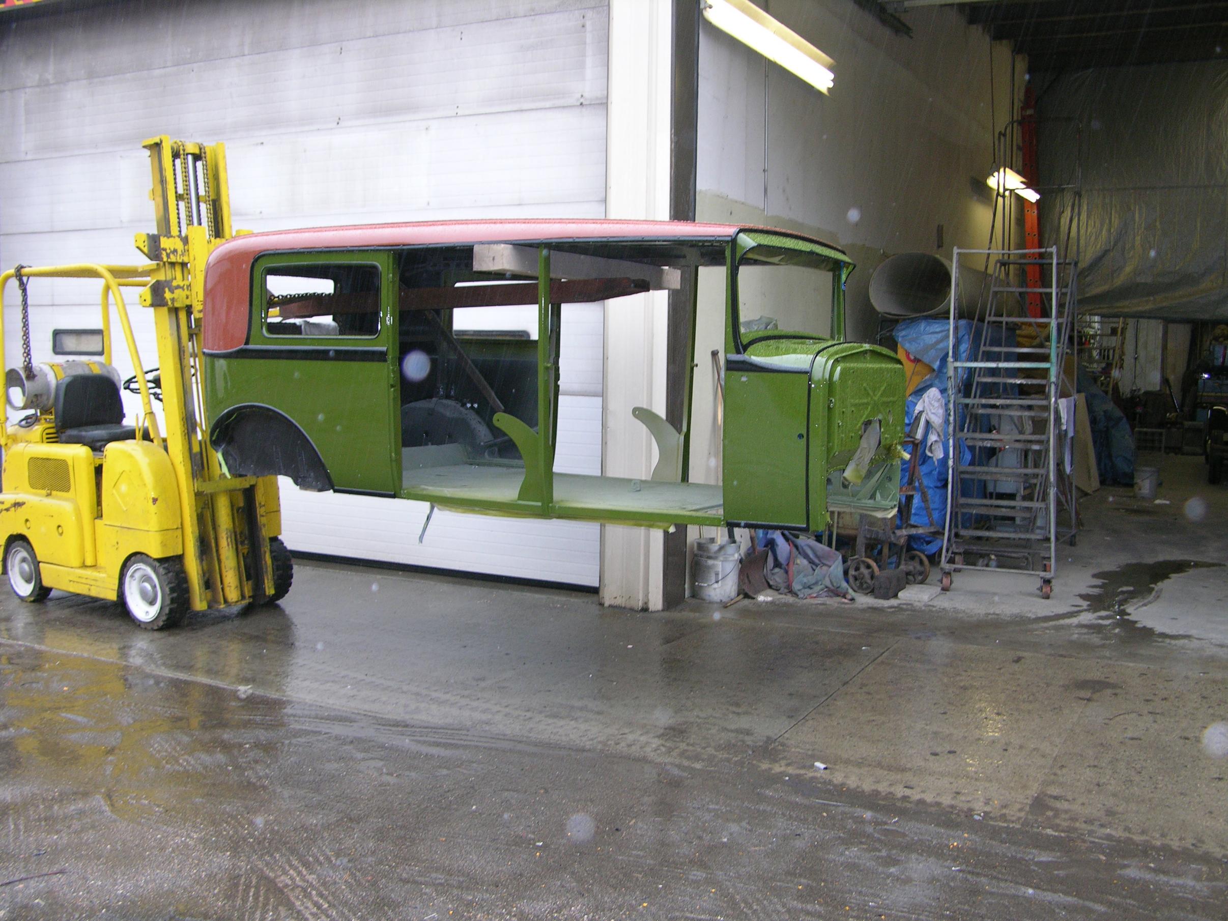

    This wasn't the body off the frame but it was the body and frame off the trailer.

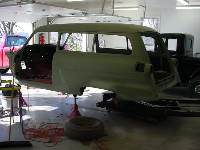

  19. I removed all the front suspension from the frame to rebuild and since I didn't have any extra hands around the day I decided to separate the frame from the body..I used my engine hoist on the front to get 4 x 4's under the car on jack stands and then moved to the rear and did the same thing.
    The car sat like this for almost a year.HRP

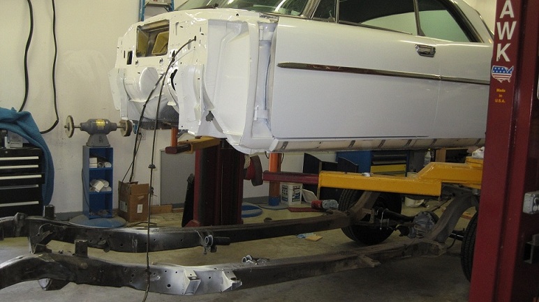

    Or you can cheat and do it the way I did...
