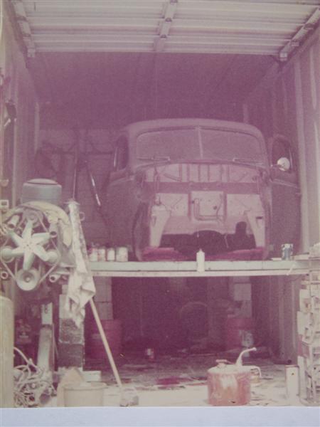

    If it were mine I would cut through the welds with a very thin cutting disc so that the front fenders, grille,hood, etc. could be unbolted a piece at a time. Cover the windshield with cardboard and tape so the sparks won't "burn and scar" the glass. Yes, you would have to reweld it upon assembly, but that's a lot easier than restoring the sheet metal damage that can happen if you try to remove the entire front sheet metal as one unit - even with braces. To raise the body off the frame, unbolt the body to frame bolts, lift each corner of the floorboard up a little at a time and slide in 2x4's or 4x4's until the body clears the frame. Then slide a long 4x4 across the width of the car at the front and rear and support it with concrete blocks. It takes a while. Here's how I did my 40 way back in 1973. Be sure and lay the concrete blocks properly - hollow side facing up. The blue thing is a 4 x 4 piece of hollow square tubing. There are better methods, but this was all I had at the time as there was no one else to help.
