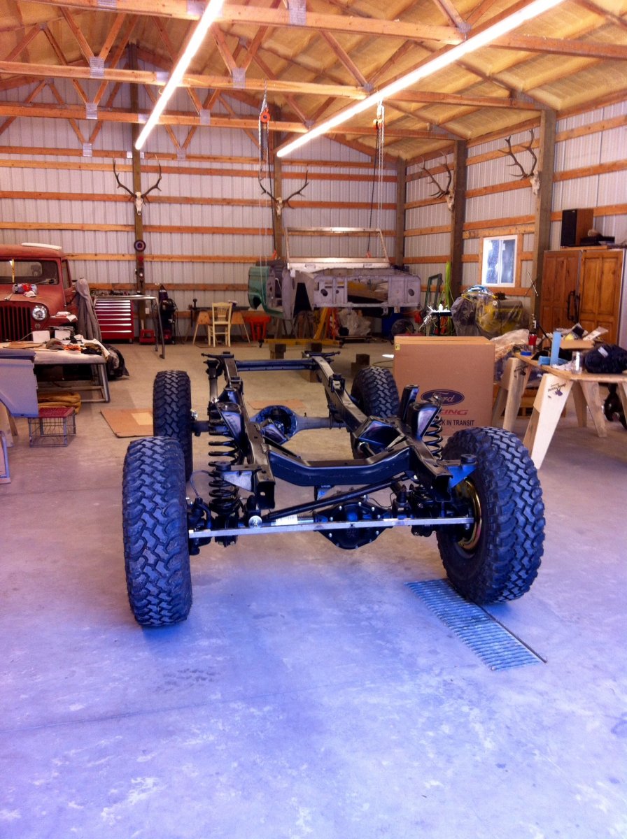

    image.jpeg Bronco is not HAMB friendly, 2 Harbor Frieght chain hoists from rafters works good if you
    got the ceiling height

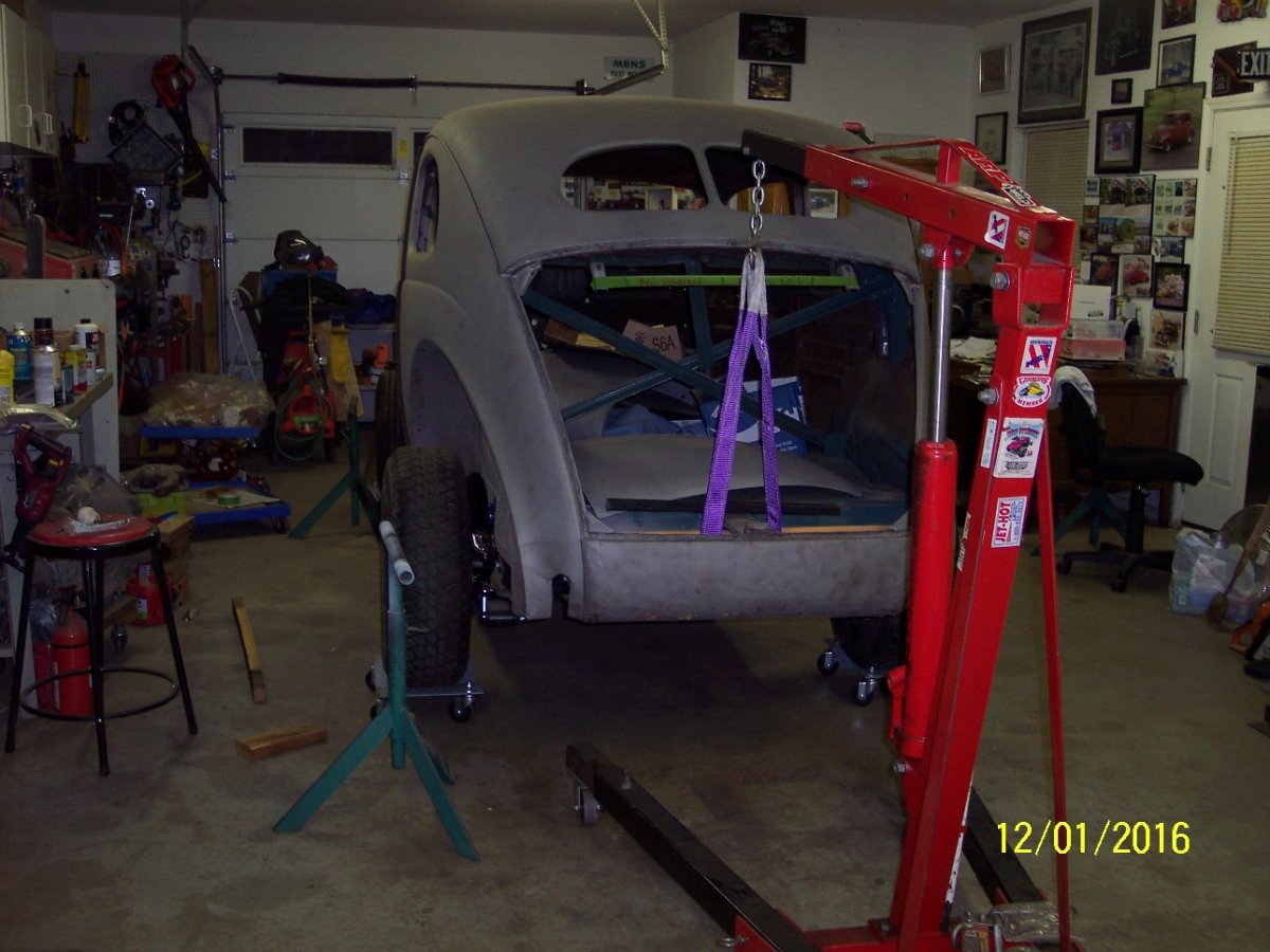

    Here is how I did mine. Shop was a mess but I got it done. Note the lift brace I used across the cowl. 100_9440.JPG 100_9432.JPG 100_9430.JPG
    warbird1 likes this.

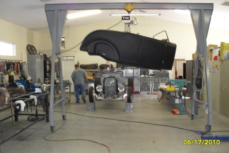

  26. I've done all the above.
    One day I had a few rounds of musical frames and bodies to swap around-So I broke down and bought a gantry crane.
    Easiest body lift adventure ever, super safe and almost a non issue no brainier. It's one of those things that you wonder why you've went so long without.
    Almost bit the big one jockeying a finished 85 c10 cab with an engine hoist, scary day.

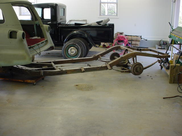

    When I seperated the body/frame on my 66 Suburban (by myself) I used a pair of those cheezy trailer tongue jacks that I made mounting plates for on the front cowl sides as the front sheetmetal had already been removed along with both front and rear suspension and drivetrain.
    I was able to get it close to height by "inching" and "inching" and "inching" it up with floor jacks and using every jackstand and big timbers I had.
    In the rear I built a framework with Heavy Duty wheelbarrow wheels, dropped the bare ch***is down and rolled the body out over it.
    It's been quite a few years so I can't recall every step, but it was a white knuckle affair before it was done. I didn't get photos but I have a vivid memory of the "pucker factor".
