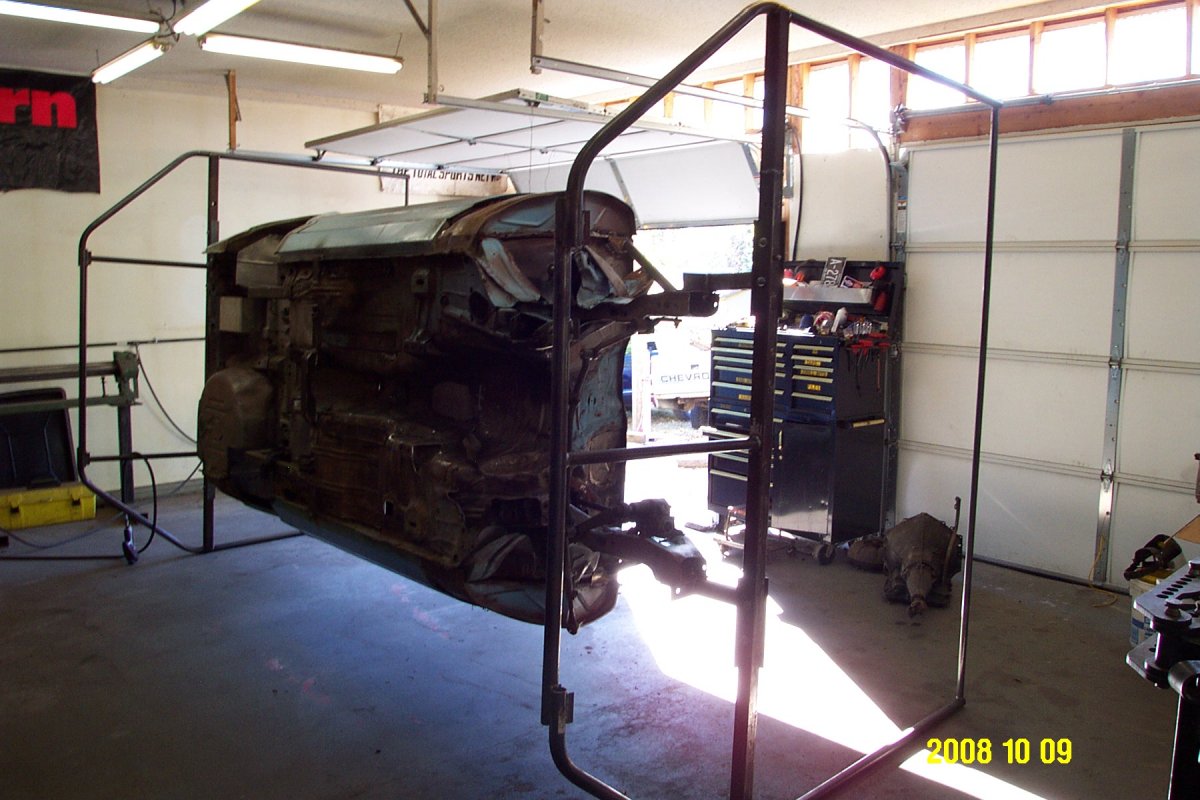

    I made this out of the same mild steel dcp0448.jpg dcp0447.jpg we used for roll bars , it works good ,easily turns a car over with one person.I set it up so I could turn it 45 degrees and it would be stable there also.
    Loose Ctrl likes this.

  13. HotrodHR
    Joined: Jul 12, 2010
    Posts: 211
    HotrodHR
    How about a video or some pics on how you're able to rotate that?

    No video. Just grab one end and rotate it , Vega was body only with windows, no idea of weight . I use this for building trailers also . It sets at a 45 degree very well also .You need a diaganol brace so it doesn't rack to one end . Ceiling height needs to be Considered.Slide across floor and even outside easily. By the way I always mount it with the center at Camshaft height . It could get ugly if you rotated it and the center of gravity was way to high or too low.
