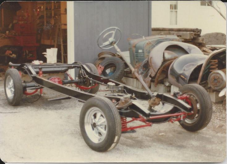

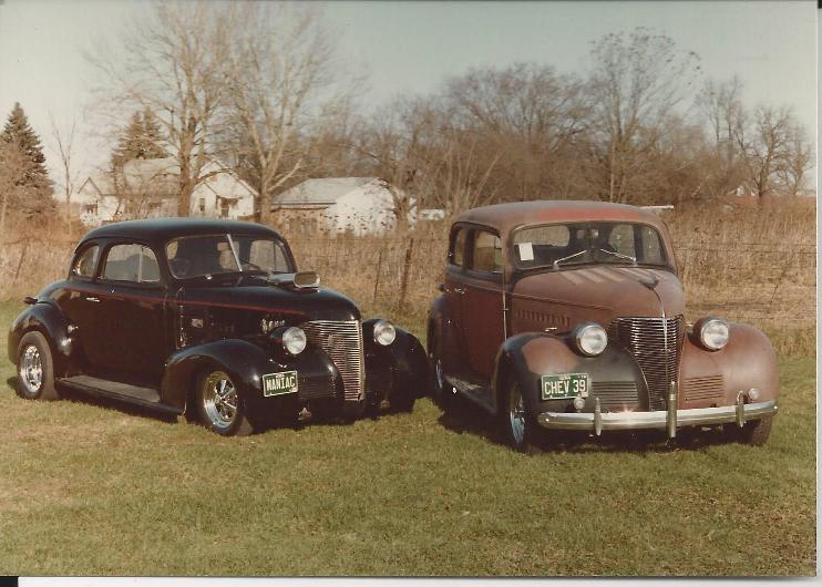

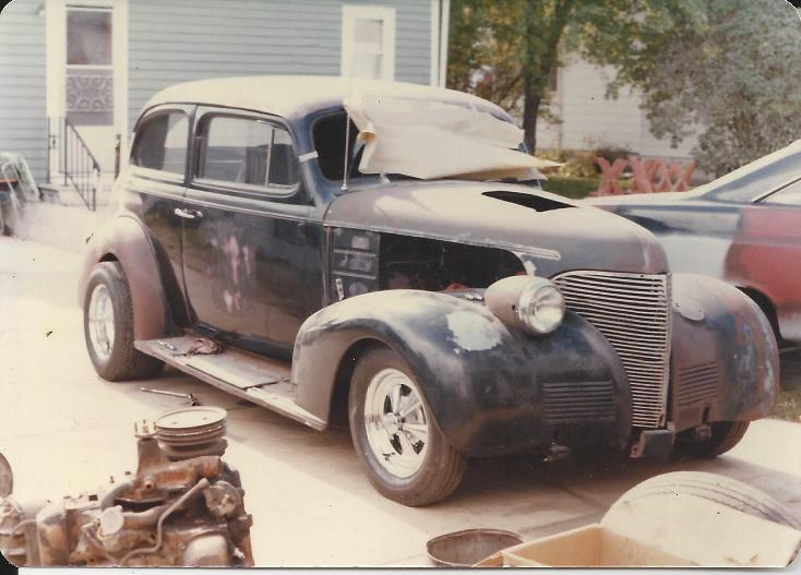

    My 39 Chevy coupe is on my 2 dr sedan's original frame. I was in the middle of redoing the sedan (dropped axle, one piece cut down hood) in 1979 when I found the coupe. Built a different coil spring frame for the sedan then, still have both.
    HOTRODPRIMER and 3W JOHN like this.

    Since you guys love pictures :D
    sedan in progress before coupe was found
    "new" sedan frame
    final result (1980 photo)
