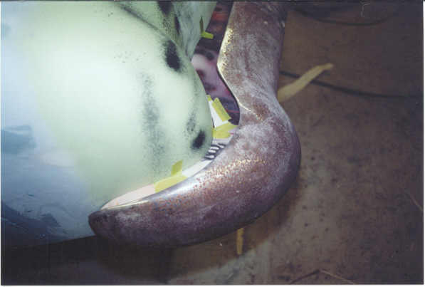

    A bit late for Tech week, but here it goes. I put a 49 Caddy front bumper on the rear end of my 46 Chevy coupe. The Caddy bumper has outward 'bumps' on each end, which figured out well into my design ideas on restyling the Chevy. I had some extra door 'bubbles' that I used to put extensions onto the quarter panels, to visually lengthen the car a bit. Also to add more teardrop shapes to the car's profile.
    So, once the quarter extensions were done, I needed to make a filler panel to go between the body's new contours, and the new bumper. Too much work to try to modify the original pan, so I made one using a hammer form.
    First off, I made an exact pattern out of regular poster board. It is stiff enough to hold a shape, yet flexoble enough to bend into the downward curves at the ends of the bumper.
    (Sorry to do this in multiple posts, but I don't know how to post multi-pics yet!)

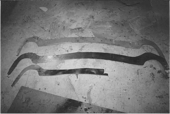

    Here's the start of the cardboard pattern. It must be very precise in both how it fits ot the body, and it's outer edge, also.

    Once the cardboard pattern is finished, transfer the pattern to MDF. I used 3/4" for extra strength. 1/2" would probably be OK, too. I then cut out a piece of 18 ga. steel, making it about 3/8" larger all around, to make the mounting flange, on the body side, and the outer lip, to keep it's shape. You also need anouther piece of wood, either more MDF< or plywood, the same shape as the pattern, to clamp the steel in between.
    Here's the 3 pieces, from top to bottom...MDF pattern, steel sheet, and part of the top pattern.

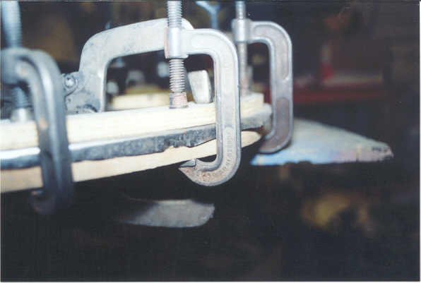

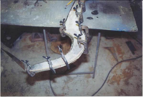

    Clamp the steel in between the 2 patterns. Use as many clamps as you can, or have available. C clamps, vise gripe, bench vise, can all be used to keep the pieces together. You can move them around somewhat as you work, just don't disturb the relationship between the pieces.

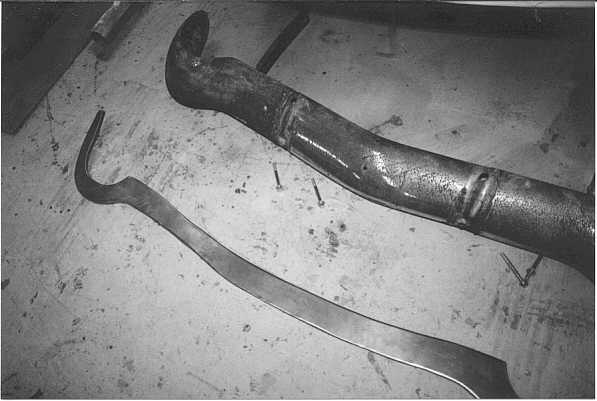

    Next, using a body hammer, hammer the flanges around the entire piece. GO SLOWLY! Use many light hits instead of a few hard ones. Some of the steel is going to be stretched, and some of it is going to be shrunk. It is better to do this slowly, and let the steel slowly take it's shape, instead of forcing it. It may wrinkle, or split, if you force it!
    Here it is hammered into one of the curved sections. As you can see, the flanges are very smooth, despite the change in shape it has gone through. It is amazing what you can do with steel with the right tools, and some knowledge!
    The edges will be marked off, and trimmed evenly when it is all done.
    It may be necessary to use a dolly, piece of pipe, or a chunk of wood, ground into shape, to hammer some parts of the steel into the form, like into tight curves. Use whatever is handy, if you need to.

    When all the hammering is done (about 2-3 hours here, with breaks to rest!), remove the clamps. Carefully pry out the steel form, it may be difficult, if you did it right, as it hugs the form closely!
    Here is the completed splash pan. Almost no additional bodywork is needed. The ends do need to be curved to follow the bumper's shape. I had planned to use a shrinker stretcher to do this, but it proved to be too difficult. I cut out the straight sections, and welded in a curved one for the right shape.

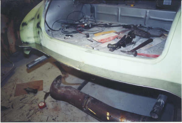

    Here it is mounted to the car. As you can see, I did miscalculate the shape a bit. I had to cut it in the center, and re-weld it back together, as only one side would fit tightly, while the other stayed about 1/2" away from the body. Only one cut, and very little adjustment was needed. I'm not that good yet with these techniques to get them perfect! Practice, Practice!

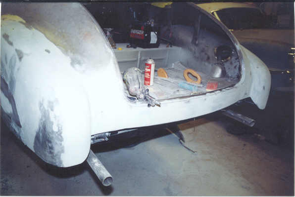

    Here's the only shots I could find in a pinch. The door bubbles are the extensions of the fender into the door...you can barely see them in this pic. Here are the bubbles off the car, and being cut up to splice onto the quarter.

    Desertratrodder, the steel actually shrinks, as you hammer it into shape. This is due to the fact that you are using a hard hammer, and pushing the steel onto a shape (wood) that can absorb some of the shock of hammering. If you hammered steel against steel, it would stretch, instead of shrink. By using a softer backing it allows the steel to take a shape without distorting. Of course, it is very important that you proceed slowly, with light hits. It DOES begin to 'tuck' into wrinkles, but as you hammer gently, it smooths out. Amazing!
