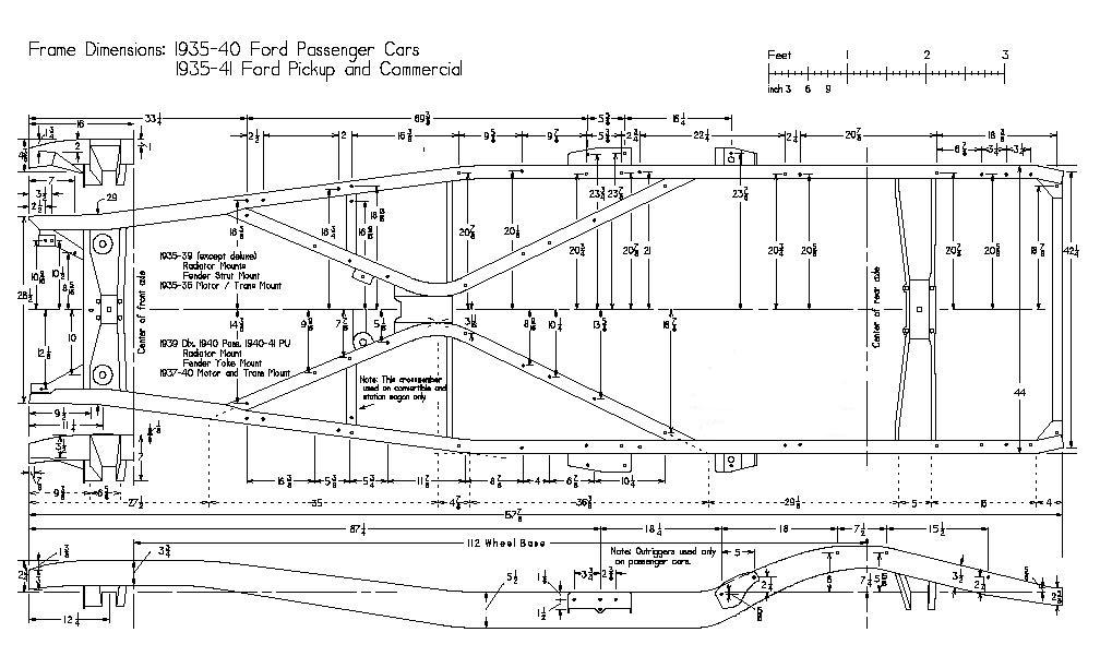

    This is from an old BOB DRAKE Catalog. 1937-40 Ford. Might help.

    That about covers it, I just did my '40 by that same Bolt/pad kit and drawing and I think I had 4 left over

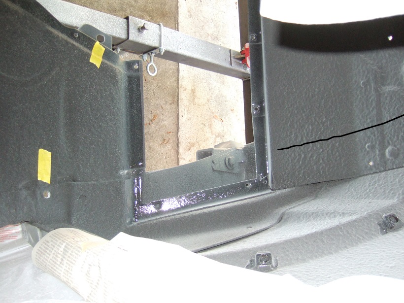

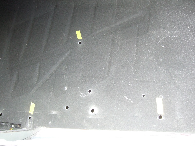

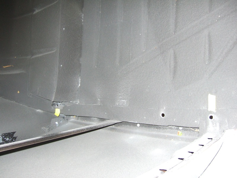

    009.JPG 007.JPG 006.JPG here are several pix of my 40 floor with pieces of tape by the holes that are body mounts.I count 10 per side.

    10/4 on the holes. I have the same marked and going toward the rear I have 2 more on the trunk floor an 2 in the tool tray. Is that a trunk shot in the 5th pic. Thank you

    Yes, there are 2 in the tool tray area; they are where the corner braces from the trunk seal lip fasten to the forward wall of the tool tray. The other 2 in the trunk area are where the channel under the trunk floor is located. There is a "wedge shaped piece" on the underside of the upper lip of the frame where the body bolt goes.
