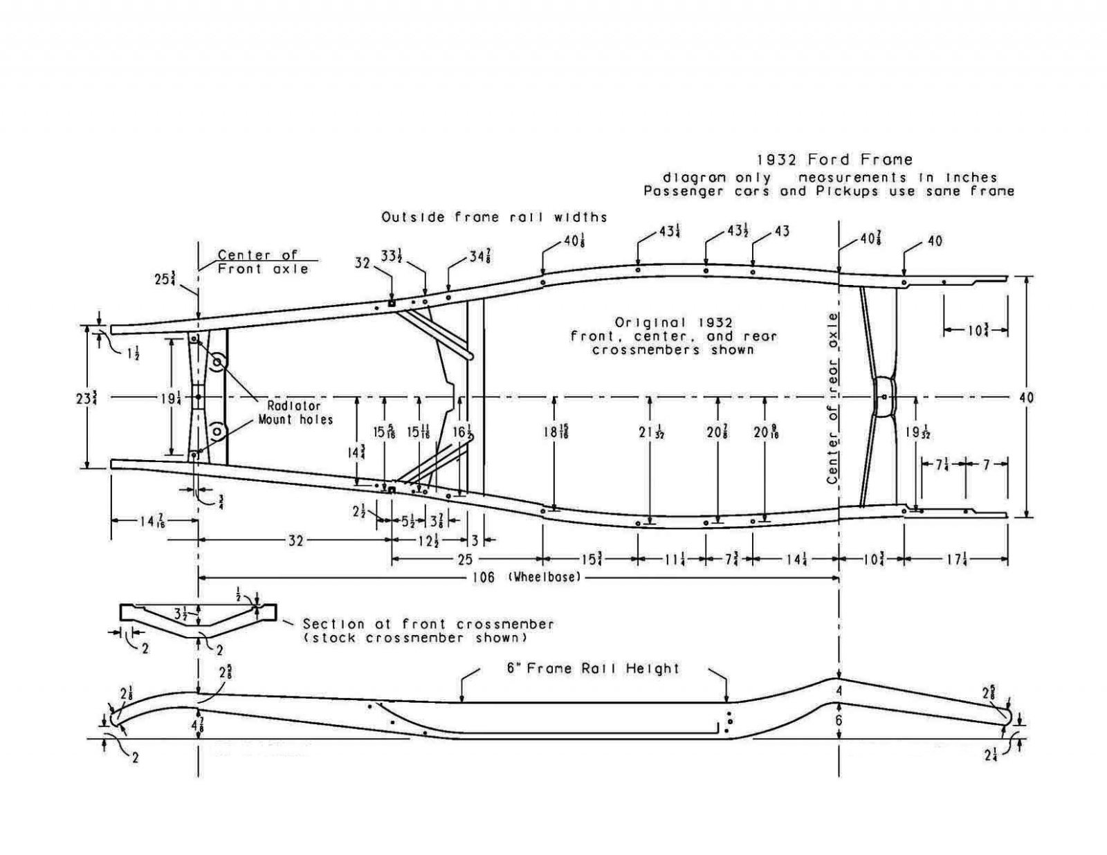

    i would bolt down what you can, fit the rest , gaps etc...A pillar and B pillar are the most important as these two points will determine your door alignment... go from there...enlongating the holes is ok...when its all tightend youll be good to go...Good luck..
  3. Get a diagram and verify measurements.
    The only ch***is I’ve seen that were close were Ford ones. Boxed aftermarket ones usually have width issues.

    Check body holes against frame chart. A trammel bar makes life easier 32-chassis.jpg
    Hnstray and loudbang like this.

    ""Only @ rear body mount"" after all aliment are set , then take a measurement between sub rail and frame gap make a spacer so when you tighten
    ( One on each side ) its solid & to keep alignment.
    The cowl leg & rear body mount set / adjust door gaps, & some times door hinge need tweaking on Roadster
    Frame looks boxed , if me ( more work ) I would cut a bigger round or square hole , (window) replace with a 1/4 - 3/8s thick plate weld flush across top & tap, & also looks to have a tubular K member, You will have to notch @ front sub rail cross brace from left to right to clear K Member .
    After market fire wall feet / legs are no made correct to Originals & obviously the flat firewall .
    There are several Drawings floating around on the web that are not correct to the ""Factory Ford ""blueprint drawing, I have a Original FoMoCo one that I had in large to poster size & laminated.
    If You are going to use hood & stock appearing gas tank , measurements are critical .( radator shell ,firewall & fuel tank recommend to start with mock up) before drilling new holes.
