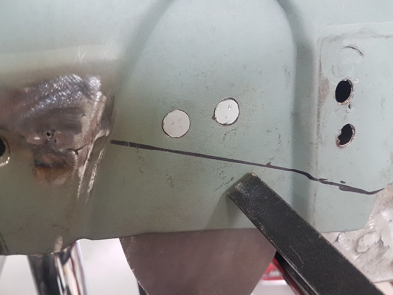

    Hi guys, I'm looking for some wisdom of how to patch these center holes that someone drilled to put in an aftermarket radio. I'm looking to get the dash back to stock. I'd appreciate any ideas. Thanks.[​IMG]

    Honestly I think I would just weld the drilled holes shut. A few tacks on each side and let them cool off, then a few more, ect until the holes are filled. Grind it down and you're done. Making little tiny patch panels seems like wasted effort and making them bigger to fit a bigger panel sounds like a h***le.

    Patch panels are a h***le but it comes out nicer than building up weld blobs and grinding them down. More heat more distortion !

    Patch panel was my first thought but the holes are in the ****on surrounds so I'll have to try to match the ****on surround angles and don't really know how I'm gonna do that.

    Just cut a circle to fit the hole tack it on the flat part and then from the back use a hammer and dollie to work the metal up into the same shape as the ****on surround and finish welding.

    Get a aftermarket radio with large knobs. No really, cut some plugs and TIG weld them. Another thing you can do, is to cut a plug and solder the plug in. I saw this done with filling holes from a roof rack on a roof. You have to make sure of the lead content of the solder.

    I have been successful in cutting out little circles on a band saw for holes in my firewall and then welding them in. I use a magnet to hold them in place for the fist few tacks. I like that better than trying to fill the hole with weld. It makes it easier to grind clean.

    I agree with welding in a patch and grinding down. A tiny smear of filler and paint it will look good. you could even use a washer or 2 for the patches. Use a piece of sheet copper behind the hole when welding helps bridge the gap and the weld will not stick to the copper.

    Actually I do it the opposite. I take a square file and make round holes square then use a square patch when I fill holes. I usually find a strip (drop off of my shear) the right width, tack one side while just holding the strip, then cut the 4th side to size with a cut off wheel, hammer and dolly it in then weld it up. Really fast at patching holes that way, much quicker then trying to make a bunch of little round patch panels, especially if the holes are 1/2" or smaller.

    I'm gonna do what Dino 64 says square patch and grind to fit. I'll post pics when done to get some feedback. Thanks gents .[emoji1303]

    I fill holes like that by using a br*** drift that I bought years ago in a garage sale. It is about inch and a half in diameter and a foot long. I hold it flush to the finished side and weld to the back side. The drift does several things;
    1. The br*** wont take the weld so when you take it away it leaves a nice finish that takes one p*** with a 2 inch wheel to prep.
    2. It gives you something to weld against so it easy to close the hole.
    3. It also dissipates a little heat (wear a glove)
    I use this technique of floors, firewalls and anywhere else that idiots (like me) drill holes that they later realize are in the wrong place. :Do_O

    Roughed out a couple circles with tin snips (cut square then sliced the corners off at 45 degrees) then rounded them up with the linisher. Only took a couple minutes to get a nice fit.
