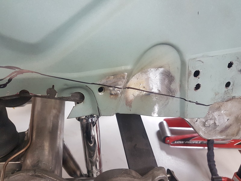

    It's coming along but I still haven't plugged those 1/2 inch holes! Tomorrow I'll scuff up some of those areas, use a dab of bondo. I sure wish I could just get those cut, but I don't have a precise way to cut them [emoji849].[​IMG]

    You can definitely cut 18 ga with snips. What size are the holes?

    skinny pedal
    They're 1/2 inch holes but they're cut into the ****on surround.

    Can you get to the back?
  16. skinny pedal
    Joined: Dec 23, 2016
    Posts: 90
    skinny pedal

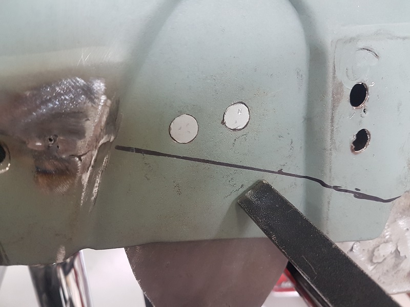

    Yes but not very well, I'd like to cut some patch pieces out of new stock and weld them in like I did above and below the display of the radio, but I don't know how. I guess I could use a hole saw then try to fill in the pilot hole but that seems like patching a patch

    I can send you a couple slugs, then you'd have to tack them to the flat section of the dash, then tap them up from the backside to match the ****on surround, then you can finish welding and grind.

    Its real easy, I'll just pop a couple slugs out with the punch. You'll have to flatten them, but not a big deal. If you still don't want to accept, and even if you do, I would suggest buying a set of wiss snips. They come in quite handy.
