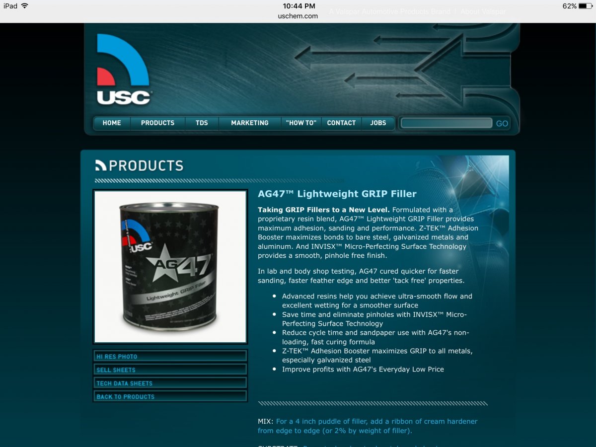

  25. 1st see if your blaster can shoot epoxy primer on it. That's 1 problem out of the way.
    Second, remember everyone is different - but this is probably the best filler I've found that works well with my abilities and the way I think.
    USC AG47 - specifically.
    I like it better than rage products which are excellent. It's more for light irregularities and final coats.
    Mixing is important.
    If you're a coffe drinker you know exactly how to add and mix yours.
    After years of mixing mud you know exaclty how much. It's directed by weight so without a scale or years of experience you're destined to get it wrong. Get a small ounce scale and get your eye used to it.
    Mixing mud is not stirring, it's folding.
