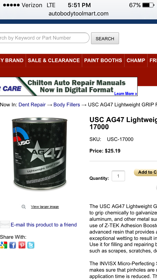

    If possible get ahold of the body filler. All of you will be glad you did!
  14. K13
    Joined: May 29, 2006
    Posts: 9,677
    K13
    This is the same as Ultra which is what Larry has. The Edge label is not available in Canada.
