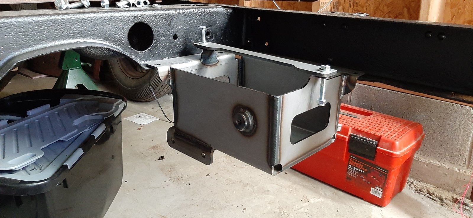

    I mentioned this in someone's banger thread, and didn't want to derail it by posting photos.
    I'm swapping for juice brakes and splurged on the BB battery box/ master cylinder rig.
    It's super well built, i have no complaints.
    I wish i could have found some photos of it in a car, beforehand though.
    I ***umed it would mount to the top of the rail, but it's designed to hang below.
    It makes sense, with the floorboards and everything, but i didn't expect to see the whole thing from the side.
    Possibly, i can get aprons, or maybe it won't be such a big deal when the drivetrain is in.
    I have it wedged in for these pics, it's actually supposed to be mounted underneath.
    If you have one, post a photo of your car, so i can see how it looks.

    It won't be lower than the oil pan, or the bottom of the transmission.

    I don't really have anything to complain about, but on a low car it might be something to consider. The m/c is lower still.
    It'll be awhile before the motor and gearbox is in, it wouldn't **** to know how it's going to look before i get that far.

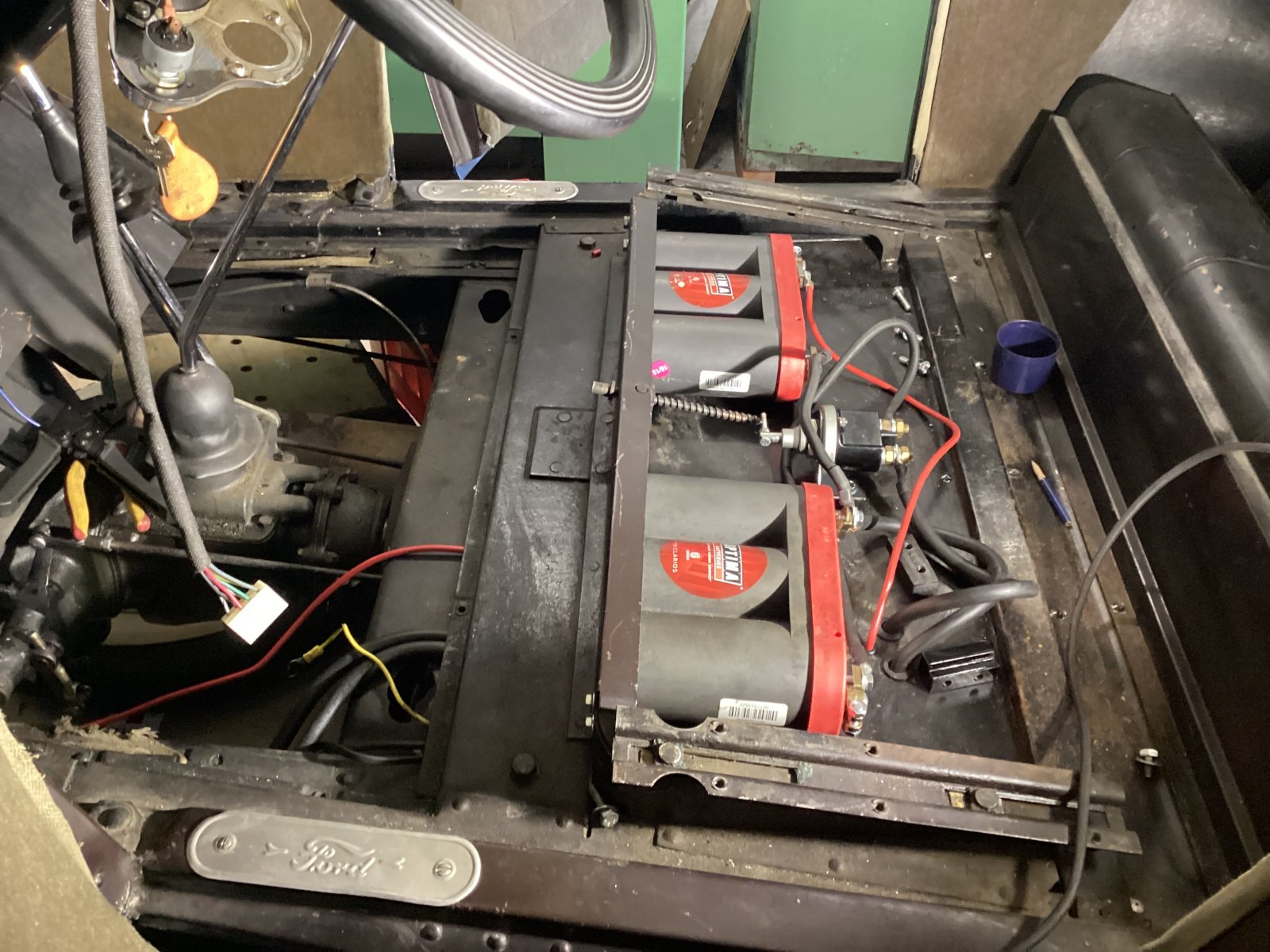

    2 x 6 volt batteries in series to give me 12 volts, in my coupe, the floor has been replaced at some time, with a flat panel, so clearance is a bit tight, with an original seat. A bit of a mess at the moment, not finished yet

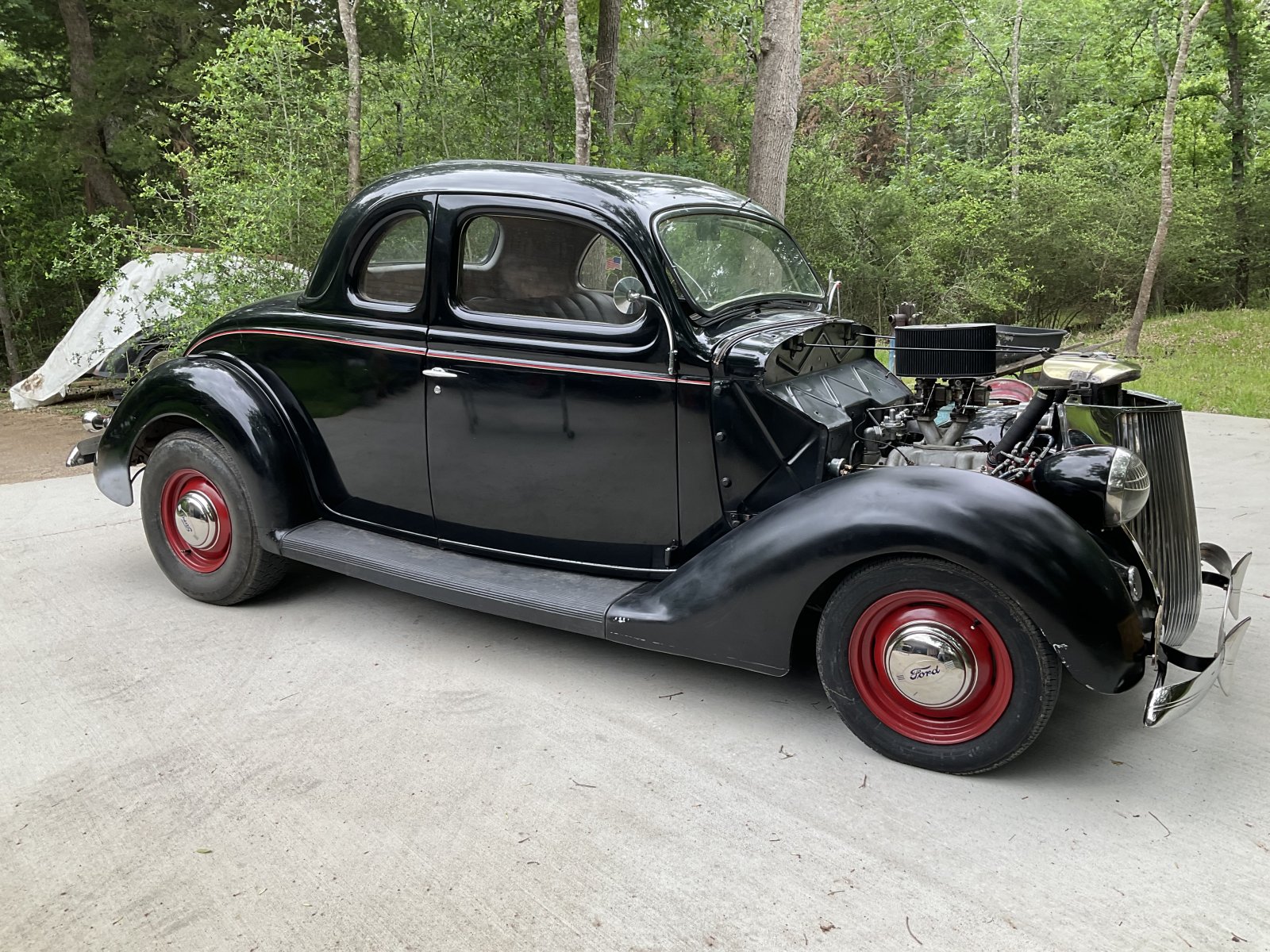

    Speaking of smaller batteries/was employed by Harley Davidson for 18 years. Always had hot flathead ford v8 hot rods. One day a customer brought in his full dresser and wanted a new battery(old batt was 3 years old, functioned properly, but he was afraid of being stranded) He purchased a new battery and I “took” the used battery home hoping it would function I’m my 39 ford truck(flathead). The used battery spun the strong stroker flathead like a Chevy with the plugs pulled out(spun rapidly). Have used Harley dresser(some call them baggers) batteries in several hot rod Ford and always had good cranking ability. Flatheads Forever!! F69D5B77-B397-452E-8842-EC677BFB39F4.jpeg 00CADC06-188A-470C-B31F-126C24FE42EE.jpeg A4D68948-004E-4DA0-833F-4902F891CF35.jpeg CAAEED8E-30F1-4BE6-B267-ED48830DE29E.jpeg

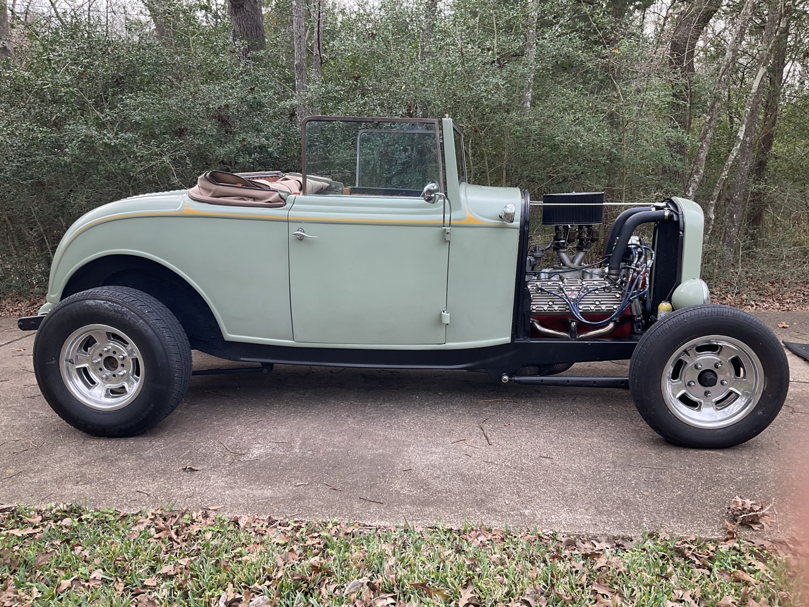

    My 32 roadster has the battery mounted under the bottom seat cushion on the p***enger side. I have a 2 inch fabricated metal seat riser with a fabricated battery box and we made the box deep enough so the top of the posts just cleared the wooden seat bottom. I did the same thing with my deuce sedan delivery, mounted the battery under the stock 32 p***enger seat which hinged at the front and flipped forward.
