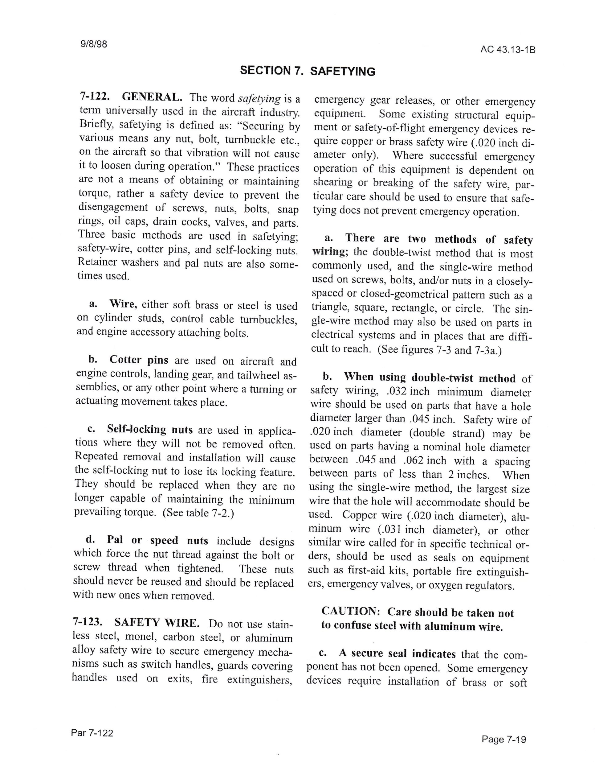

    I thought lockwires were to prevent bolts from becoming loose and/or winding completely out due to vibration, but are not relied upon to maintain the correct torque setting of the bolt. The main objective is to keep bolts in place to prevent seperation of parts and so the bolts don't become "foreign object debris" in the machinery ***embly. Everything I have been taught or have read says that lockwires are not there to maintain the applied torque specifications of the bolt.
    Am I wrong? Please shed some light if I am incorrect. Always good to learn new things.:)

    It may just be semantics, but if the bolt is properly torqued and then safetied with, lets say .040 or heavier stainless, which is properly wrapped and tightened like a piano string that bolt is not going to move any. If the bolt doesn't move you're not going to lose any clamping force on the part. You'd be surprised how much torque it takes to break the larger diameter safety wire.
    This is from a guy that's done a lot of safety wiring over the years...

    My take is that the FAA is high on safety wire not because it maintains bolt load, but because it provide a quick visual warning that something is awry.
    Bolts hold components together by preload induced stretch and fastener friction.
    Safety wires are window dressing.

    And you are correct, I had to dig out my old FAA AC 43.13-1B and find the following... Dang it, I hate when that happens.;)
    But, safety wire is still one of the best ways to ensure that the fastener doesn't move and lose the torque setting...:)

    twenty8
    I agree... ;)
    And I agree... :)
