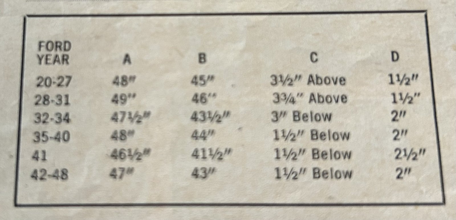

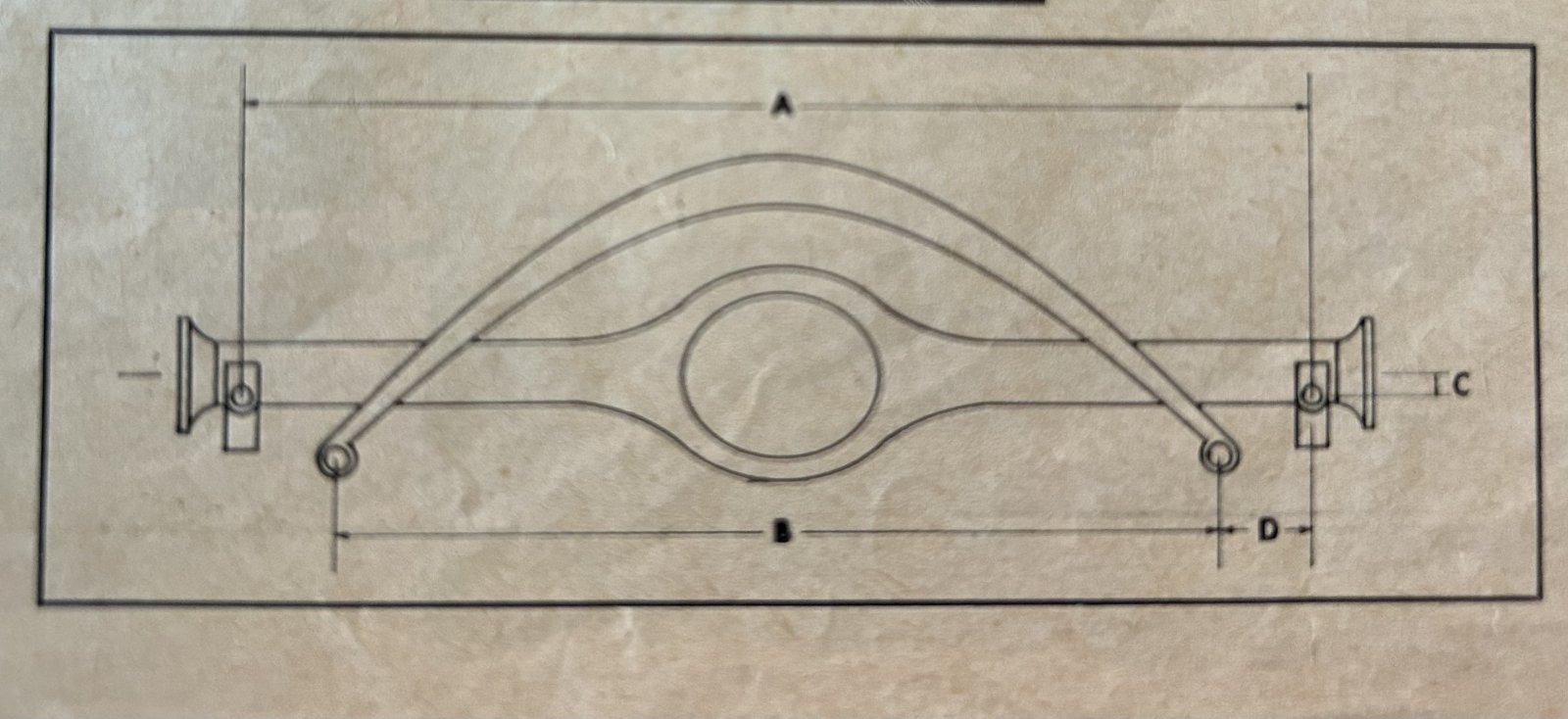

  8. Andy
    Joined: Nov 17, 2002
    Posts: 5,399
    Andy
    sko_ford and Speccie like this.

    Thanks for the chart Andy. I’m going to go over to where the 8” currently resides and put a tape on it so that I KNOW what I’m dealing with and not just guessing (guessing rarely ends well, at least for me LoL).

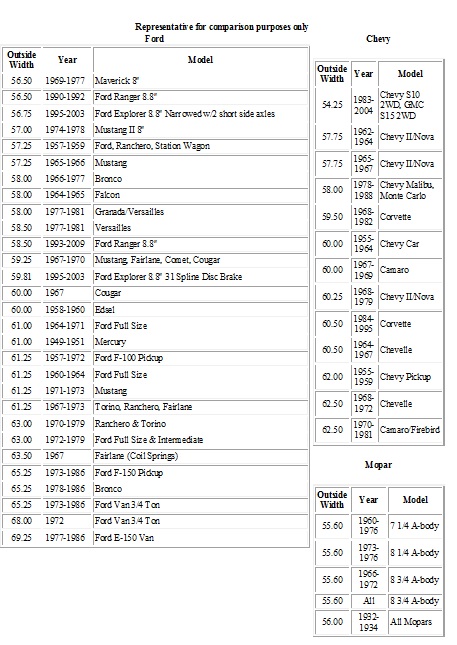

    I measured my Maverick rear end. It is 49.5 in backing plate to backing plate. It is the narrowest of the bunch.
    Here is another chart from the HAMB
    56.5 minus 49.5 is 7" The 10 in drums ***ys are 3.5 in in width?

    Andy, mine is also a Maverick a when I measured it yesterday I came up with the same thing. This is only a guesstimate but I think the max spacing between perches would be about 45” allowing for brake bleeding and the space required by the perch itself.

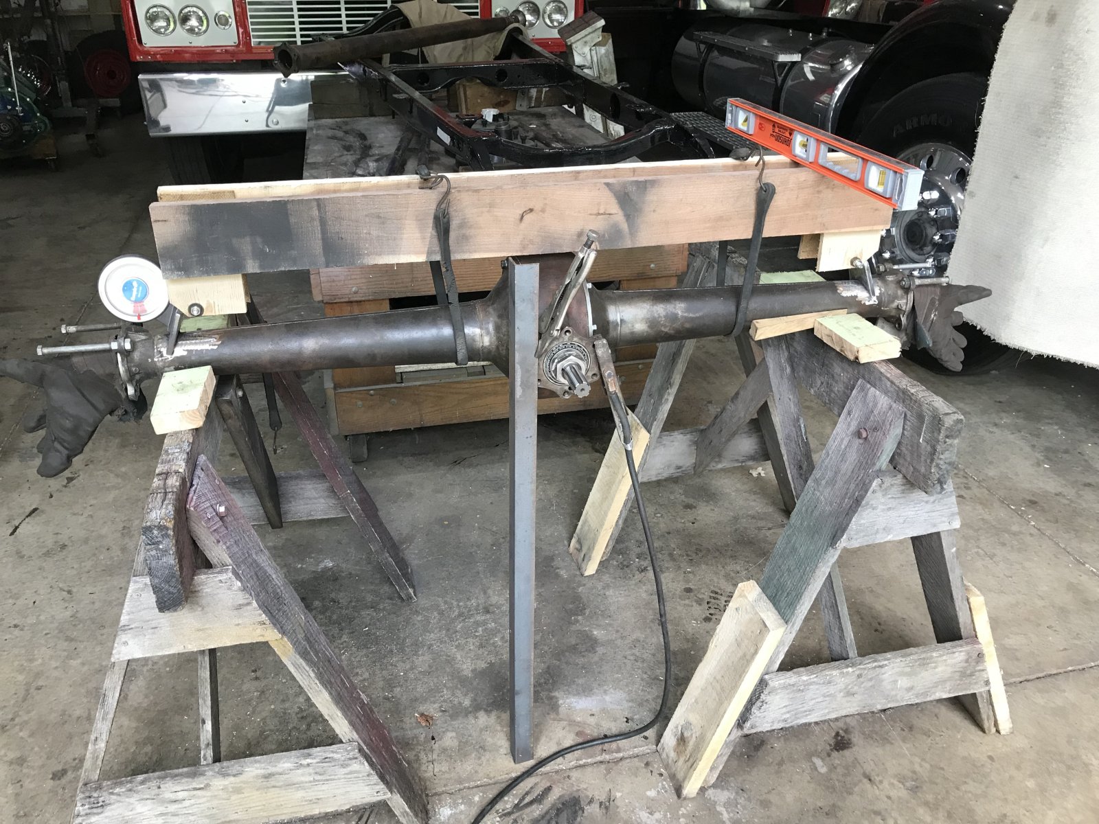

  20. D2Denny
    Joined: Jan 17, 2012
    Posts: 88
    D2Denny
    Made my own out of 7/16 plate and tubing. Welded them on today using a jig I made up to get the correct angle and spacing. Am using the Speedway 38" medium arch rear spring. Instructions that came with the spring said to mount the spring hangers with the eyes 45" apart. Spring was fairly reasonable at $136.00
    Andy likes this.
