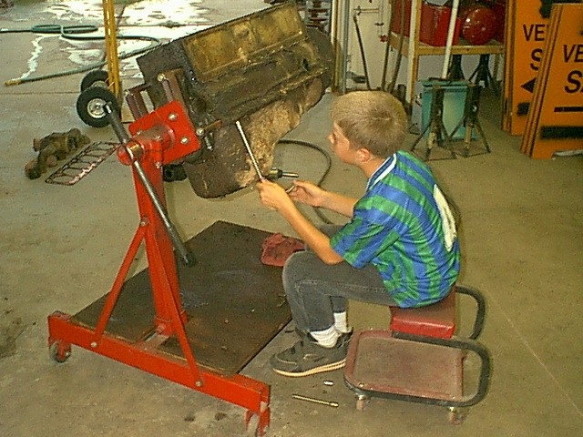

  30. [​IMG]
    I've got a heavy duty 4 wheel stand (not HF) holding my 261. Still worried me with the stability so I used the side motor mounts to run long threaded rod inside square stock down to a cross member. It's just for storage so don't need to rotate it.
