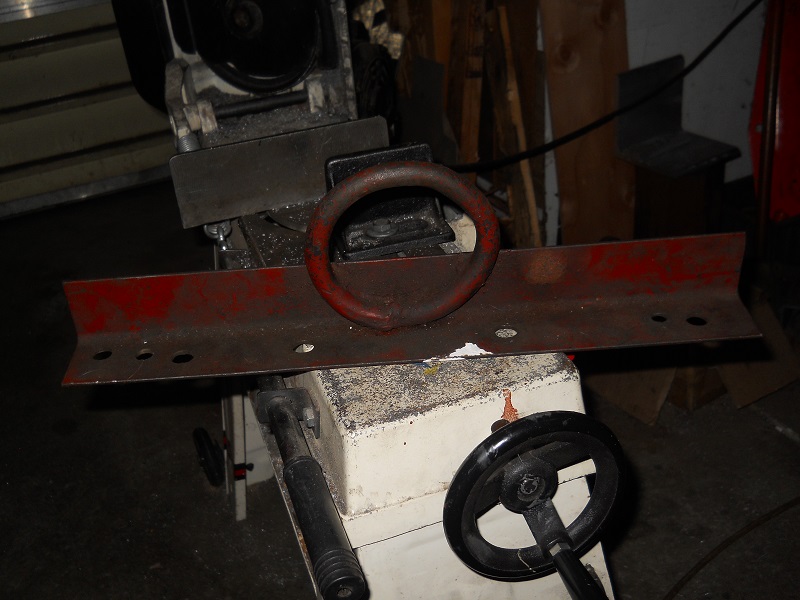

    You guys are going to hate this. But many years ago when I bought my first GMC, the wrecking yard gave me their lift tool that they used on GMC and Chevy six engines. It has holes that the rocker cover bolts go through. Didn't even remove the rocker cover. Worked well enough that I made my own, And I still have it. Piece of angle iron and a coil spring. I also drilled mine to pick up the head bolt holes if the head was off. And I have drilled it for other engines through the years. So I know it's scary. And nobody would use such a thing. But it has pulled plenty of Jimmies with out dropping one yet. DSCN0003.JPG

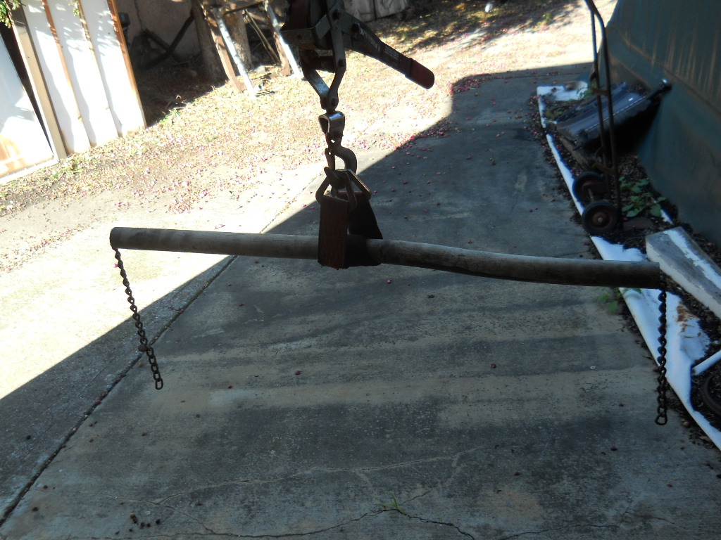

    DSCN0004.JPG DSCN0005.JPG As long as I am doing this I thought I would post a couple of no welding lifting things I used. The angle iron again with big holes to put the chain through and slots the chain slides into and stays put. Bolts to any head bolts. The pipe with the chain and strap is for Chrysler Hemis. Allows engine to be lifted with valve covers, distributor, and intake on. End of chain goes to water cross over front head and block off on rear of the other head. Pretty nice.

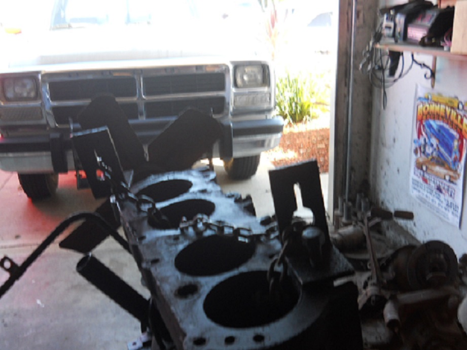

    I have used a H.F. engine stand for 10 years with every kind of engine on it. Just take a piece of 2x 1/4 flat bar . Install it at a 45 degree angle from the bottom piece to the upright and it will hold a concrete filled big block Chevy. I just did a 390 FE no sweat. Just use good bolts and washers. I have sets for Ford Gm and LS motors that I bought from Fastenal. Keep them wrapped together in my toolbox so I don't have to hunt bolts for the stand. I welded the strap on my stand ,but you could drill and bolt if you don't have a welder. This is my other stand without the diagonal holding an FE. 2015-01-12 18.16.02.jpg
