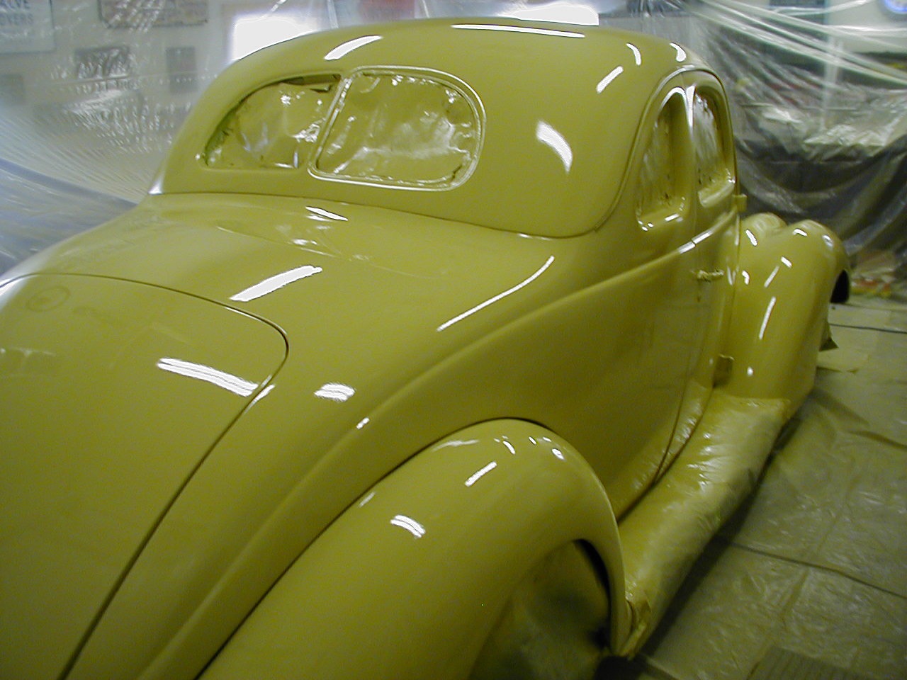

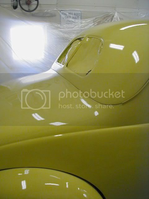

    06799EA3-537C-4194-AA75-921B3811BD30.jpeg B0682B91-EED5-4D94-8541-A453EE90B56E.jpeg I had area with original leading where the back window meets the trunk in my 37 coupe.
    I just roughed it up a bit and laid the filler right over it.
    It’s been holding up with no cracks or issues for 15 yrs now.
