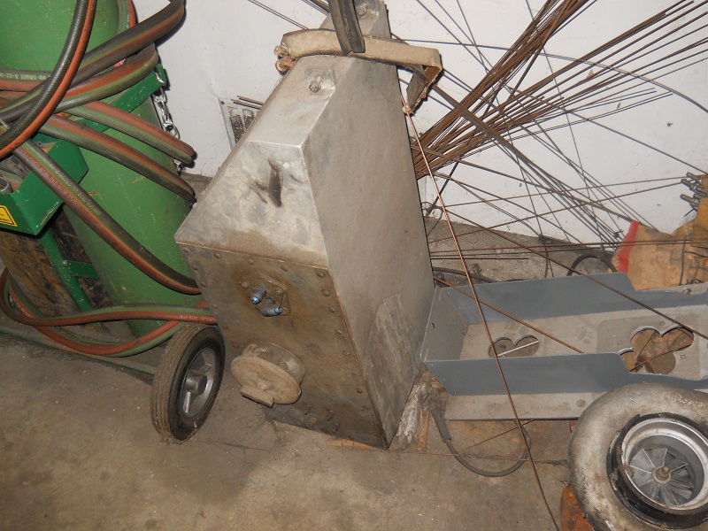

  17. RichFox
    Joined: Dec 3, 2006
    Posts: 10,020
    RichFox
    When Al Holoway built my car, he had an intercooled turbo SBC . He used an ice water tank with the exchanger inside it, He had a similar tank for the trans cooler. I didn't need that stuff and may still have it around here.

  22. RichFox
    Joined: Dec 3, 2006
    Posts: 10,020
    RichFox
    This is the trans cooler. The intercooler seems to be history.
  23. patzfab
    Joined: Dec 30, 2008
    Posts: 157
    patzfab
    from Canada
    What are the approximate dimensions? It looks OK. I guess they’re the ****** line fittings in the bottom.

  28. RichFox
    Joined: Dec 3, 2006
    Posts: 10,020
    RichFox
    Tank is 23 long. 9 1/4 wide and 11 tall.
  29. patzfab
    Posts: 157
    patzfab
    from Canada
    Thank you Rich, we can most likely use it. How much would you like for it.
