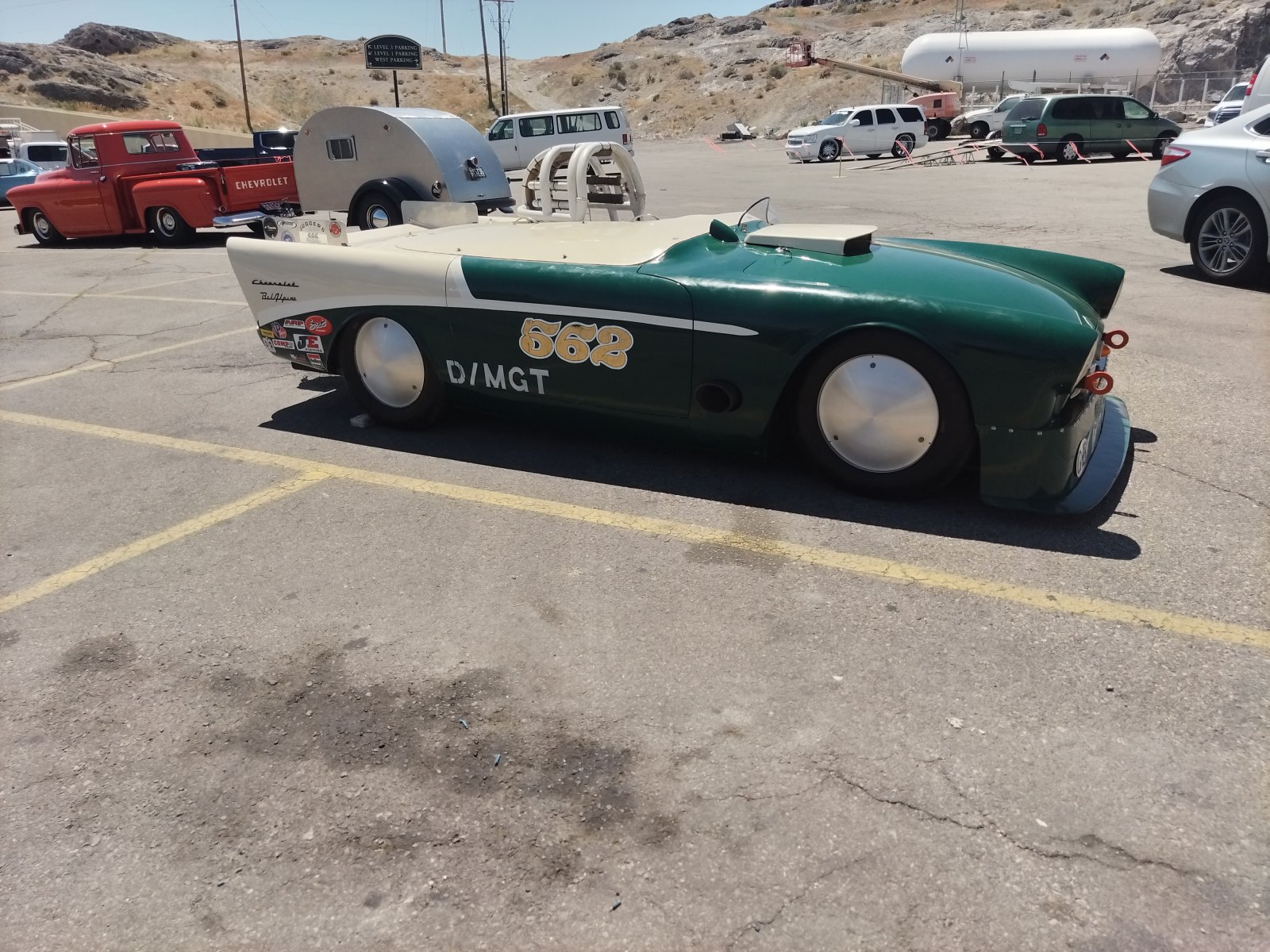

  9. Hollywood-East
    Joined: Mar 13, 2008
    Posts: 2,172
    Hollywood-East
    Stan Back and Stogy like this.
  10. Stogy
    Joined: Feb 10, 2007
    Posts: 27,235
    Stogy
    I guess its actually stock body the paint makes the 56 eyetwist...or is it...kinda looks like real 56 tailights...
