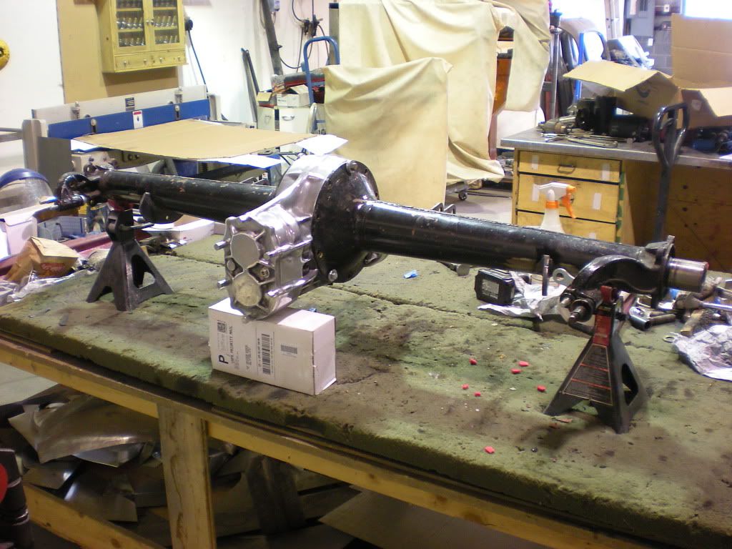

    So yesturday was christmas for me!! I bough my rodsville quickchange. Im super excited cause its already got all the machine work done on the pinion and it came with a set of gears!

    Those are really nice rears. I believe Bass is a proponent of Rodsville quickies. He supposed to be using one in the '29 he was building although I am not sure if it ended up under the car. They just look the part and I bet the machining tolerances is far superior to a Culver City. Looks great dude, are you thinking polished ot natural? I like natural with super shiny black bell housings.

    Ya the rodsville quick change has a lot of improvements over the originals. It has the huge pinion brace. Its made out of better aluminum. And just the fact that every machined surface is new is a major plus.
    Im thinking of having it kind of semi polished. Make it look like at one time it was polished but over time its got dull.

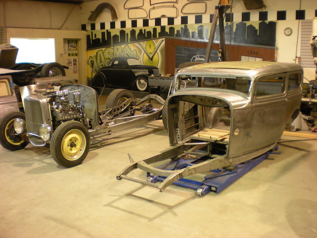

    I got the car taken apart today. I plan on staring with the rear end and get it ready to put in the quick change.

    I would have to believe that we are now seeing the new blueprint car for chopped fenderless 32 Ford tudors.
    Every time I look at the photos I see more to like. I'm sure that from now on guys will be looking at photos of that car to see just how it's done to get it right.
    And folks, the man has it right. You build the car, take it out "one" time to let people see it in the bare metal and then take it back to the shop and blow it apart and finish it the way it should be finished. No future discussions on WD-40 and Scotchbrite pads on this one.

    Just a quick update. I wanted the quick change to look a lot older rather than a brand new casting. So I polished it up, but left a lot of the pits there so that they would go darker. I like how it looks cause now it fits the housings in patina.

    Just say it, you gave up on polishing the rest of it because polishing sucks!!! Hahaha!!! Just kidding it looks great!
