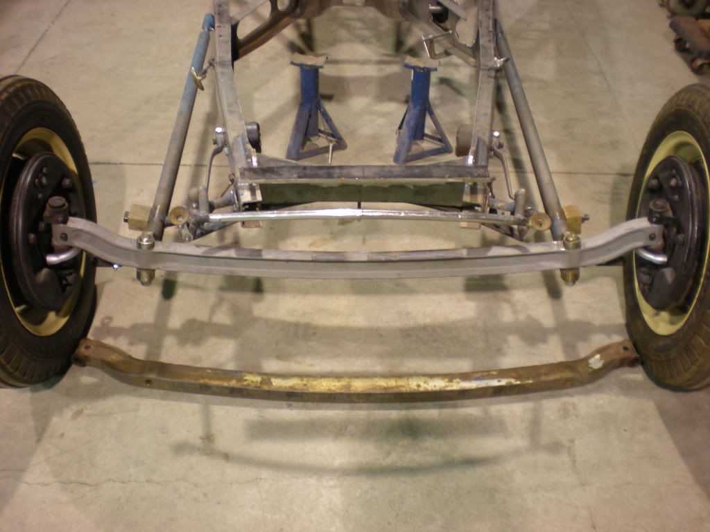

    The other day I got lead onto an old make shift trailor that had a super nice 32' heavy axle under it. I got the whole thing for 100$. So I replaced the 32' axle that was on my car with this new one.
    Also got the body off for hopefully the last time. Now its just finishing up the ch***is, painting all the pieces, and doing the final ***embly.

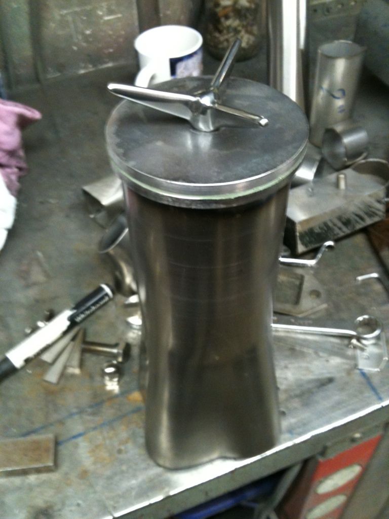

    Tha'ts the plan! I think having both options of either through the mufflers or out the straight pipes will be nice. Now I just have to figure out a neat end cap for the straight pipes that can easily be removed. I don't want to weld on a flange with a bolted on plate. I'm wanting something that screws into the end. Any ideas guys?
  27. langy
    Joined: Apr 27, 2006
    Posts: 5,730
    langy
    Maybe something like this ??? looking excellent by the way.
  28. Salt Flats Speed Shop
    Joined: Sep 30, 2007
    Posts: 1,474
    from Utah
    I like that! Ya something like that. You make that? Internally how does it come off?
