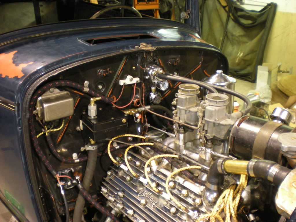

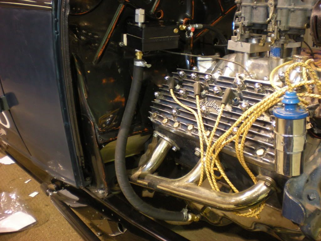

    Jolly nice build,SFSS!! Been following it from the start. The return tube to the oil pan for the oil purifier system( a kool piece of kit!!) is a bit of a distraction for me! Couldn't you replace it with a cloth-covered tube like on the inlet side?:confused:

    Ya, i'm going to try and figure out a good cloth line that I can replace that with. But for the mean time I'm just planning on opening the drivers side hood when I show people the engine. The passenger hood top doesn't hinge as far over as the drivers side does anyway. So it wants to fall back closed.

    A piece of asphalt loom would cover that hose nicely?

  24. Looks great, but you should build a cover for your oil/water separating device that mimics the cover of a voltage regulator, or perhaps something that mimics the oil filter housings often used on Flatheads.
    Would help to hide the out-of-place "modern-ness" of the separator.

    Very close to perfect - the only thing that sticks out is the rubber oil return line running so close to those hot headers. hmmm, burning hot headers, rubber oil line - that could never go wrong........... or could it??????
    Please don't risk it - change it or wrap it or something to make sure that Murphy doesn't spoil your day.

    I've still got plenty bugs to work out on the car. The brakes are giving me trouble getting all the air out. Not sure if its a bad master cylinder or just air trapped somewhere. And i'm needing to get one of those powergen's for the car. Cause I need that electric fan to run at full power to make sure to cool the engine. I'll be putting some of the high heat wrap on that oil hose to make sure it doesn't melt as well, thanks for the suggestion. As for the oil refiner, I plan on keeping it like it is mainly for my uncle's benefit. Cause its a good conversation starter, and I want to help him out as much as I can. Plus for the most part I will open the hood on the drivers side anyways, and you can't really see it from that side.
