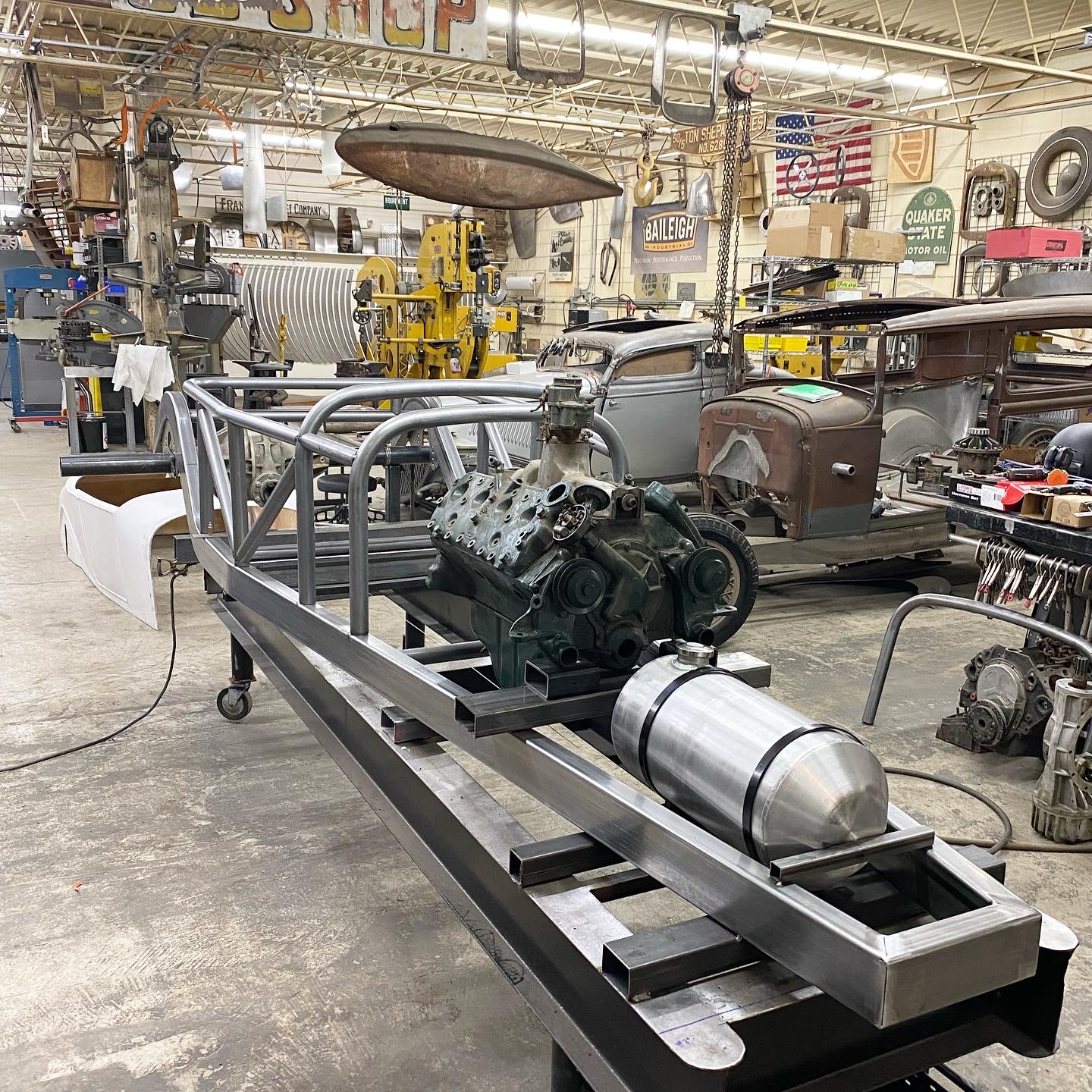

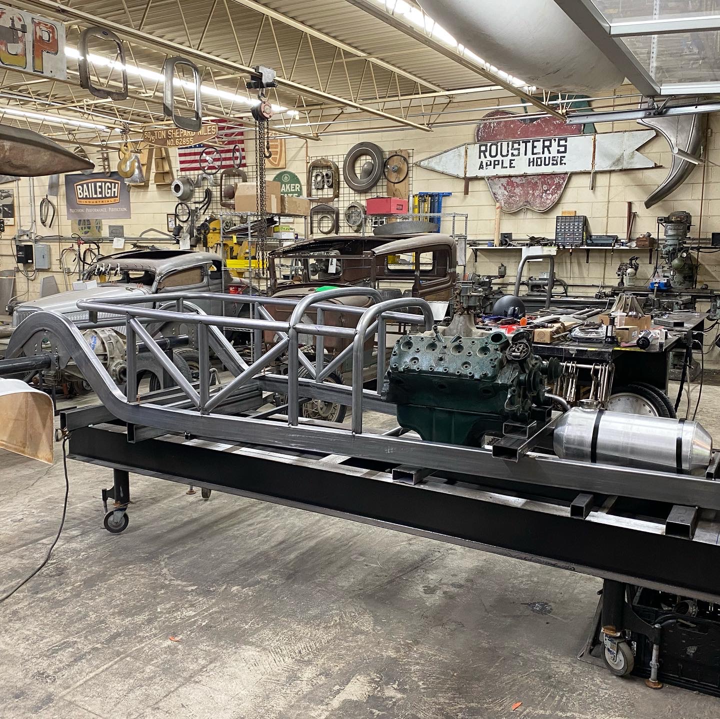

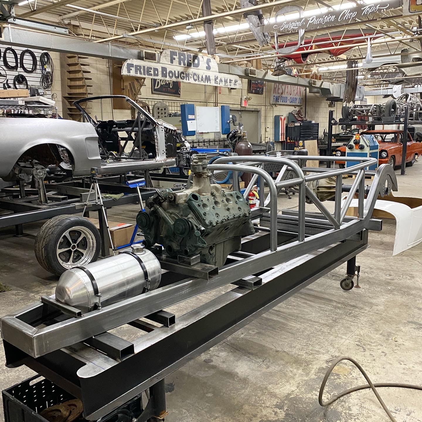

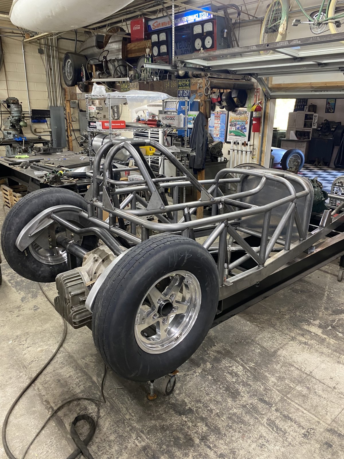

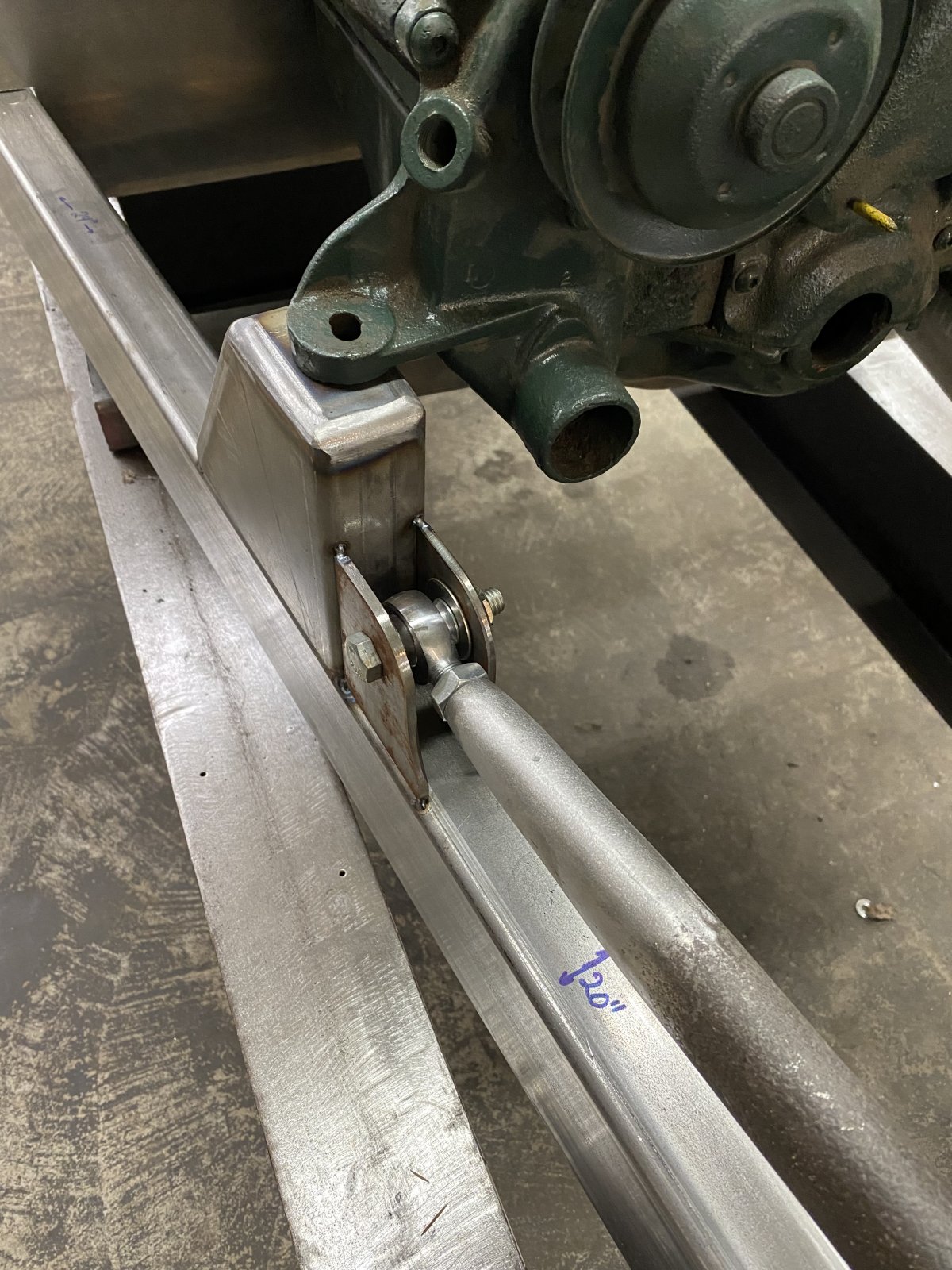

    Still plugging away on the streamliner but it is such a huge and complicated undertaking. So friend and me are going to build a basic, much more simple, roadster to get some seat time and have fun racing while the streamliner gets finished.
    26/27 glass T body, pulling the drive train from the Rouster roadster for power and using parts we had laying around to get this one together.
    here is the progress from last weekend. First work session on the car other than gathering parts.
    bent up the main chassis rails, started bending roll cage, and mocked up rear end mounts. Rear end will be rigid mounted but am planning on making it so I can easily add suspension down the road if need be

    Looks good but I would seriously rethink the lack of rear suspension even if you limit it to 1/2-1 inch.
    Stogy likes this.

    A rigid front suspension works fine. However rigid in the rear is not the way to go. The surface condition's over the last six years have been all over the place. Being rigid in the rear on a poor surface will end up as a wasted run.
    Also a roadster can never be compared to the Costella built cars with there long wheel base, narrow width and extremely low profile. I would bet the frames due to the length actually add some suspension from movement over length..

    You sure you don't need a heavier-duty rear end behind the flathead?
    I don't have my Dream Wheel nor a current record book handy, but I think the record is in the 160s, so there ought to be a bunch of car rear ends that are 1. strong enuf, 2. less expensive, 3. with lots of ratios available and 4. not having another set of gears to pull in high, straight-thru transmissions.

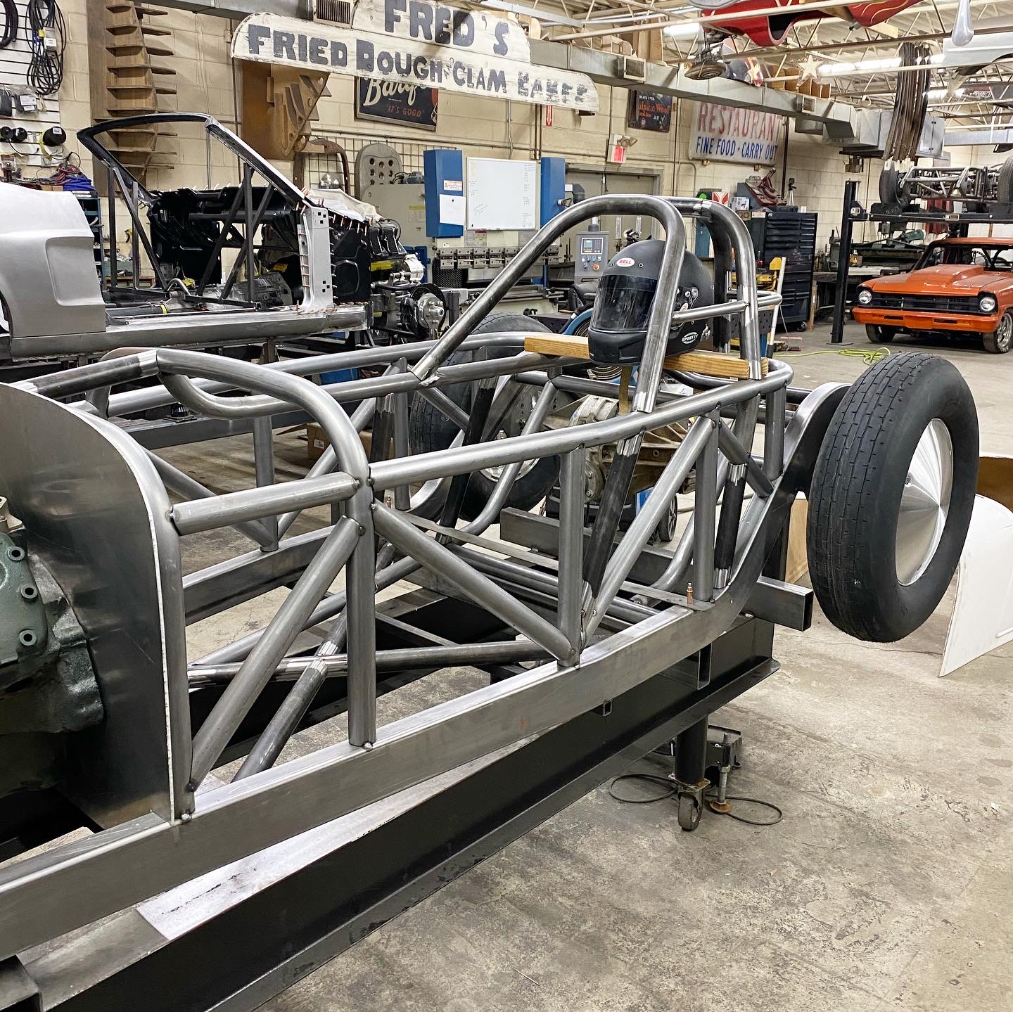

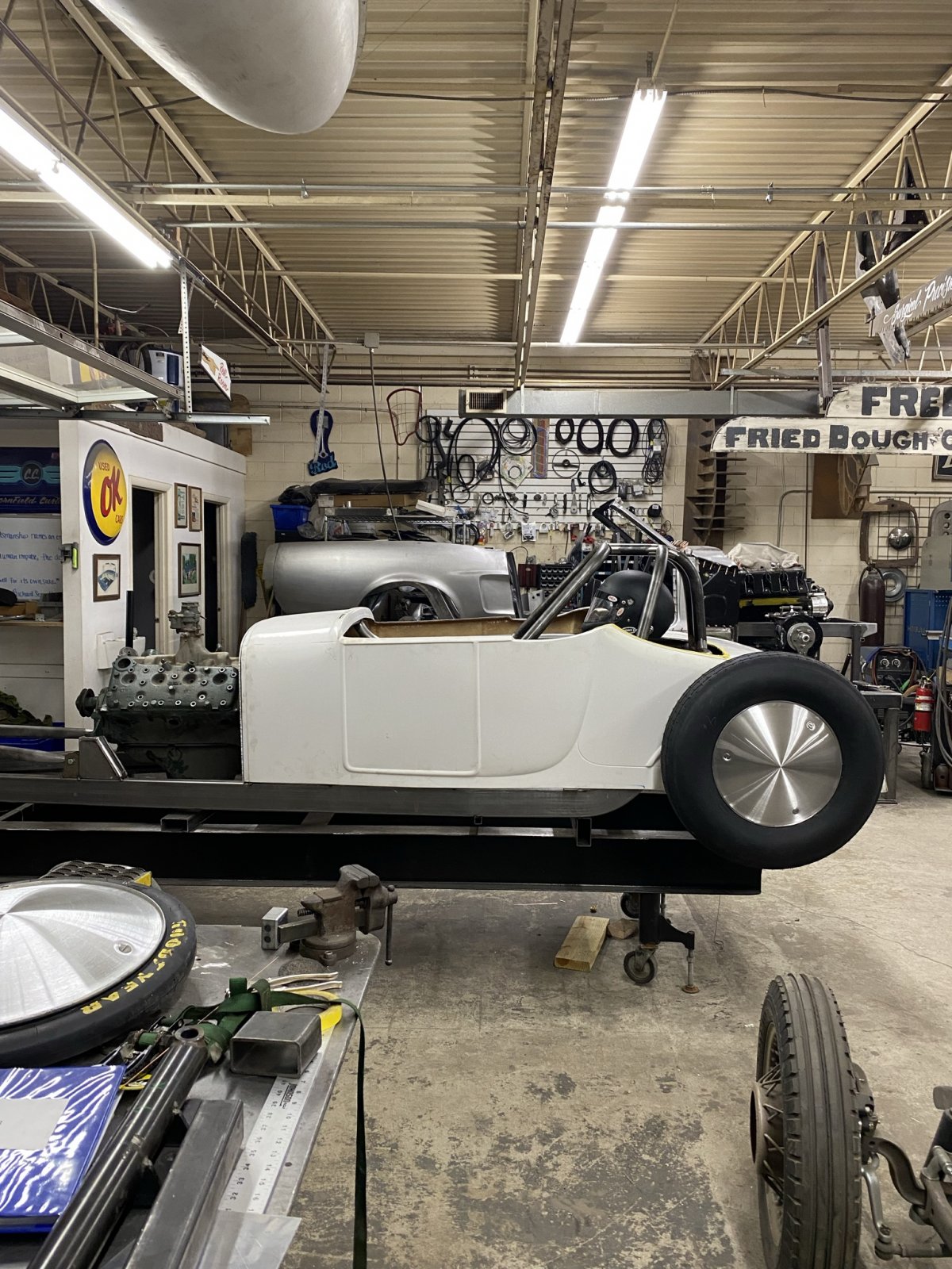

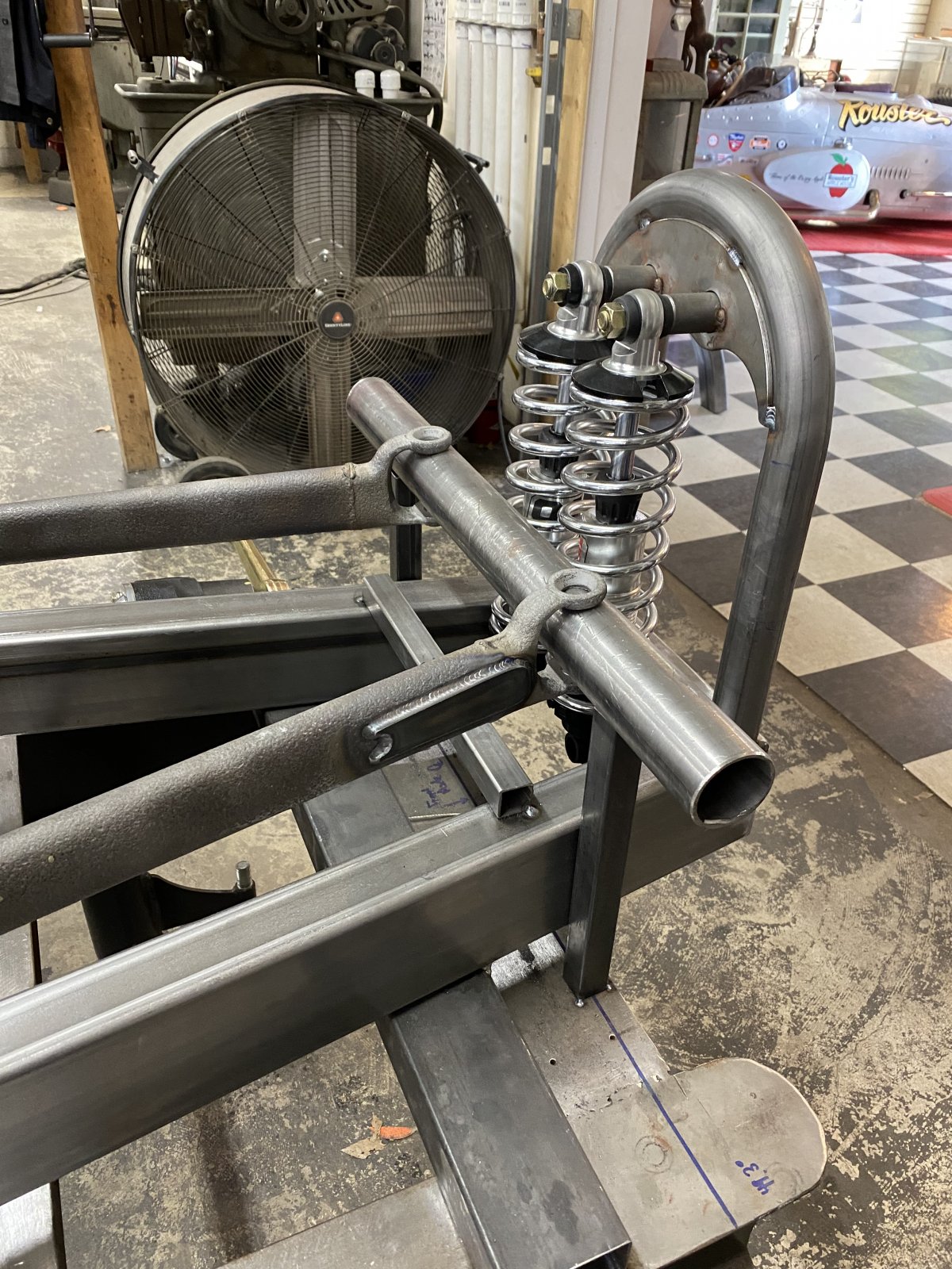

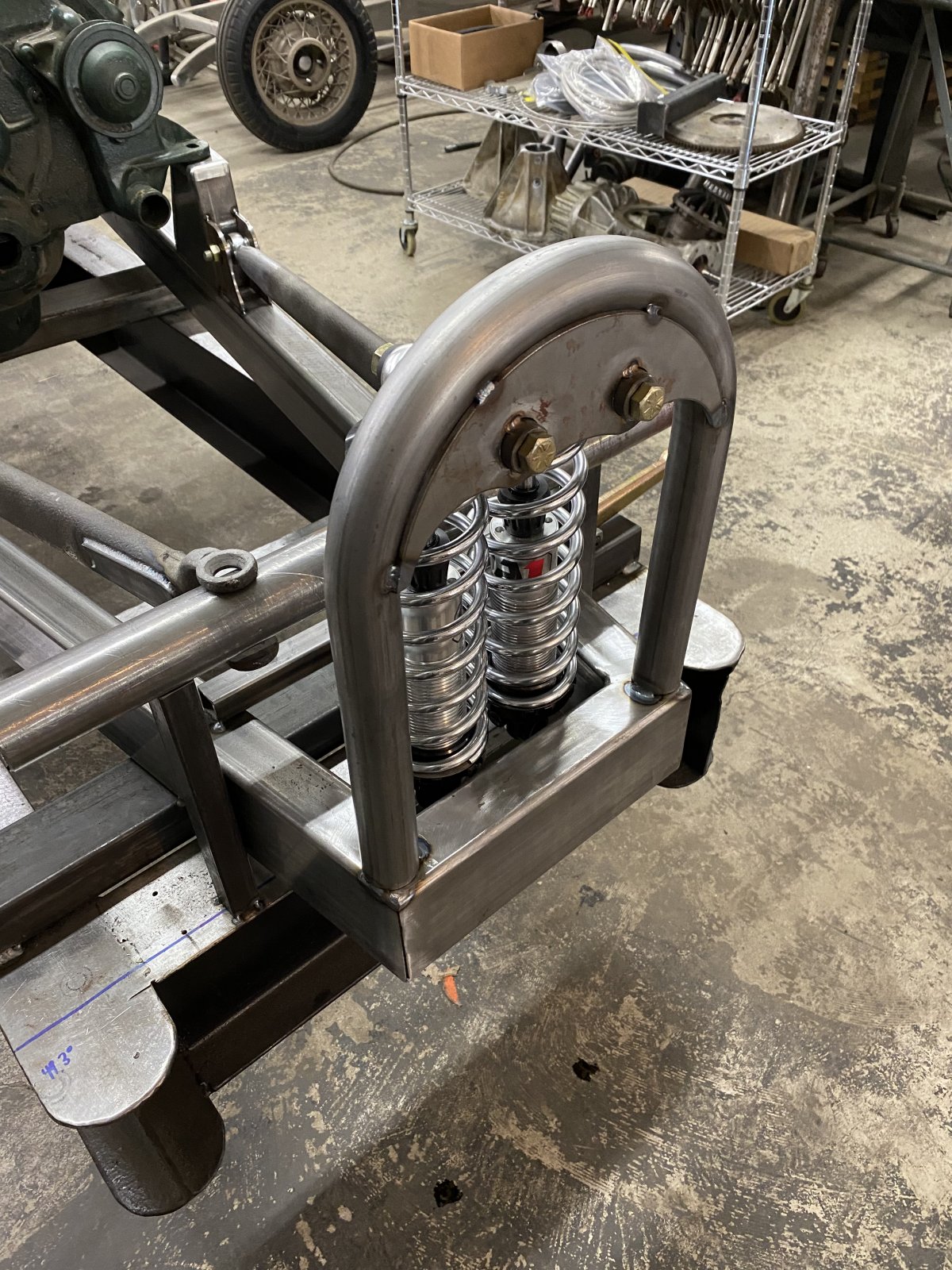

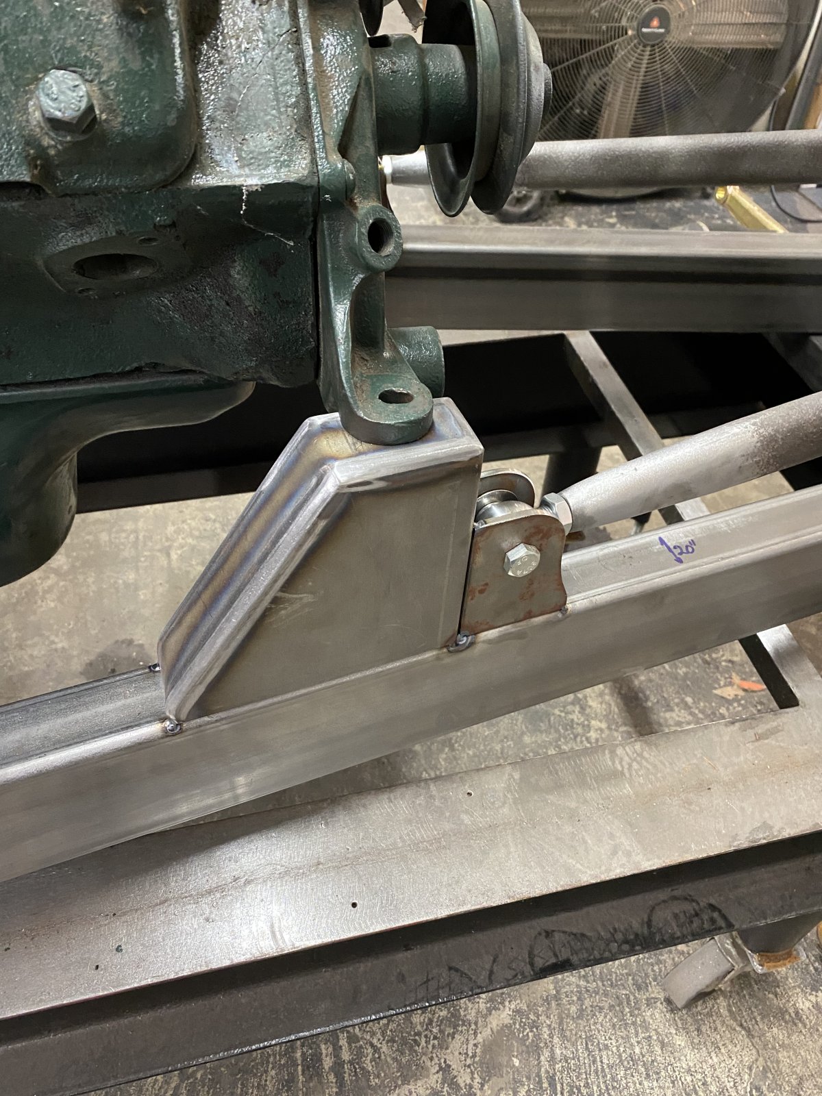

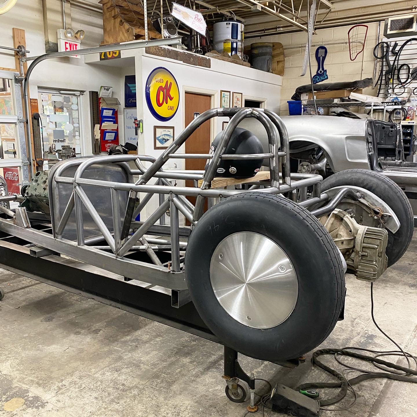

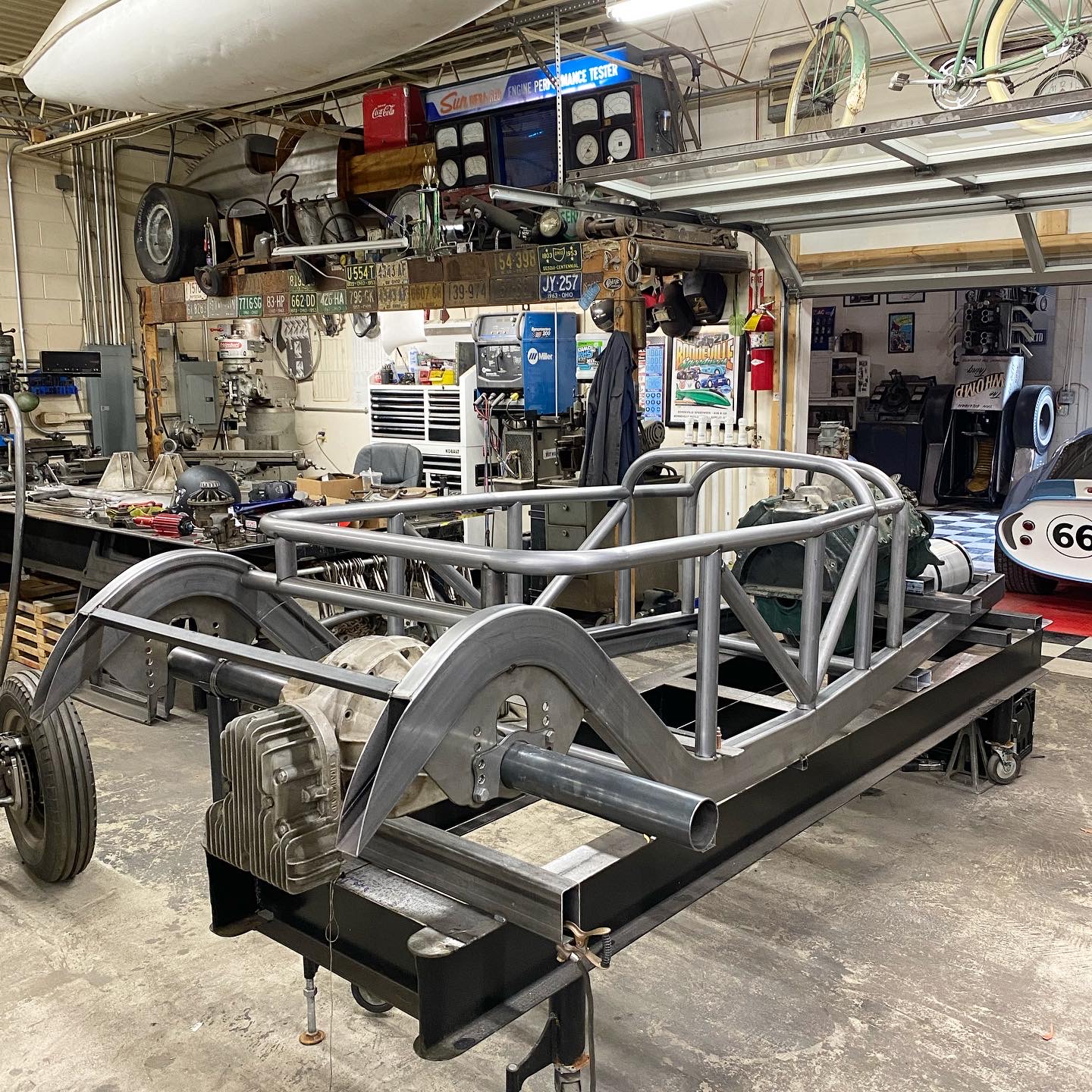

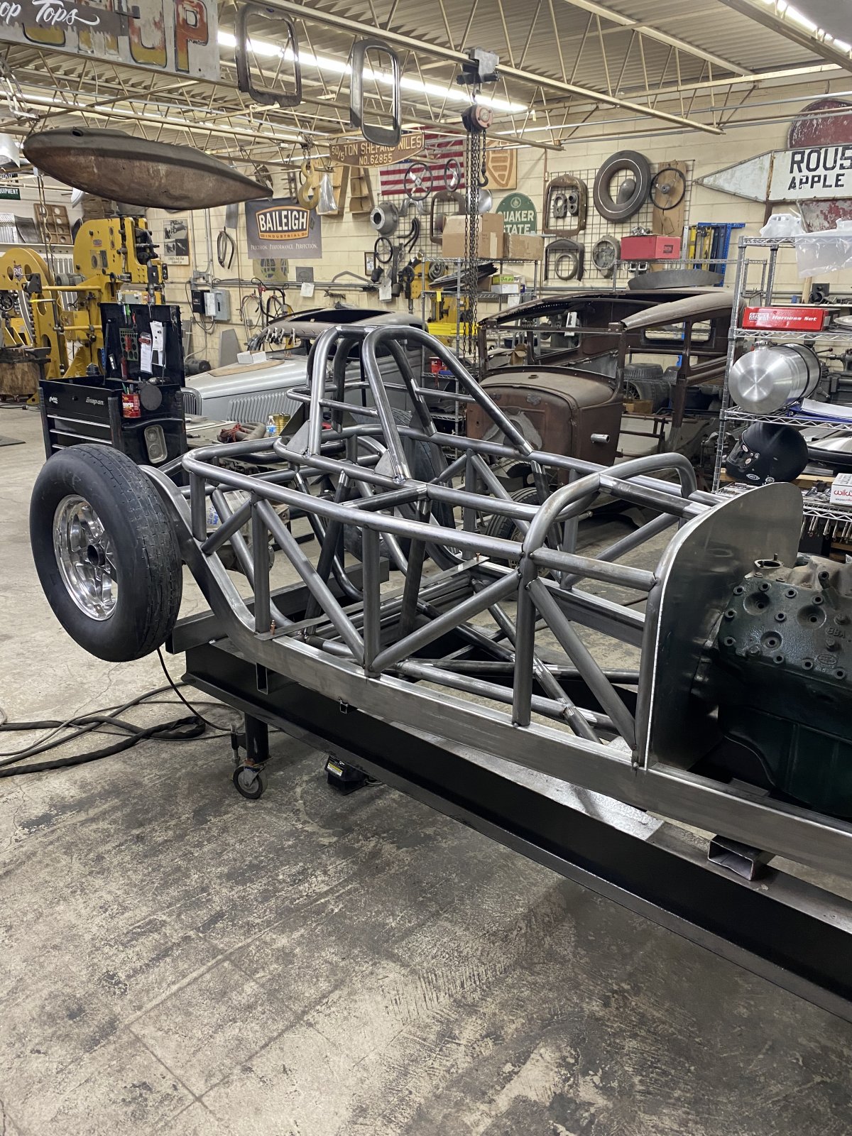

    Back in the shop after TROG and Hershey. Been making a little progress here and there. Its slow going on this one since i only work on it nights and weekends. 782D9CAC-C8D1-4B51-A55A-F2D5886C7167.jpeg 21D480F9-1785-4F2B-9E5C-F066872E831D.jpeg C19269F0-2201-40E6-A8C6-26459FA6626E.jpeg 5EA27457-10B9-46AC-8B4A-66DFB5591502.jpeg E328E518-8166-40E4-91C7-FB8BA5813D6C.jpeg 77970DDC-97CD-4759-9436-D1CEE2832851.jpeg B41A9074-7A8B-4830-BD3A-22D8CAE1E952.jpeg E9D970CC-C7A2-4E51-93BD-35DAFCF3EC78.jpeg

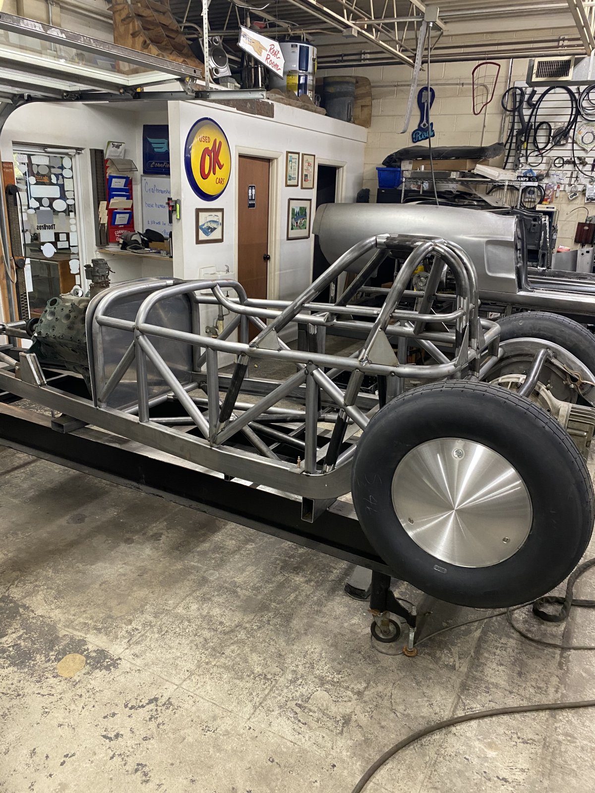

    A little more progress from today. 9820675A-A032-4993-85E6-D2C3E80D8AE5.jpeg 10E001E7-C58E-4C29-AEB8-0C165FC58C0D.jpeg E283D754-3B8B-4CF5-B1DB-F523FA89B308.jpeg 82D003FD-7BF7-4744-9BB5-3E66A4BCE3E1.jpeg 5844B5C3-4CD9-4F18-8660-67755CE540B4.jpeg
  22. Looking good, I want to see it with the body on again.

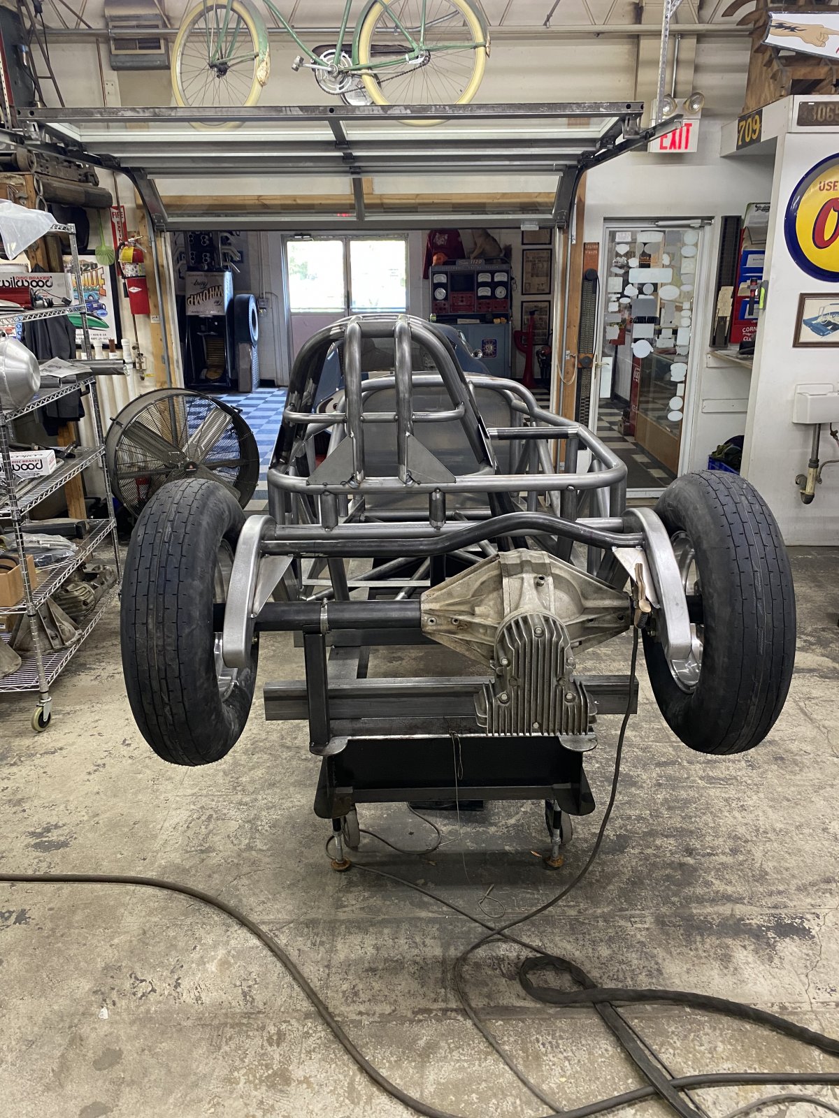

    Have you figured u joint angles for that much rear offset? Maybe go with double cardan joint?
  24. cornfieldcustoms
    Joined: Feb 2, 2008
    Posts: 1,056
    cornfieldcustoms
    Its less than 10*, i have had my driveline shop check it out and they dont see a problem with it.

    Nice, but why kick up the rear frame over the rear end..most leave the frame flat when building a modified roadster.
  27. cornfieldcustoms
    Joined: Feb 2, 2008
    Posts: 1,056
    cornfieldcustoms
    because i wanted to. Makes pulling the rear end out easier, i am making a diffuser for the back so the kick up helps that flow.
  28. I want to see how low the cage sits in the body! Agree on covering the cool stuff.

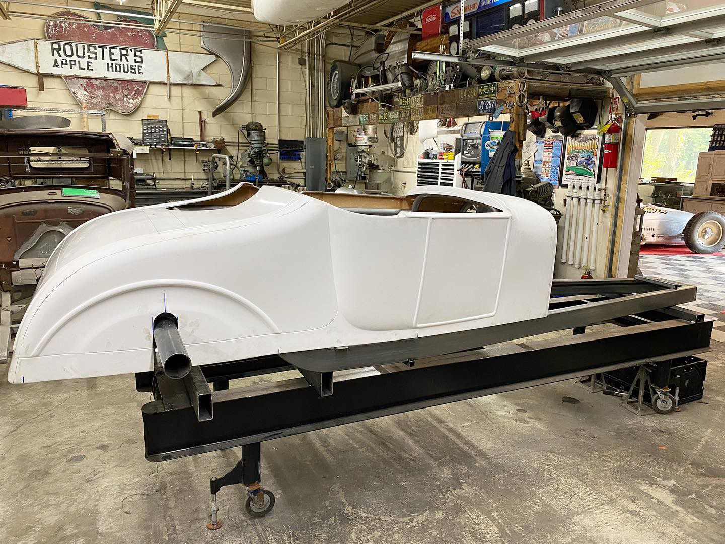

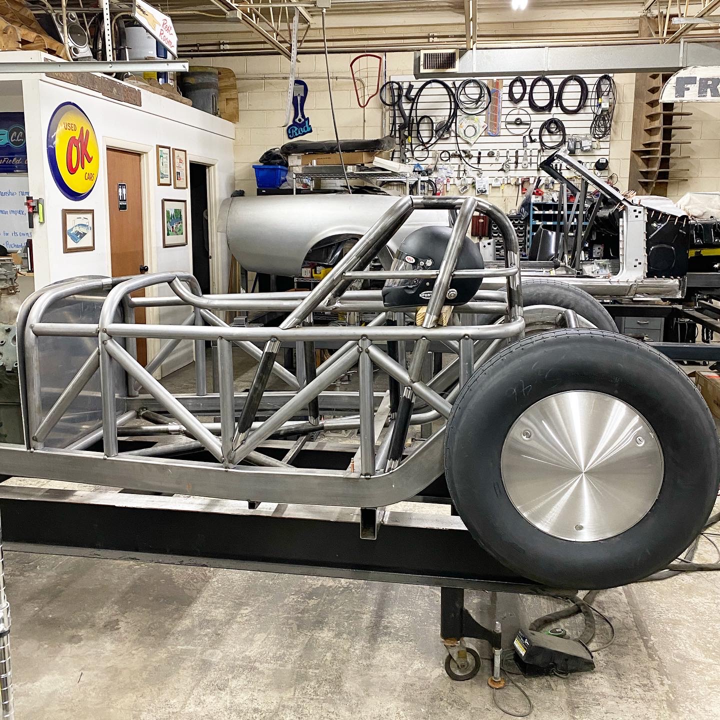

    here is one from when i was still working in the helmet bars. Will look much better with the tonneau cover over the cock pit opening
