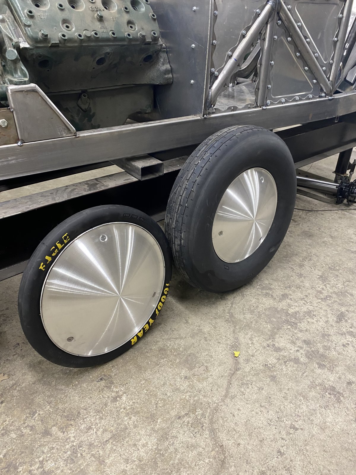

  1. Looks great! Hard to get much lower. I hate seeing cages stickin up in the breeze! And do I see some skinny 17s for the front?
    Stogy and loudbang like this.
  2. cornfieldcustoms
    Joined: Feb 2, 2008
    Posts: 1,064
    cornfieldcustoms
    Yes they are 17 x 2.5

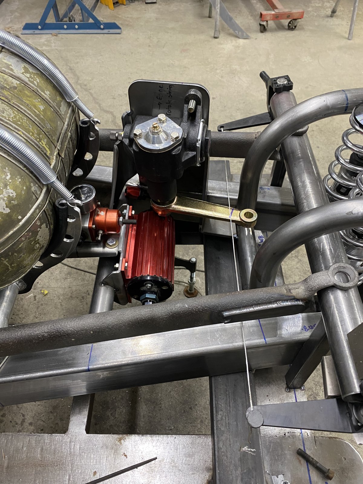

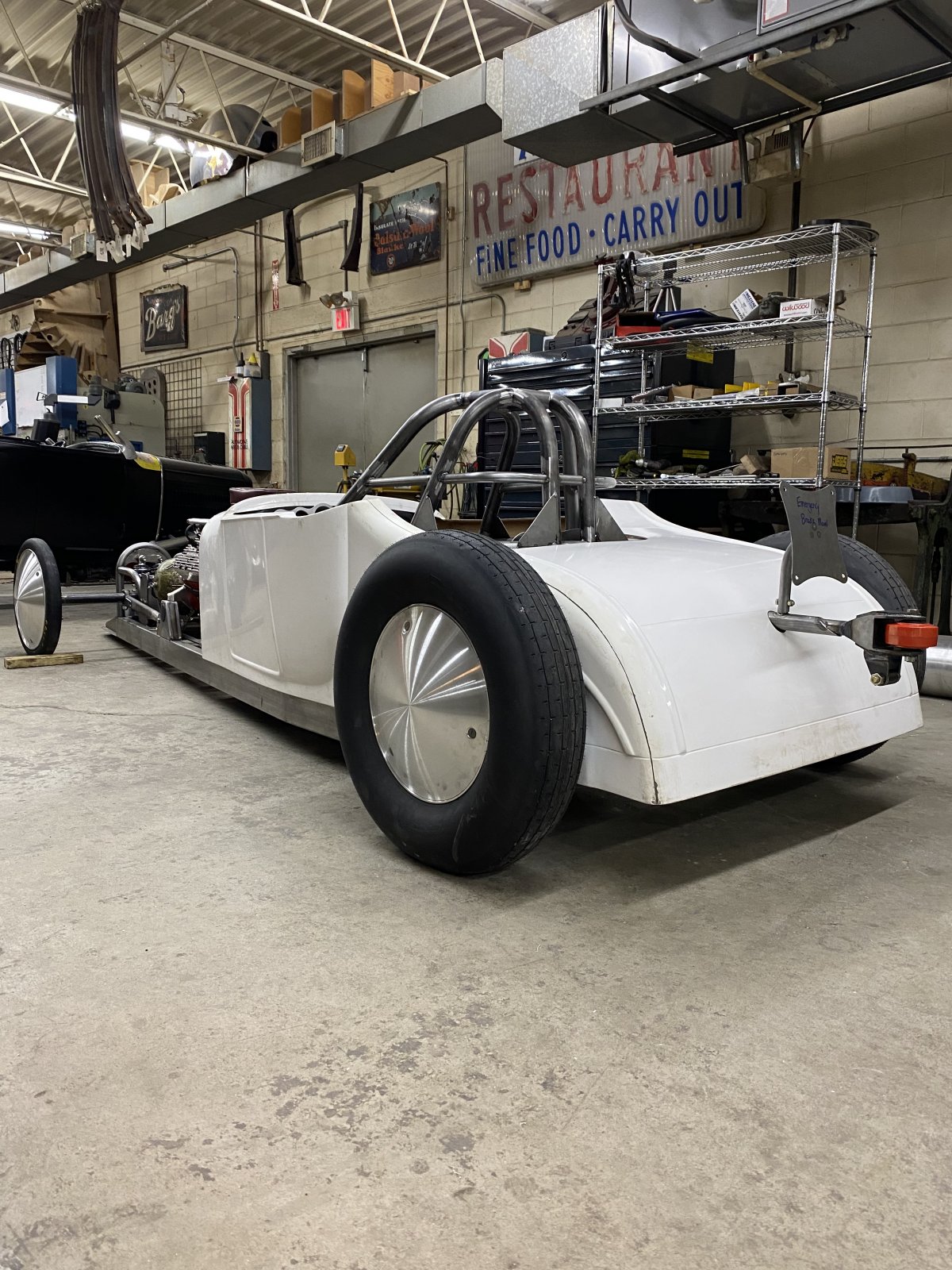

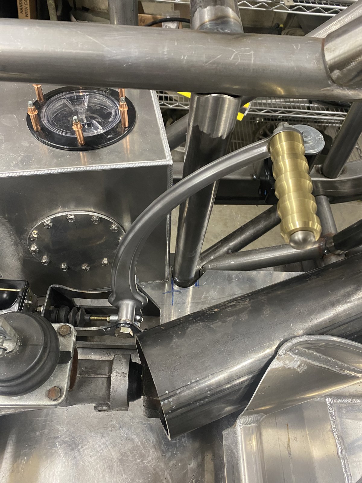

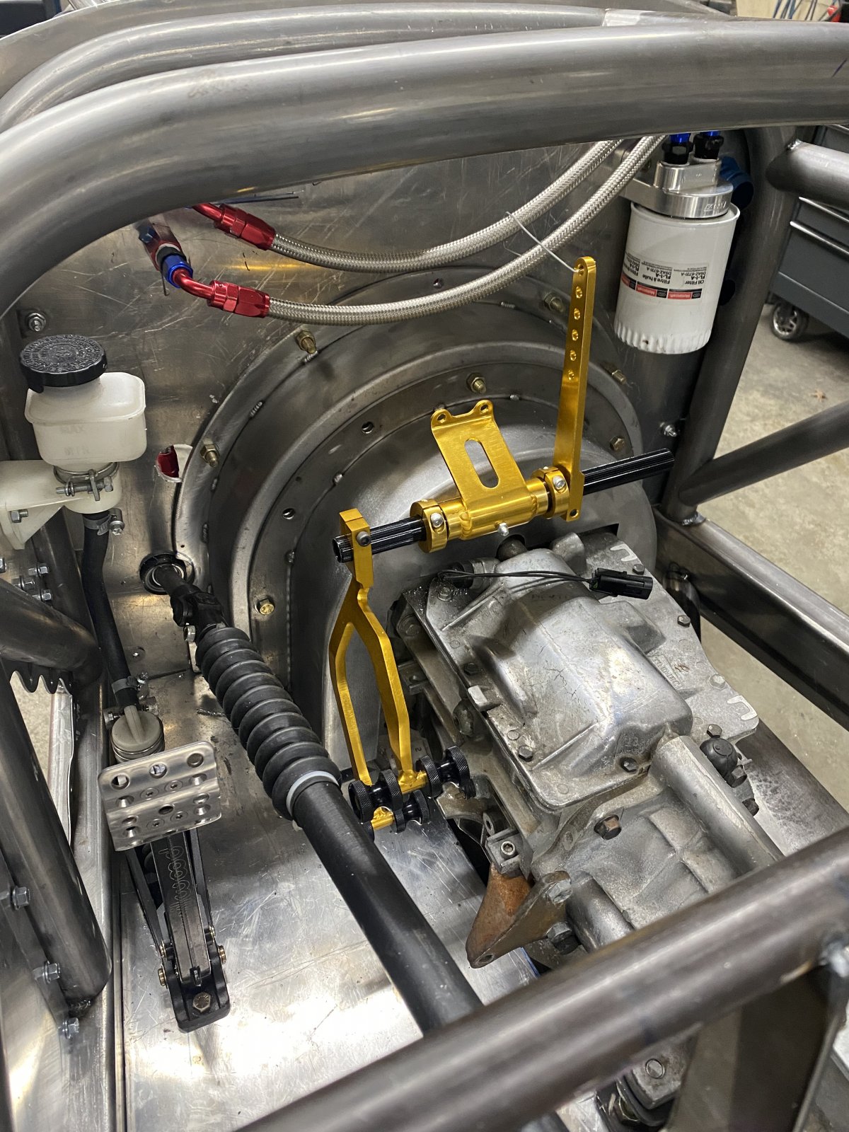

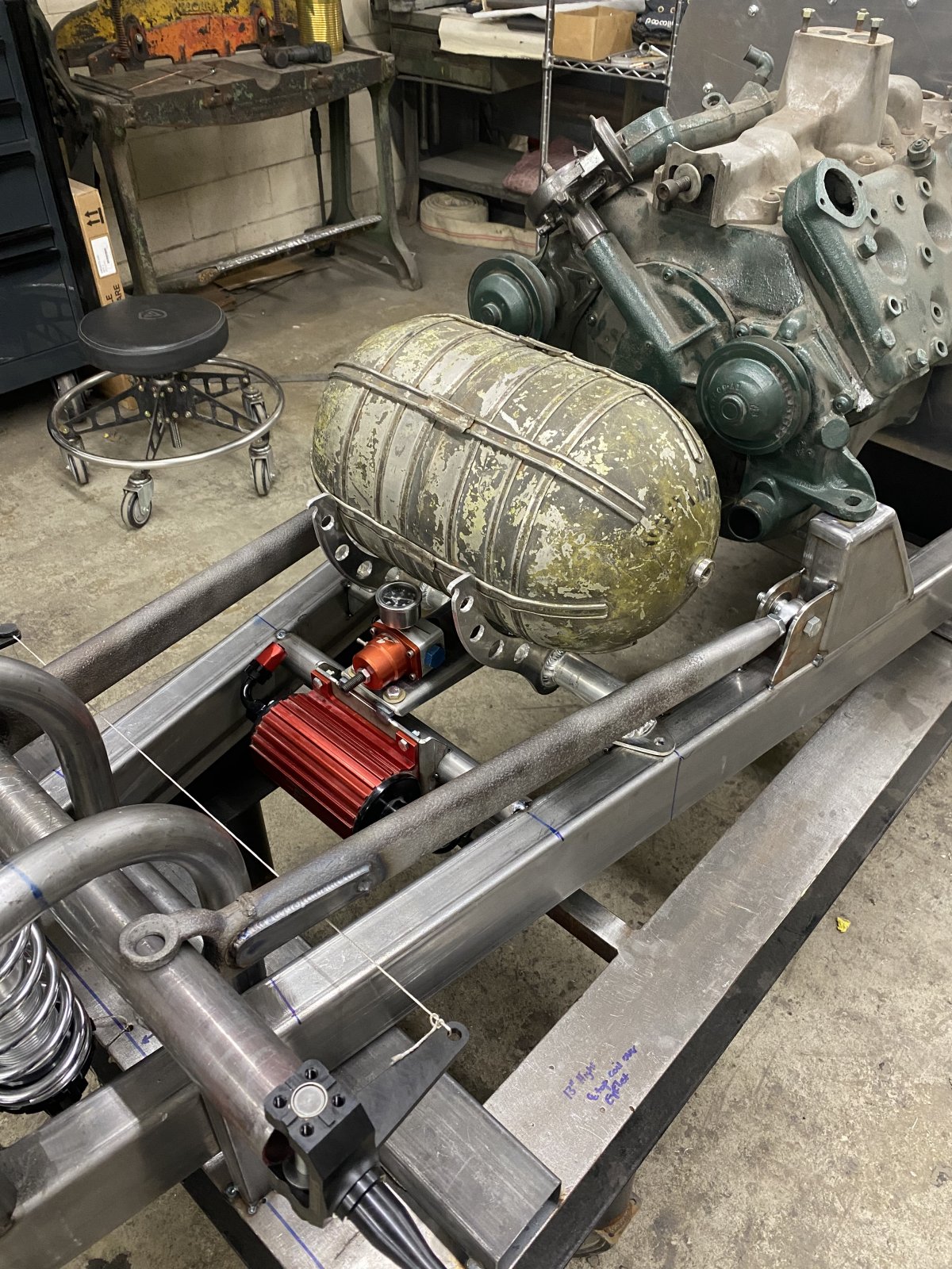

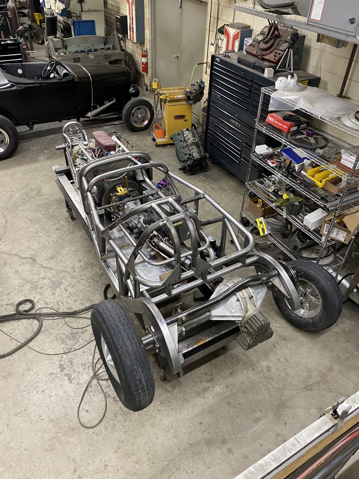

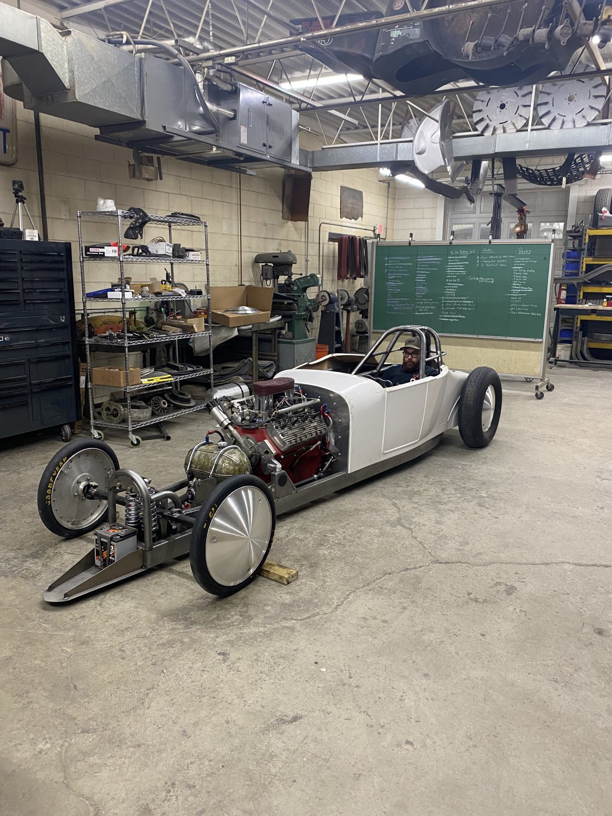

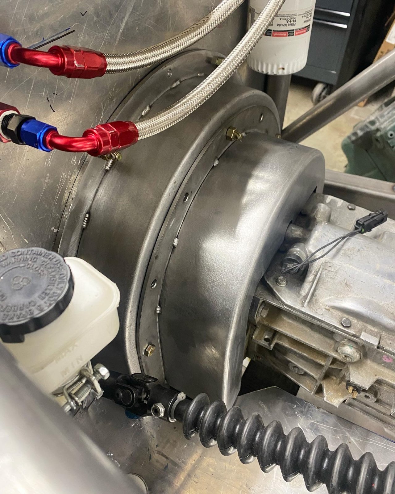

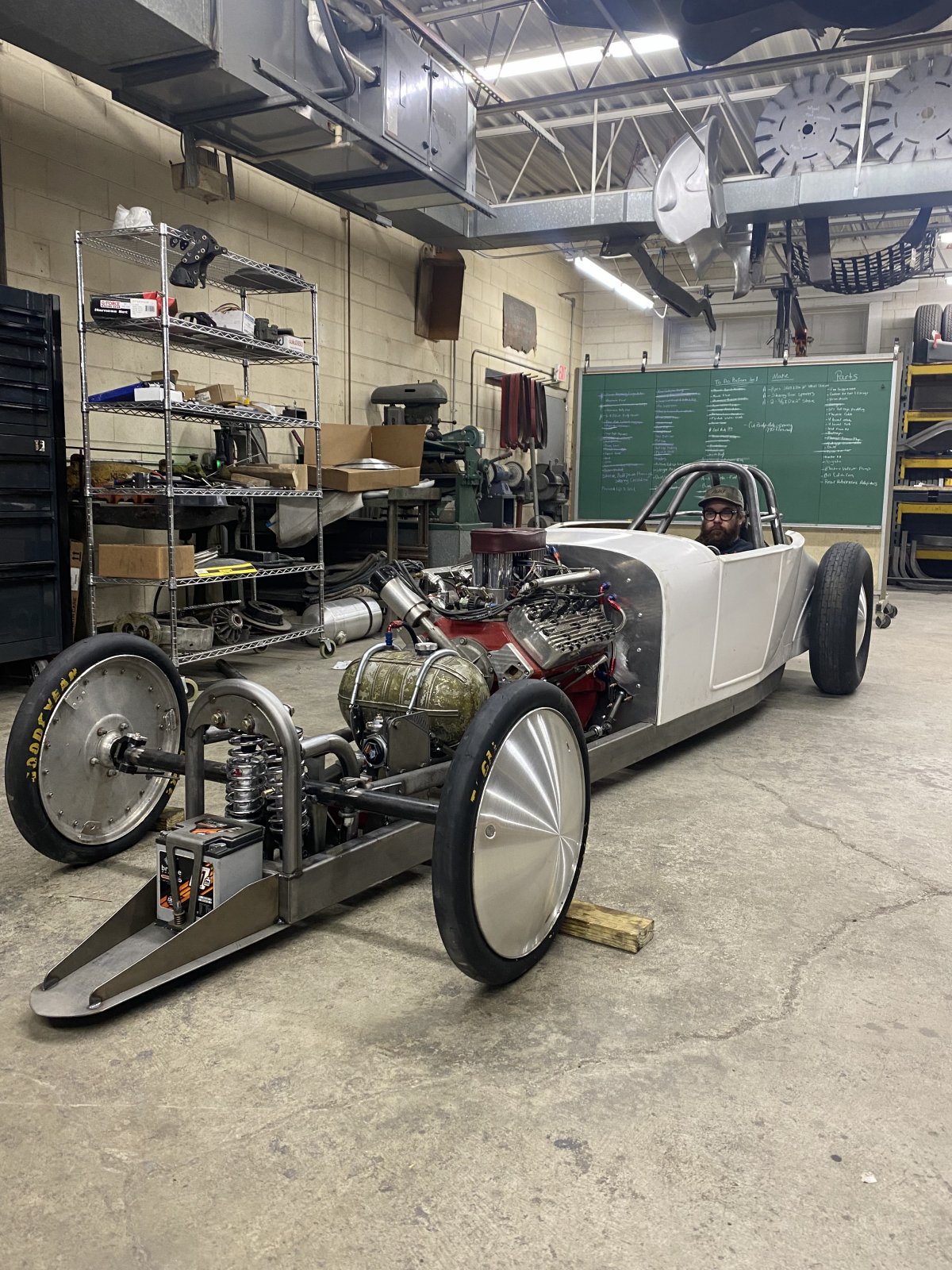

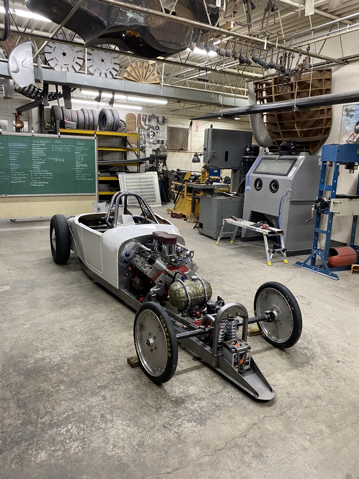

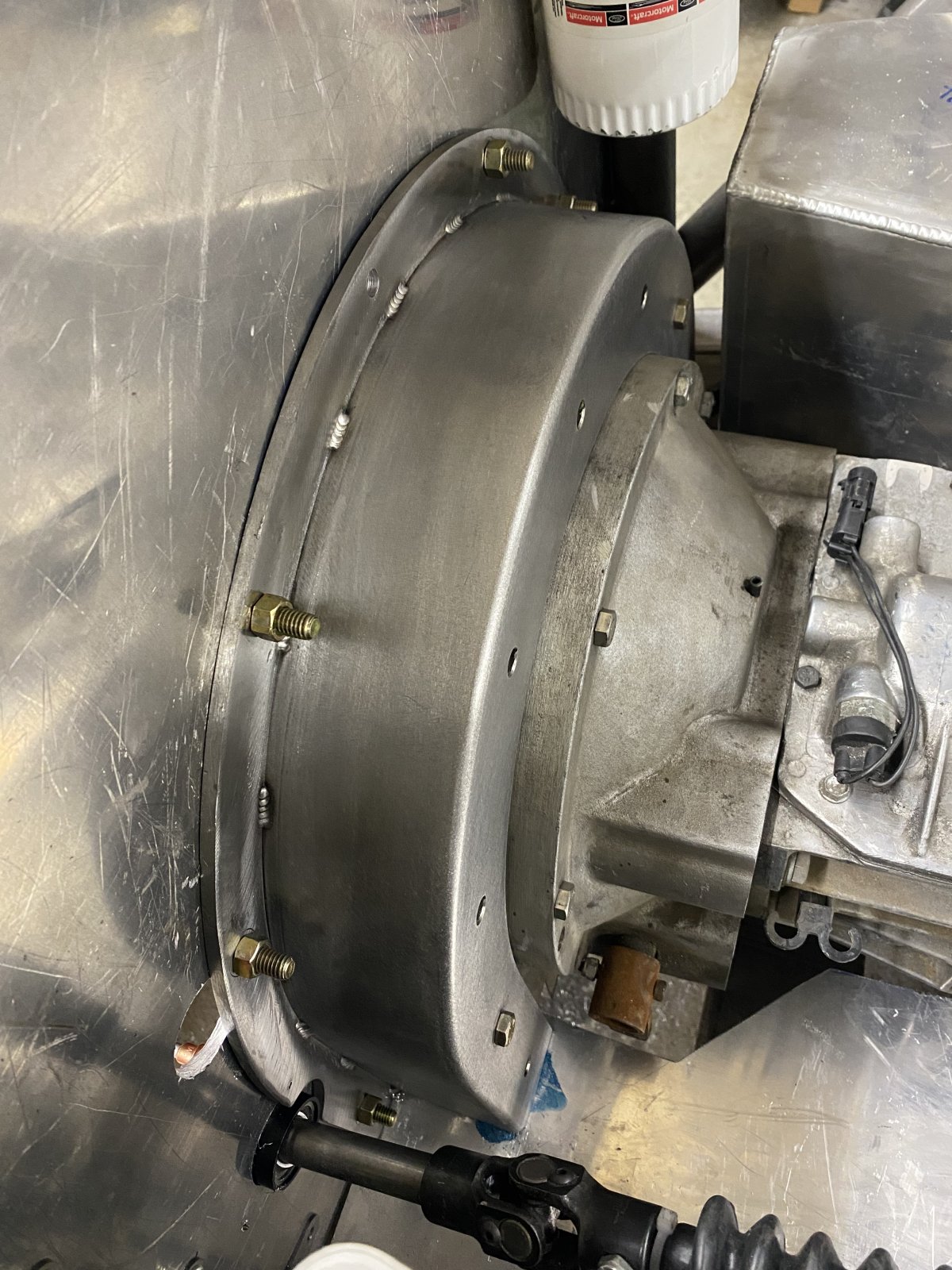

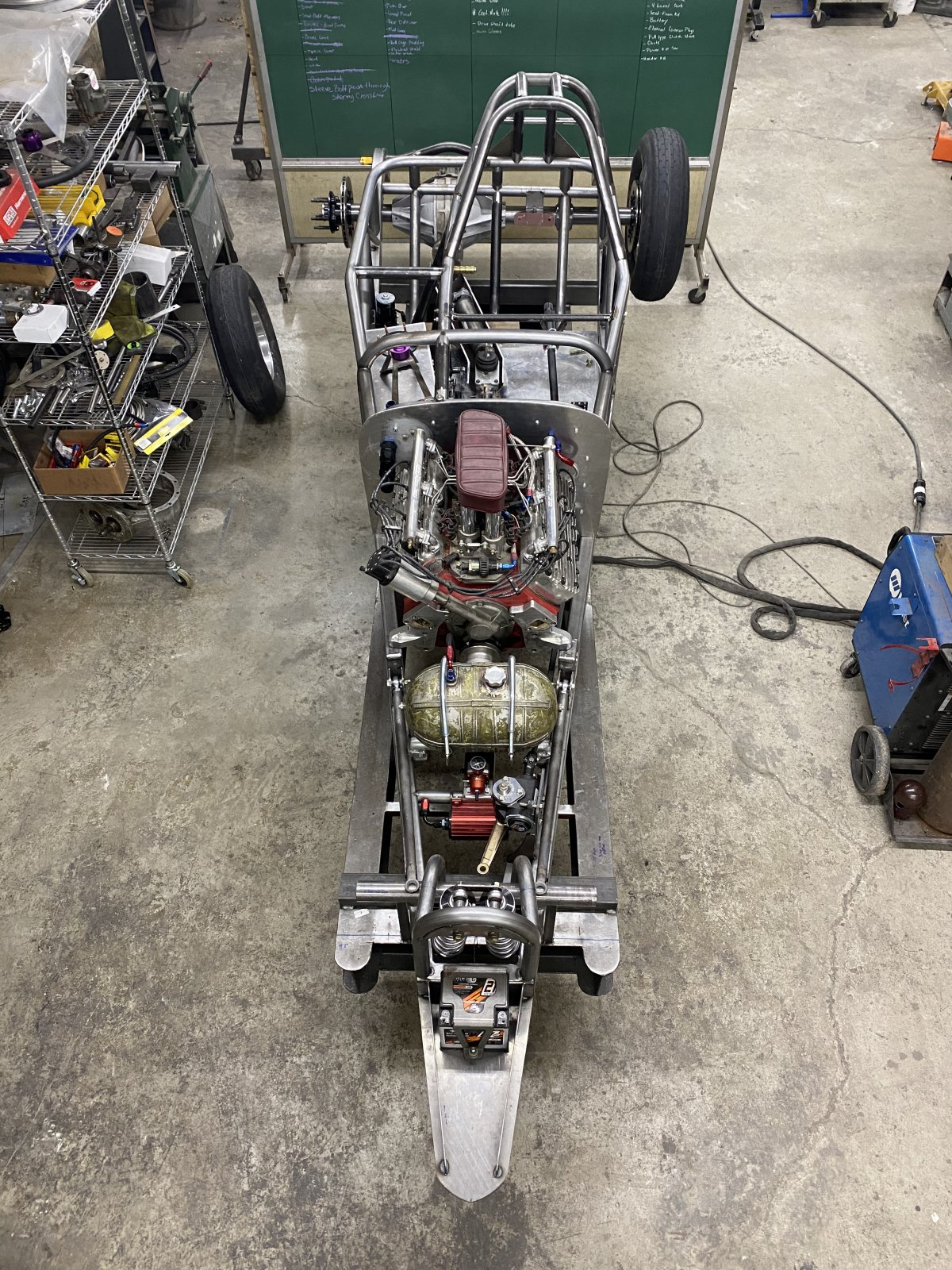

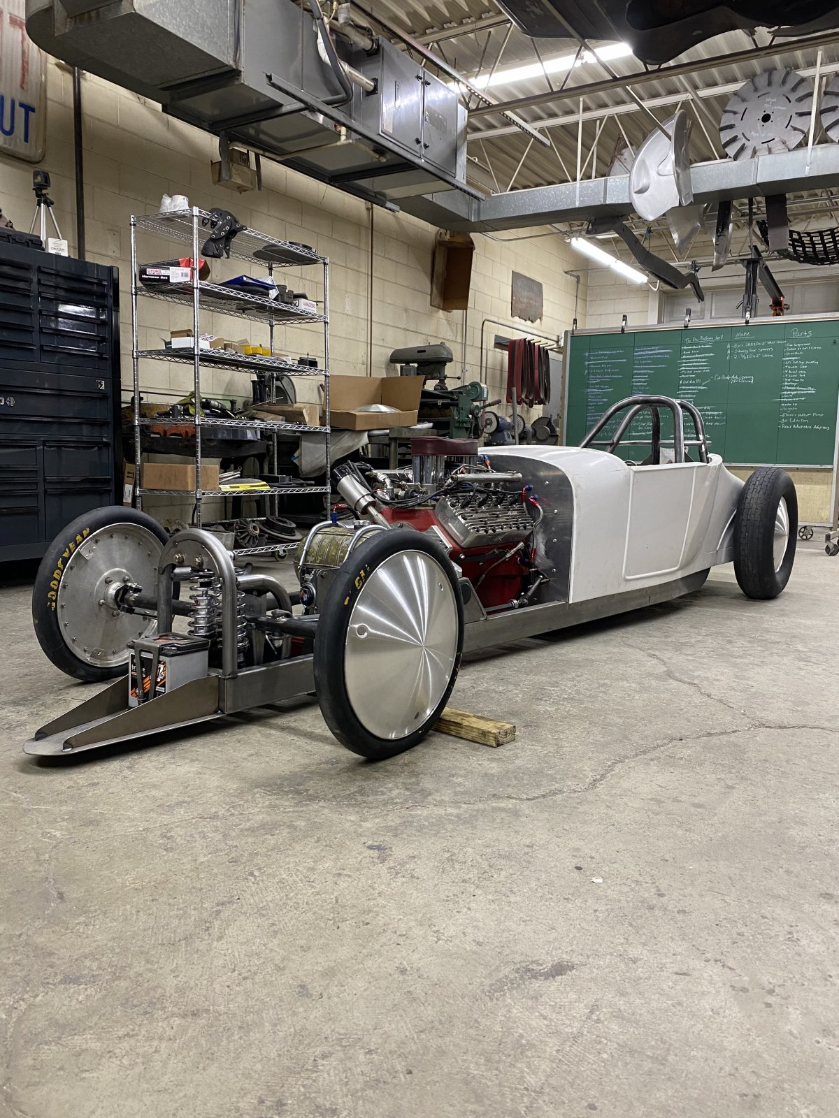

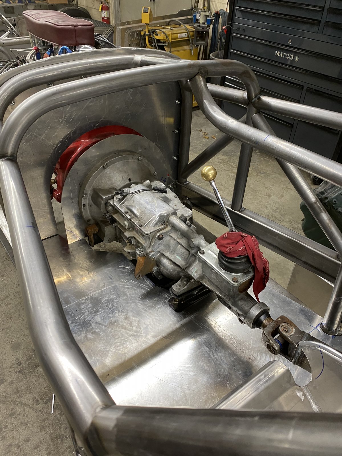

    Tons of progress being made on the car. Just havent posted much on here. Steering, fuel system, engine, trans, ****tershields, driveshaft cover, shifter, clutch, water tank, hand brake, seat, and more all mocked up. I will post up a bunch of pics since they are better than talking about it DFDFB6CF-CBA4-4E27-9AF2-A95D99E1FB35.jpeg B83CF825-2092-4ADA-A79C-E7B2B41BE532.jpeg 84EA018A-3559-4562-897E-541402FE8989.jpeg 9BC59EB2-E6A6-4981-A882-01B1CE2F28D7.jpeg EE51A514-B88E-4793-851A-83C6D60D4A40.jpeg 32BB37DB-2AA5-4C45-A8B9-B5002BF20CAA.jpeg CE829875-85CB-4D89-8CC0-061381B3E157.jpeg 0FDFD39F-3751-4A70-9227-A3EF4447DCC3.jpeg E53C07F9-22EF-4E32-A899-09A08CFA2A8C.jpeg 8E24D8D0-77F2-4BE7-A73E-3E2D1AEF4634.jpeg A555935C-2488-41B4-81A4-4E9CB6E1BE74.jpeg 98EBBF1C-DB5A-4626-90F6-B57A09371930.jpeg FB450C63-B1AB-460E-AA61-49933665A9F5.jpeg 59A4C458-6209-46AF-A134-B7D331D89873.jpeg

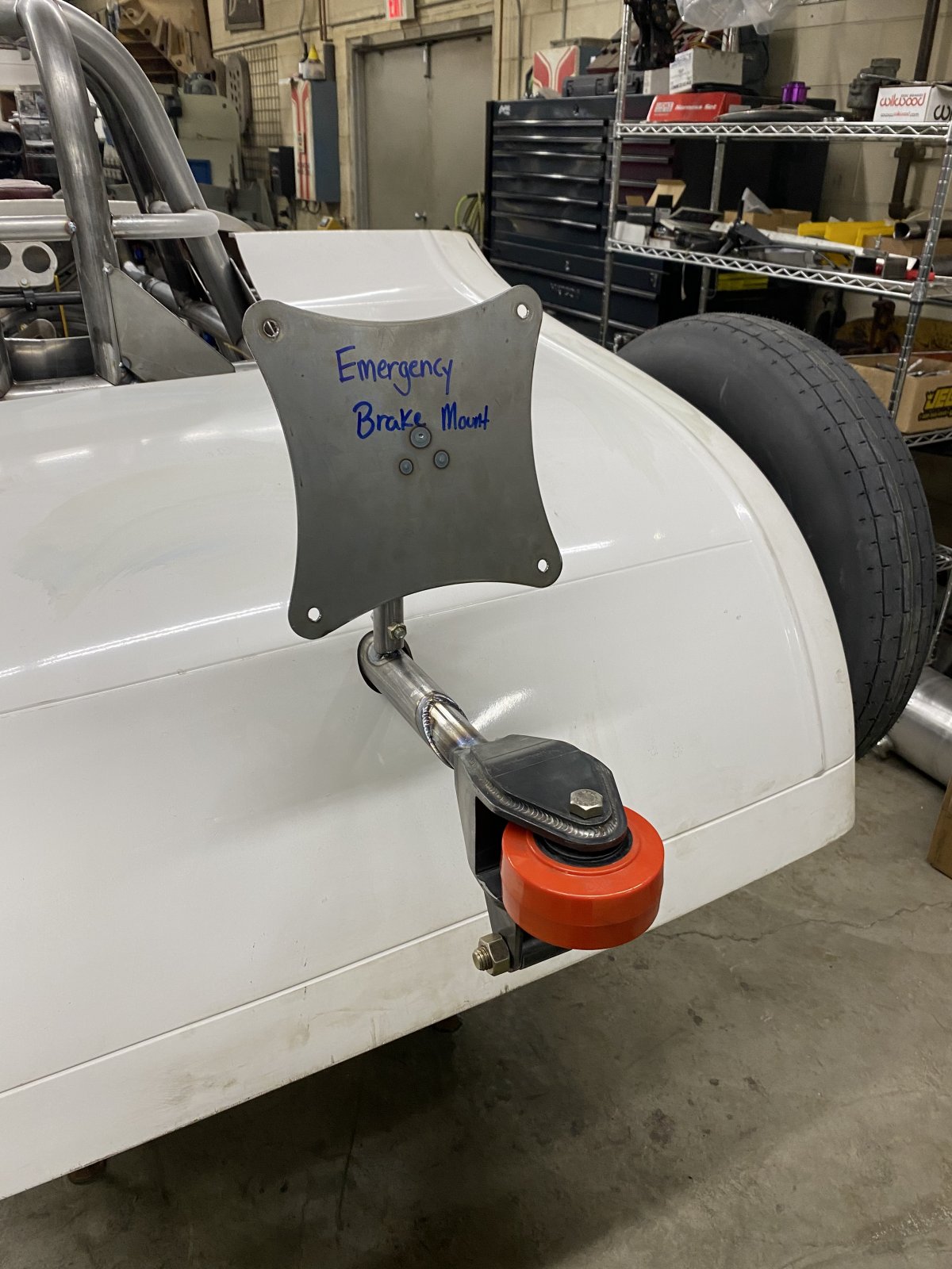

  14. cornfieldcustoms
    Joined: Feb 2, 2008
    Posts: 1,064
    cornfieldcustoms

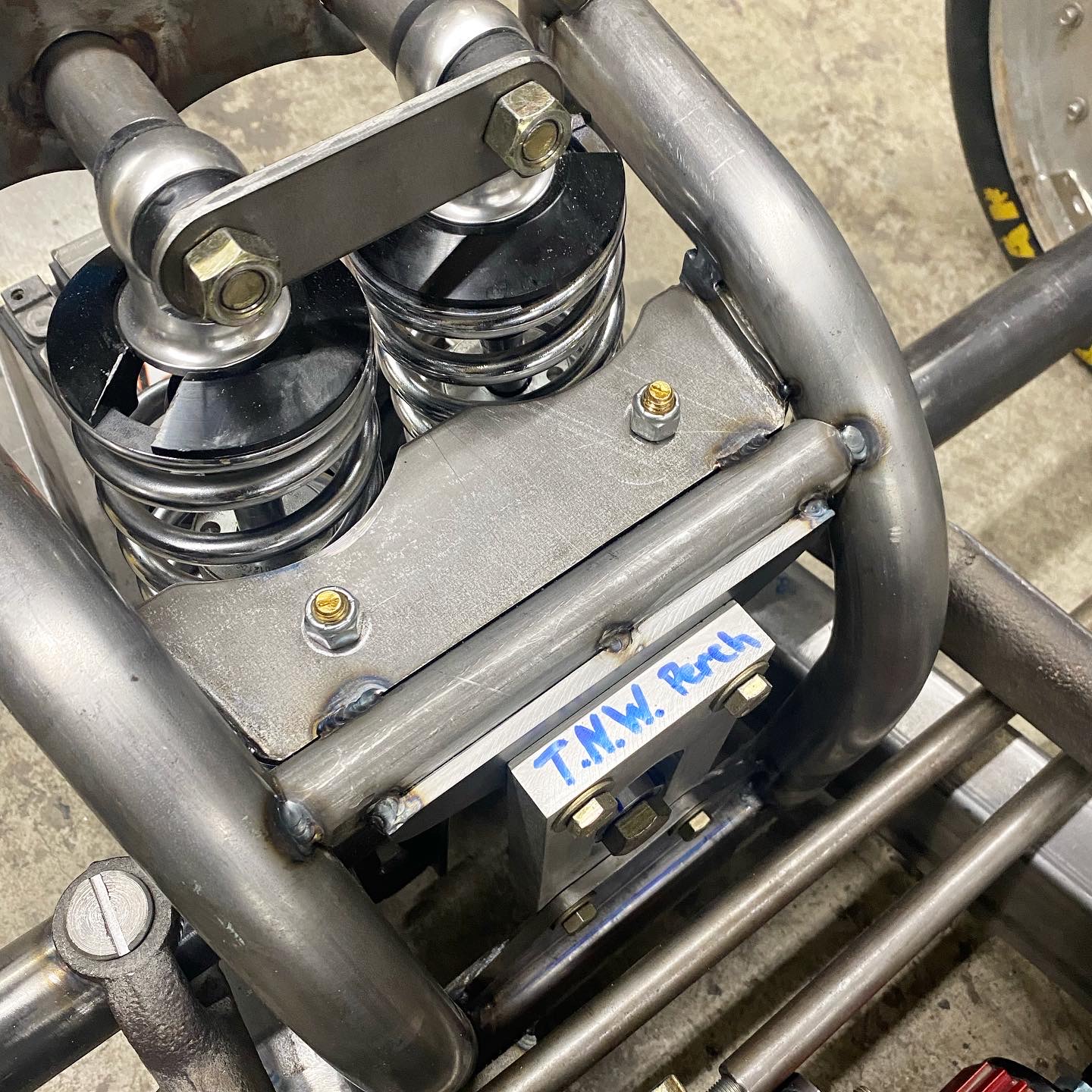

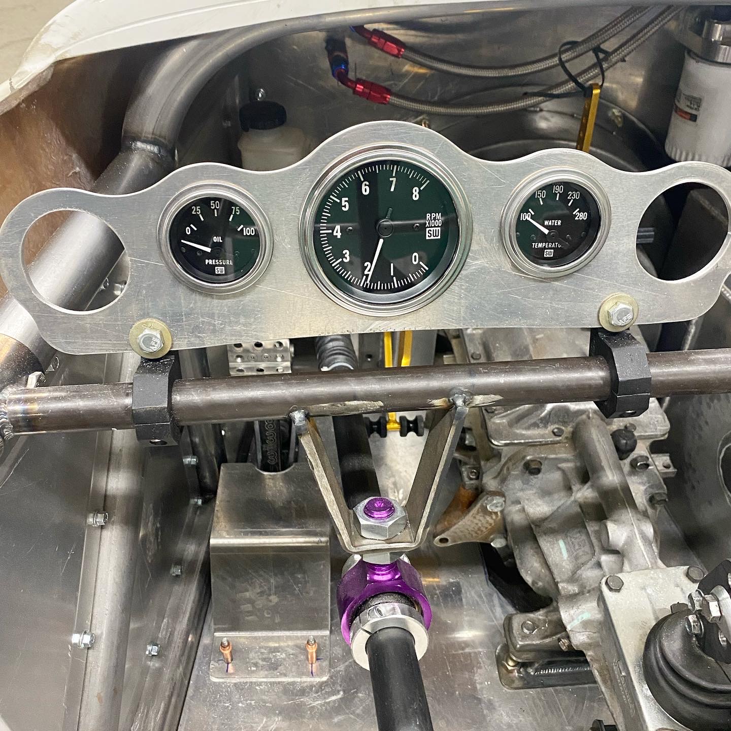

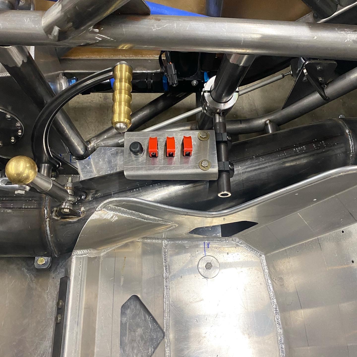

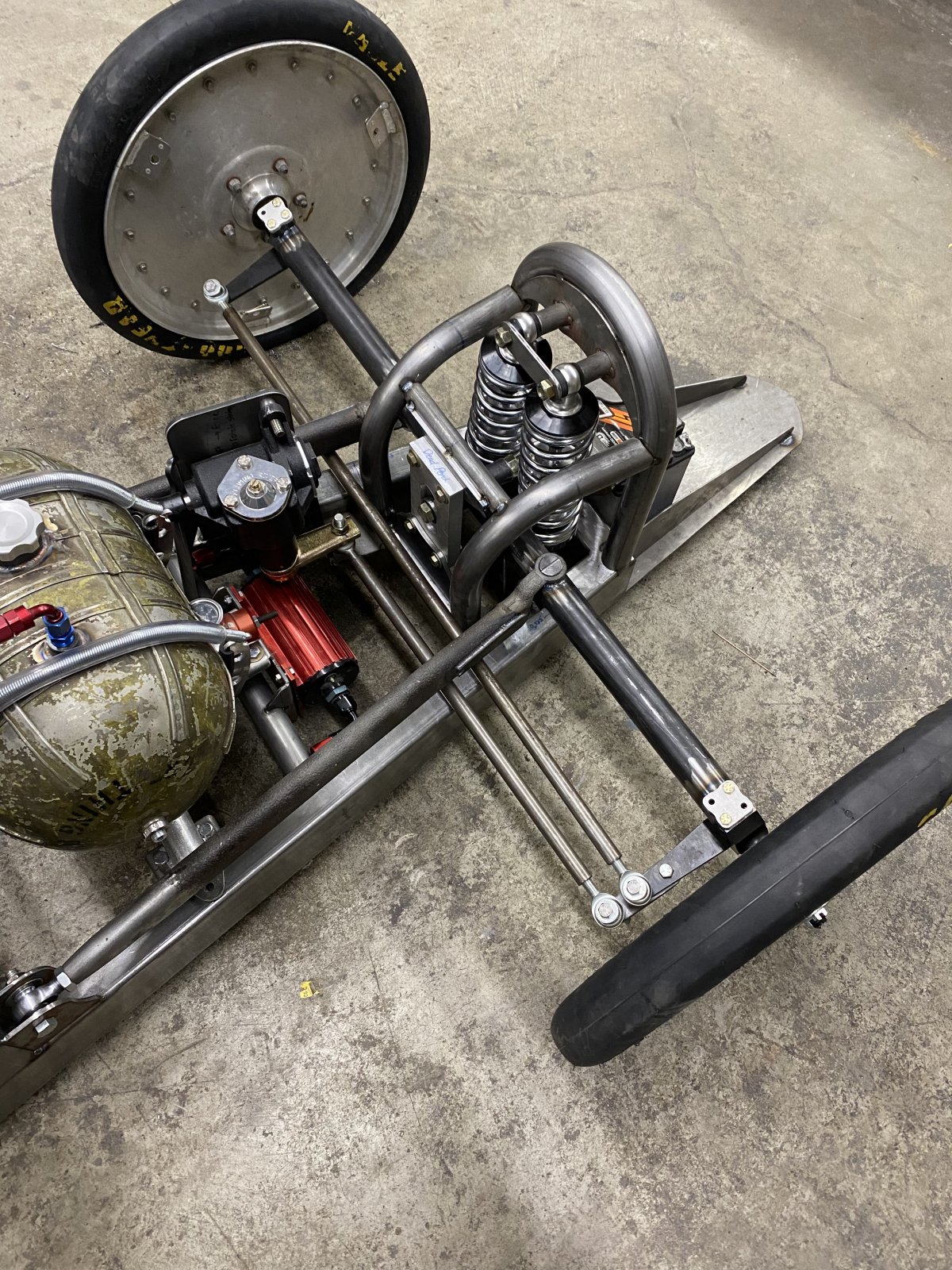

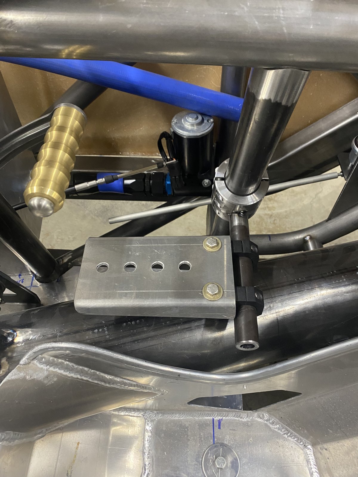

    Big progress. Gauge pod made, water lines going in, reverse lock out made, switch panel made, chute mount and push bar made. Front suspension all mocked up, steering mocked up, and car on all 4 wheels E4D29ACA-4900-4D5D-8F6C-58275A6643D4.jpeg CC887693-D5AD-47CA-97AF-31B2E8001156.jpeg D9079B03-4252-4DAF-BB72-ACAD7CB5AD9E.jpeg 0302DF65-FF29-45CA-B3AA-853CDC47F7CE.jpeg 2EE3D677-138A-4067-B61D-D6B08B32EAA3.jpeg D2C38339-E8B1-4AB7-A4BC-D877DADCCF81.jpeg 81DC9496-63E9-4403-8AB2-11FFD40DA6BC.jpeg 99EB40BB-39E2-4D0E-8CFE-D1499506FD10.jpeg 63621AC9-987B-4ECC-BB2D-366F9CCB26E8.jpeg F6816341-04B5-45D4-B736-B6277C105516.jpeg 12550C91-6F1E-4934-BD72-38D1BC3091CC.jpeg

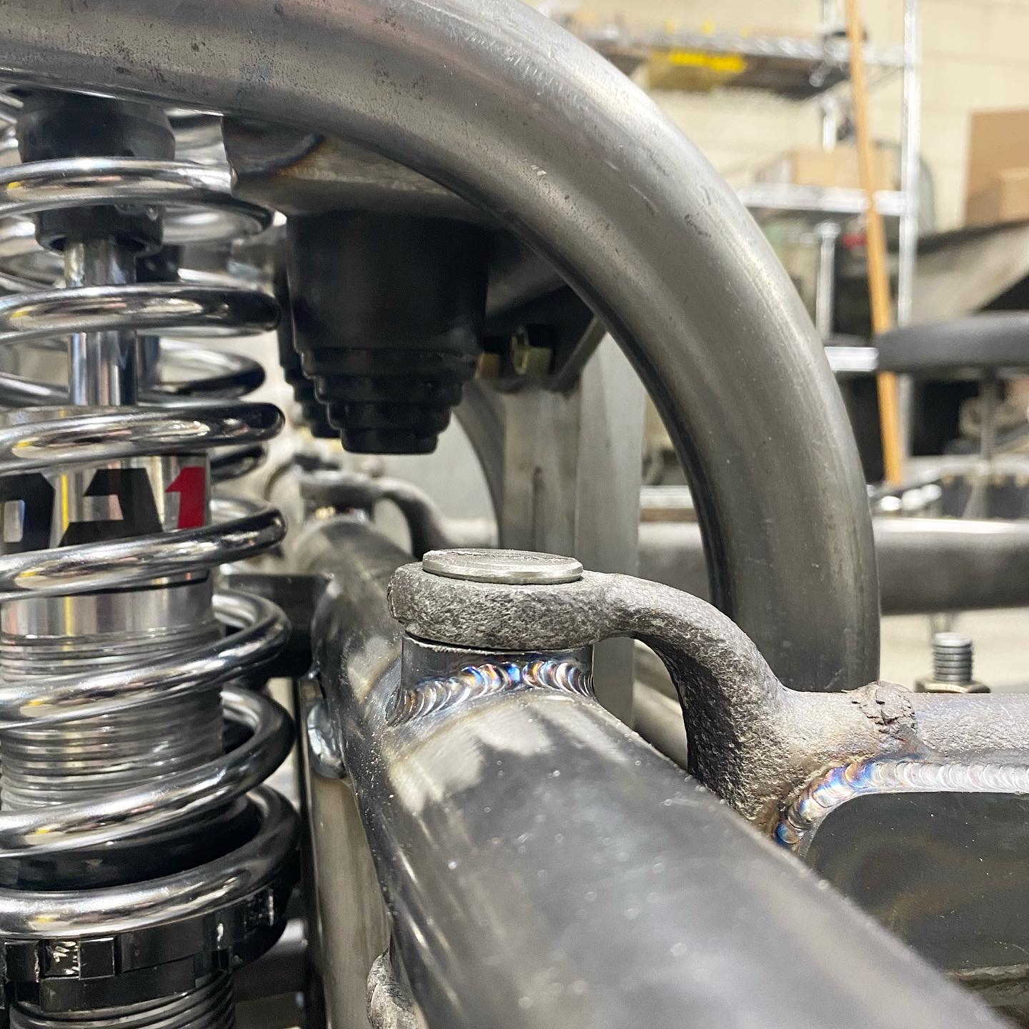

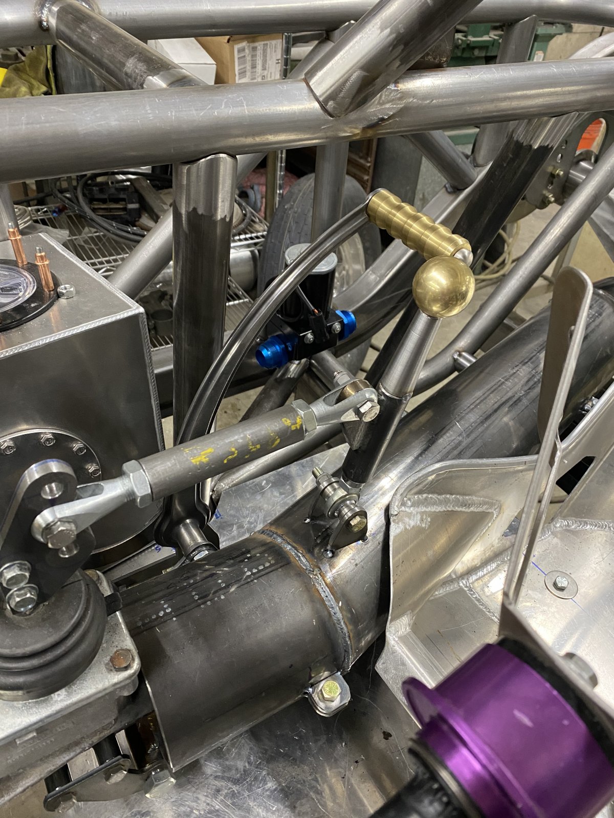

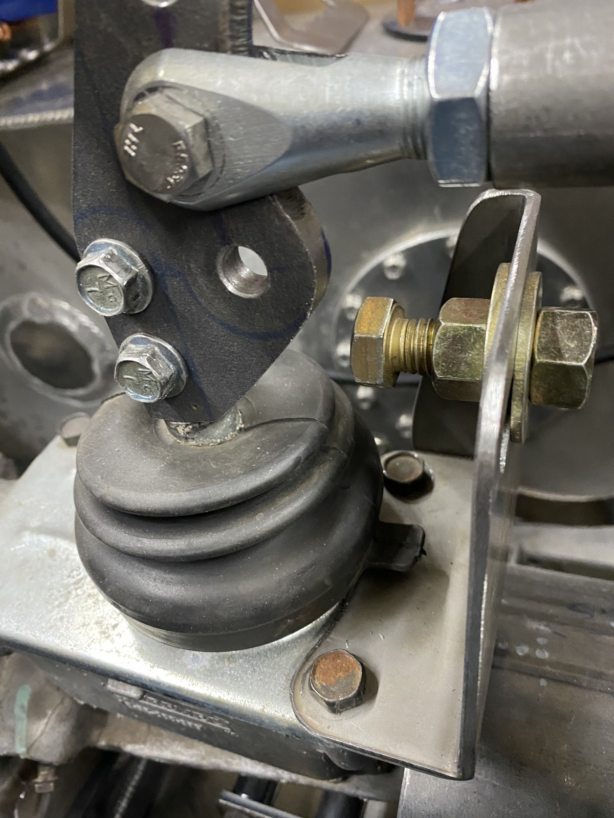

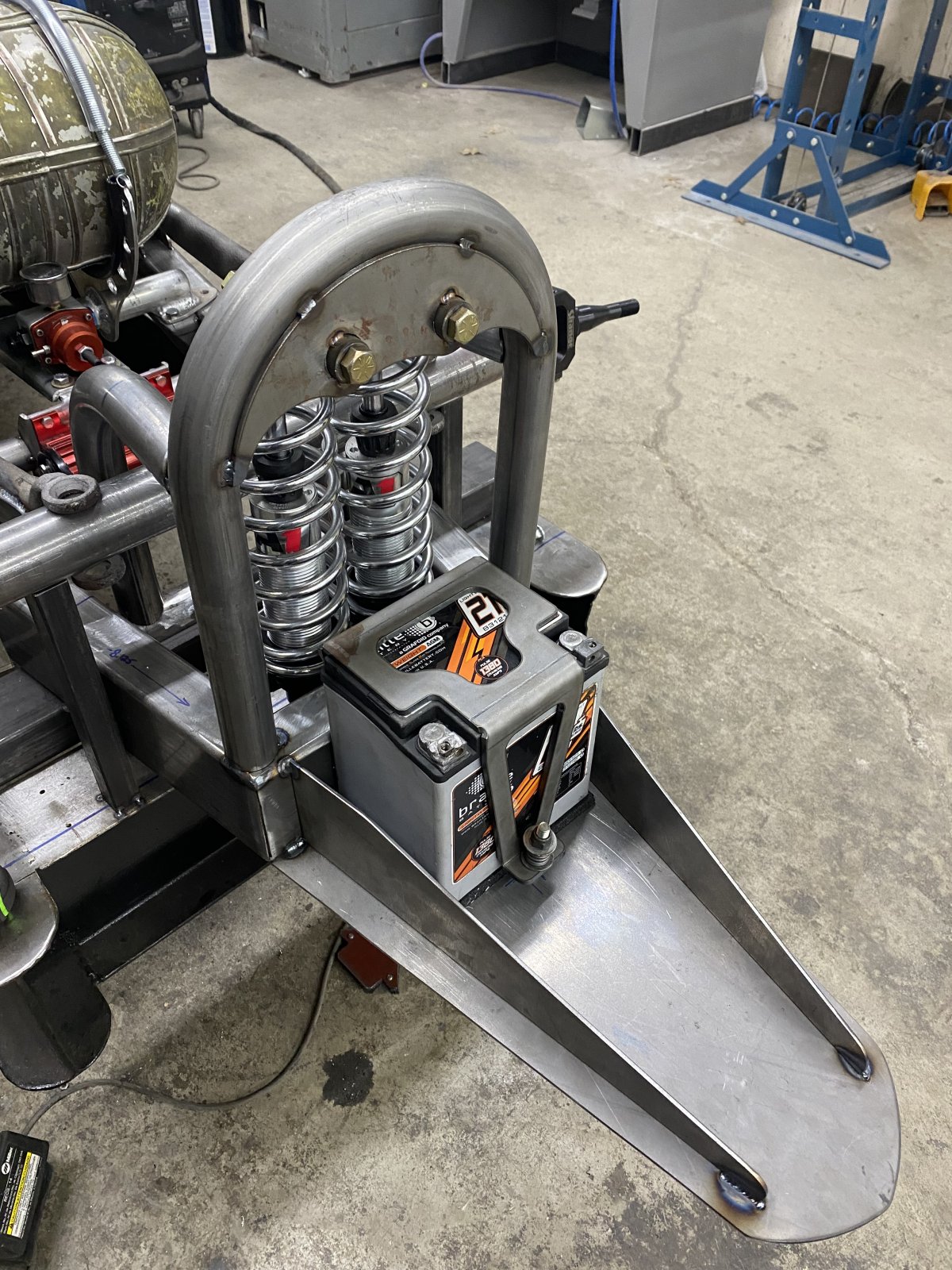

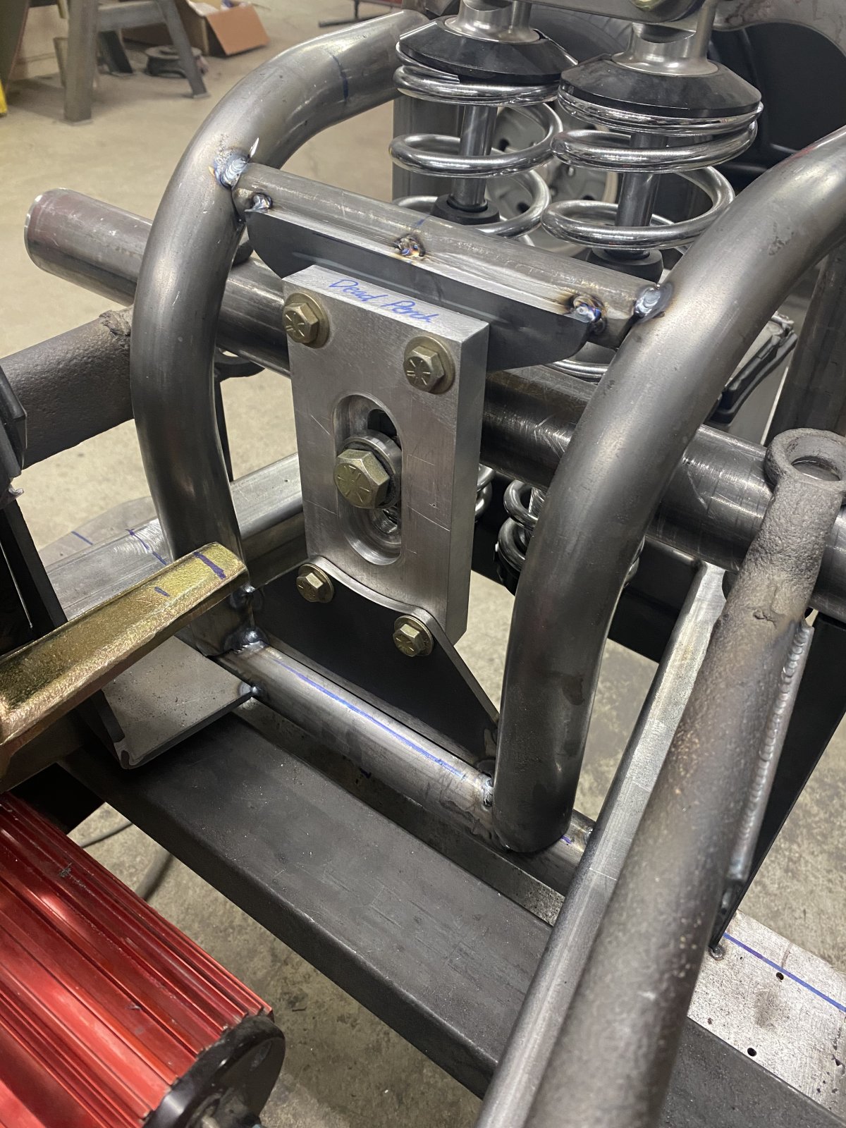

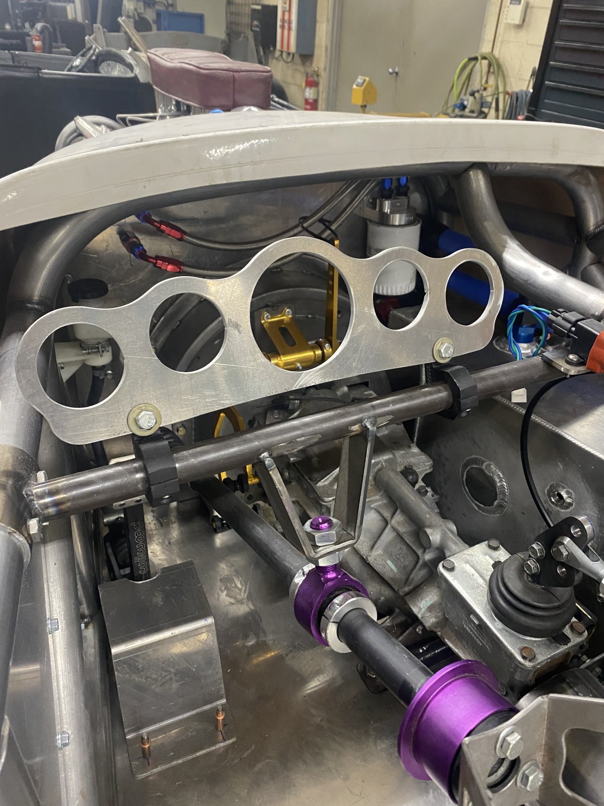

    Little update. Got the bump stop mount plate fit up and bump stops in, switches in, and 3 of the 5 gauges in the cluster 97A73C80-E079-41D1-BC93-5A357BEAB774.jpeg 65FFB12E-8BDE-4CC6-90D1-6114DC6157C1.jpeg CB6B22E8-40C1-4B40-A5E7-D1562927BF35.jpeg 932EE21A-588B-4584-A497-059AEB143AB7.jpeg

  22. Dedsoto
    Joined: Jan 7, 2014
    Posts: 376
    Dedsoto
    from Australia
    following, why'd the perch change it's name?
  23. cornfieldcustoms
    Joined: Feb 2, 2008
    Posts: 1,064
    cornfieldcustoms

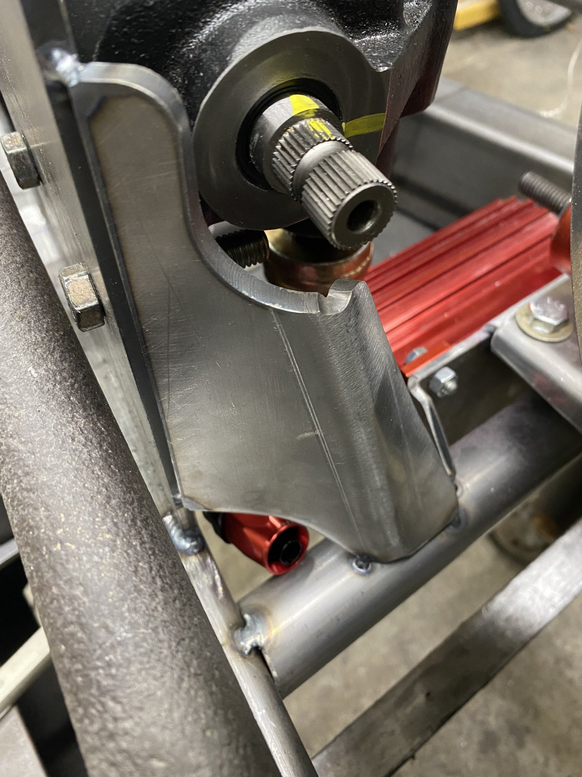

    a bunch of keyboard warriors on IG told me it would never work. So it is now a Itll Never Work perch
  24. krusty40
    Joined: Jan 10, 2006
    Posts: 872
    krusty40
    I can"t find my pics right now, but I did this on the 1429 RMR in 2013 when I revised the original cage and steering and added fairings to the front axle. I saw this method used on my favorite 5 window (Jim Busby's). His was like a tuning fork; I just made it a closed "racetrack" for a sealed bearing. Works great, with numerous records to show for it. The only thing was some wear over the seasons, which was corrected by making the racetrack a removeable hardened insert that could be replaced when necessary. Those folks who told you it won't work don't understand how the front suspension works.
    vic
    chryslerfan55, Dedsoto, Stogy and 4 others like this.
  25. Those are the same folks that have no idea how much history that type of locator has.
