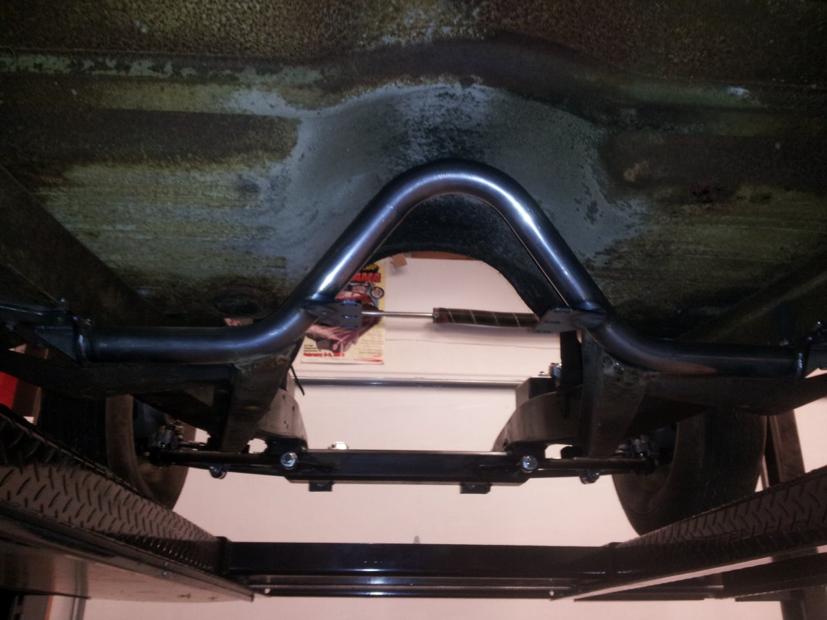

    wayfarer, it was a tough decision but I decided that to get it as low as I want running larger diameter tires I would need a notch.if it was a car I probably would have done a shorter one to safe limited trunk space, but since I had to go into the storage area and there is alot of room back there, what is a another few inches.

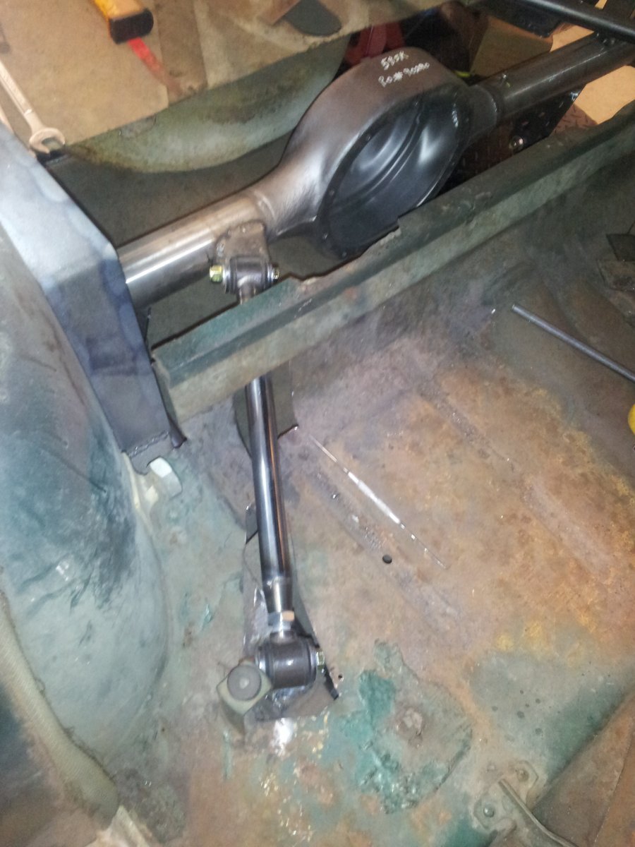

    after away from the project for two weeks while on a business trip, I got some time to work on the wagon again. Spent the day finishing up the 4 link install as well as notching the front frame to clear the steering rack. Next will be to install the front susp and then work on the rear airbag mounts. Nice thing about the wagon, the rear seat set up so the link will fit under it. (still have to build a cover for the links and rear notch..)

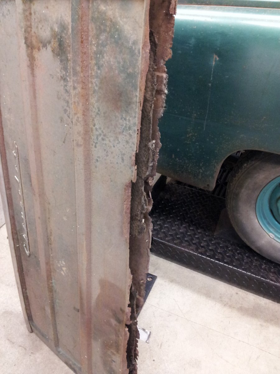

    Here is the tailgate that came with it. It was basically removed with a can opener it looks iike. This is why I am looking for a solid replacement.

  7. 55 dude
    Joined: Jun 19, 2006
    Posts: 9,357
    55 dude
    that looks pretty bad! if it was a sdn del. i could fix you right up!

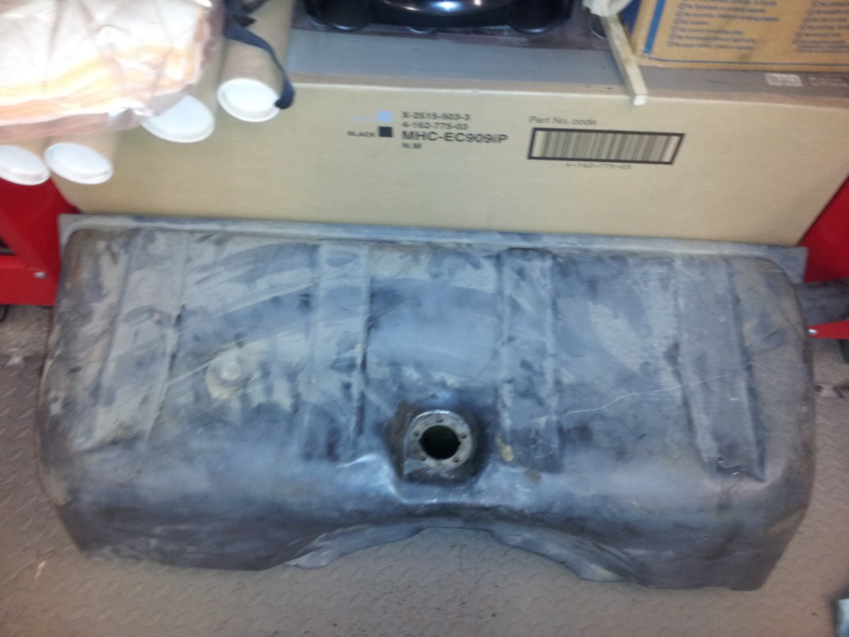

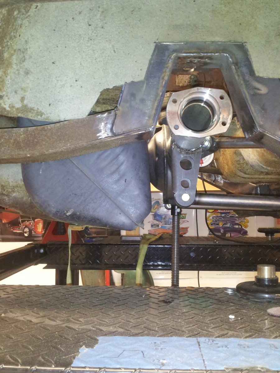

    Old gash tank was dirty inside so I attempted to clean out old fuel. Reproduction tanks for wagons do not exist but I found a 55 chevy tank is similar (same size but different location for sending unit). 125.jpg After some reworking of the front face to gain some necessary clearance between rearend and tank 126.jpg
    I have got the tank to fit between the spare tire housing and rearend. Unfortunately during my light taps with a 5 lb hammer I tore the tank in 2 space areas (about a 1/8 long) so I had to weld the creases up.

    Is it just the camera angle or is the tank hanging way below the frame? Mine is nowhere near that far below the bottom of the frame. I'll snap some pics of that hitch and the rear wood/ trim we talked about last week.
  23. Boones
    Joined: Mar 4, 2001
    Posts: 9,692
    Boones
    from Kent, Wa
    Its the angle, look at the spare tire area, its not that far below, plus the rear end is pushed up high (almost on top of the factory frame rails), well above anywhere it could be on a stock frame.

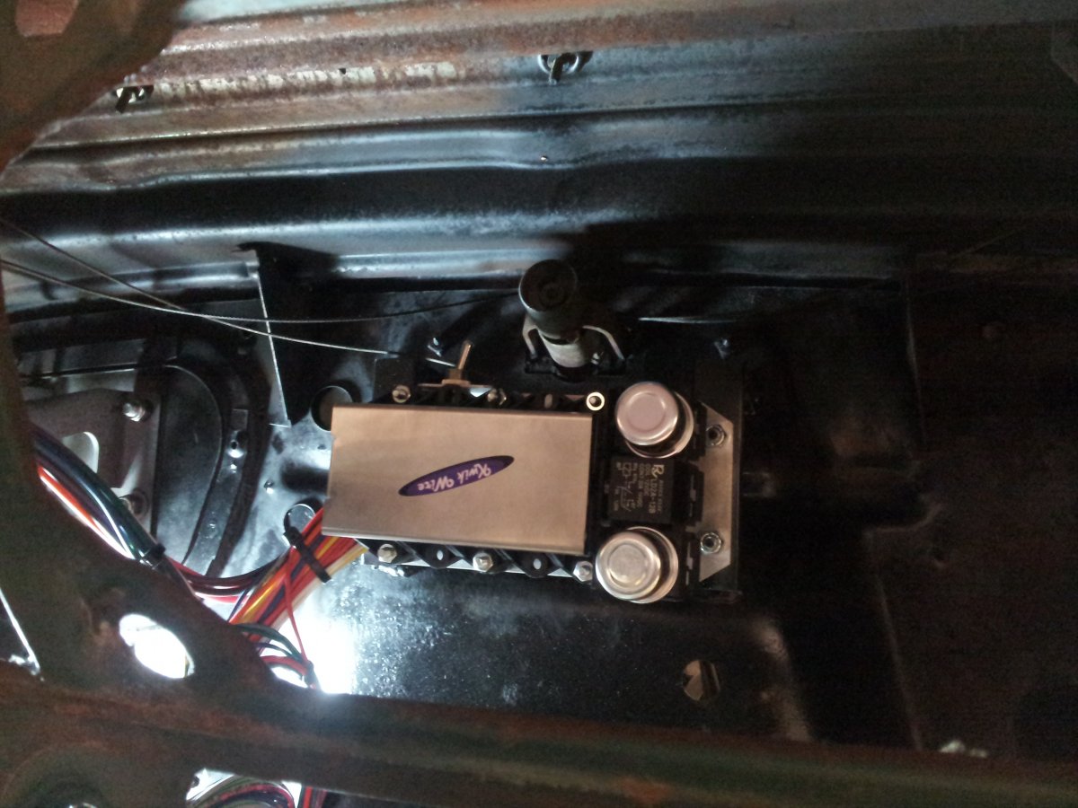

    Got my wiring kit in and started working on it Friday afterwork. After a long night I think I have 95% routed to the right areas and just need to start connecting. (its pull and zip tie, cut zip tie, reroute a better way, zip tie, cut and add other wires going in the same direction with another zip tie..

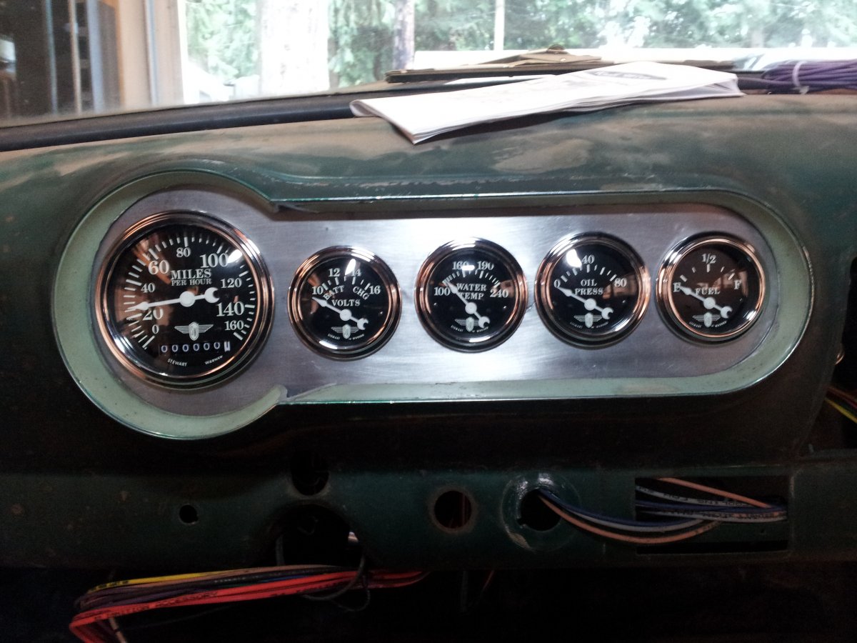

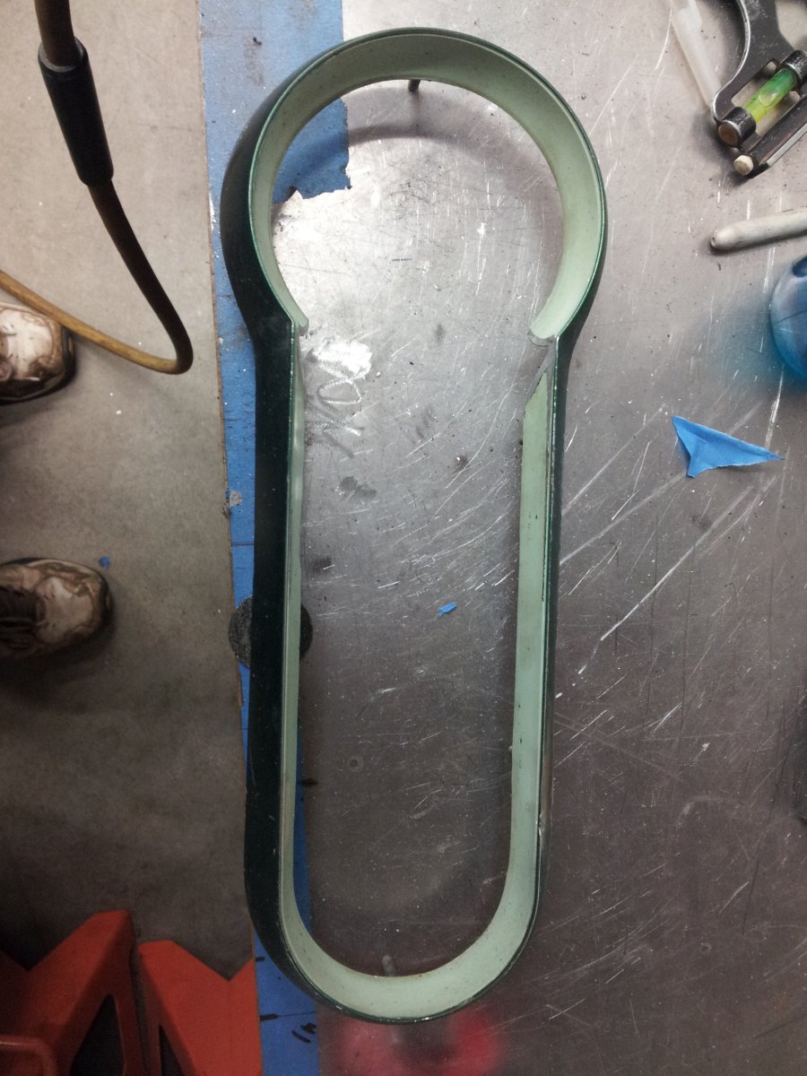

    Also spent some time working on the gages ( will send to the Chrome shop to have the open areas brazed and it chromed like my first wagon , will probably get some engine turned aluminum cut for the backpanel rather than just scotch brite.

  25. HOTRODPRIMER
    Joined: Jan 3, 2003
    Posts: 66,070
    HOTRODPRIMER
    Ken,Speedway Motors offers machine turned sheets in different sizes. HRP
  26. motoandy
    Joined: Sep 19, 2007
    Posts: 3,379
    motoandy
    from MB, SC
    Do it yourself with a wooden dowl and scotch brite pad on a drill press. DSC00571.JPG

    with the fuse panel mounted dead center but high up under the dash, 134.jpg nothing funnier than laying under the dash running wire. Got the headlight swt, Ign swt and gages wired and everything else is in the proper place awaiting connection.

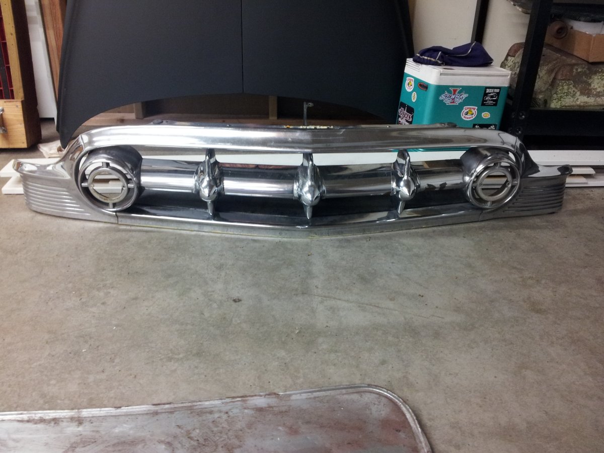

    Made a score this week while searching Craigslist, found a nice grill for a great price. the one that came with the car was in sad shape.. this one will be a good driver quality.

  30. 55 dude
    Posts: 9,357
    55 dude
    nice grill! SHINEY!:cool:
