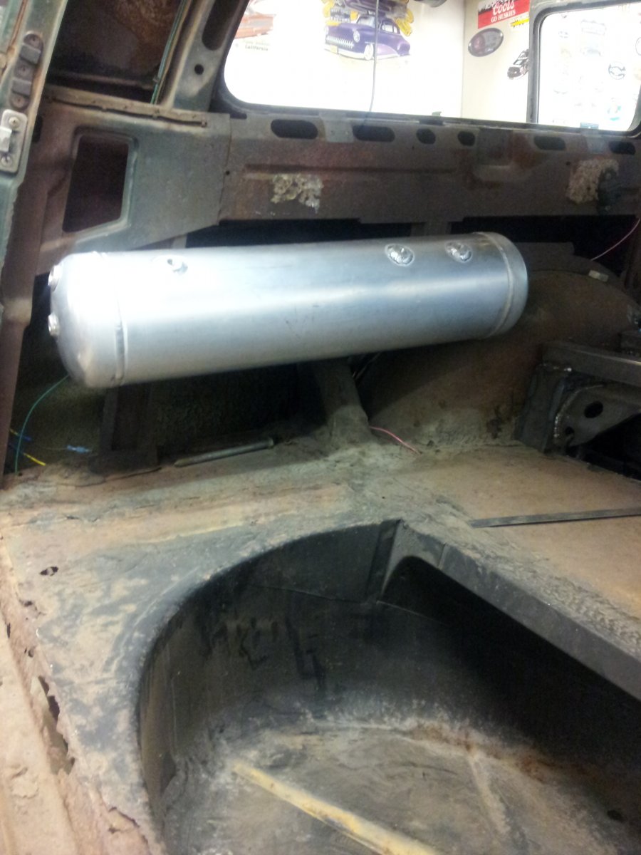

    Been messing around with my airtanks to see where they fit. I was originally thinking about taking the spare tire well and putting the two tanks and solinoids in there (and not run a spare or for long distance trips put it on top. Since I plan to run a tonneau cover over the rear it give me more options. Decided to hang the tanks on the side so I can put a spare in the right location and still have room for ice chest and other stuff on the rear floor. Standard placement, no but I think it will work.

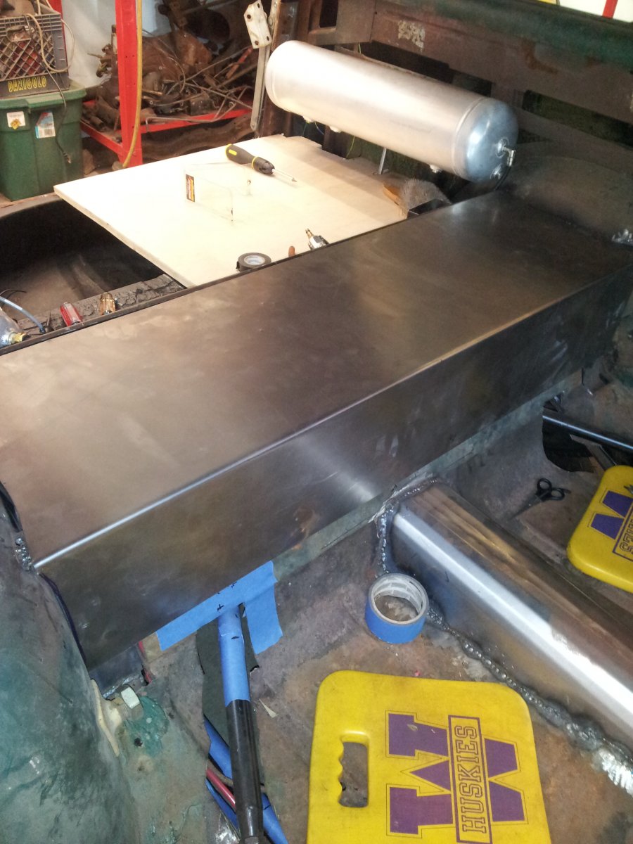

    Here is a quick Sunday night update. I built a floor for the rear (still need to cut out the spare tire hatch) but it looks so much cleaner
    also got the trans tunnel fab'd (thanks Alan for the help) and installed.
    next is fab'ing the rearend cover this week and start the accuair install.

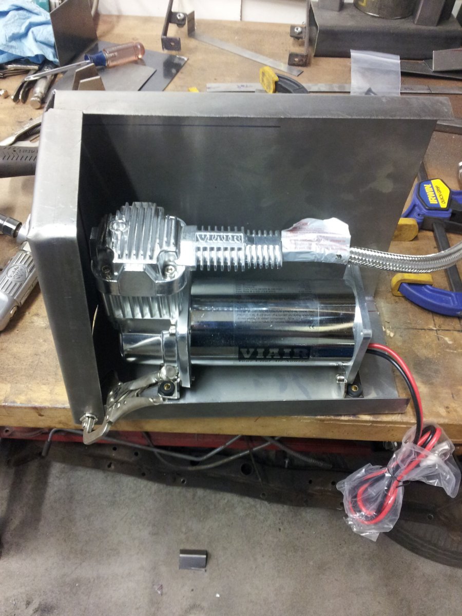

    Decided to mount the compressors up under the rear quarter panels The pumps can be mounted either upright or on its side but out of the wet mess. Built an enclosure with the rear open for fresh air (to cool pumps) but keep tire water from going in. What a pain this was, had to build an access panel in the end to get access to the attachment bolts (made a gasket to better seal it.

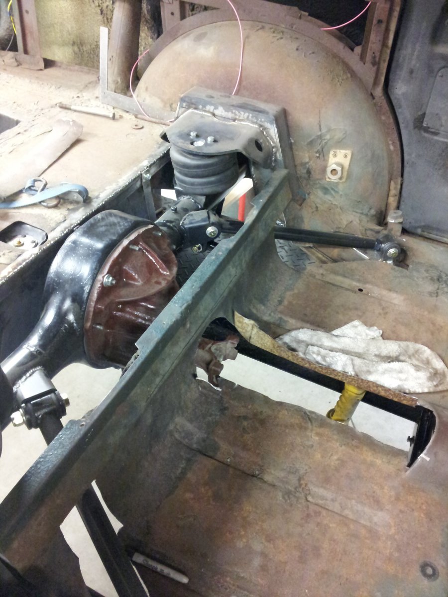

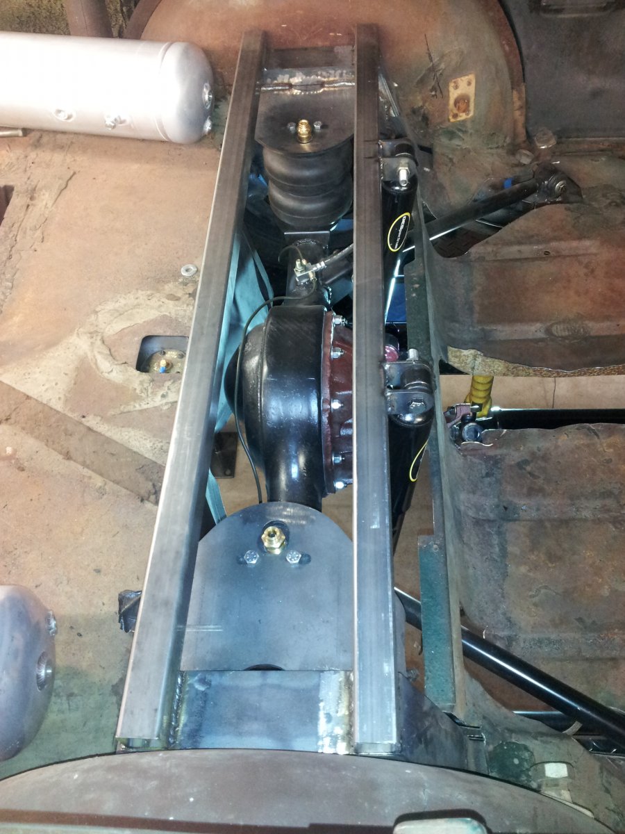

    Got the rear panel of the step notch installed and started installing the rear air ride

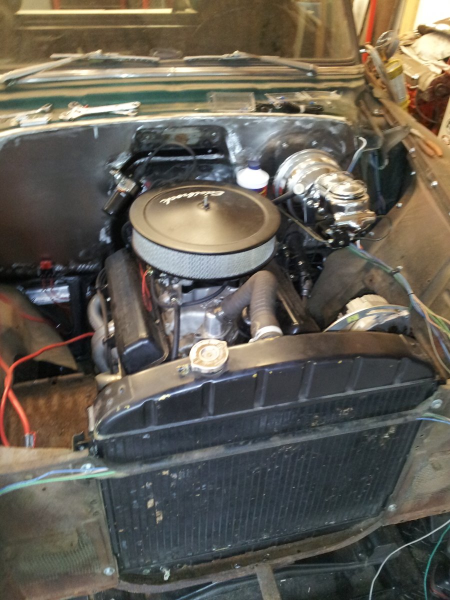

    starting to look like a car now. Replaced all the front sheetmetal hardware including some broken bolts and got it installed.

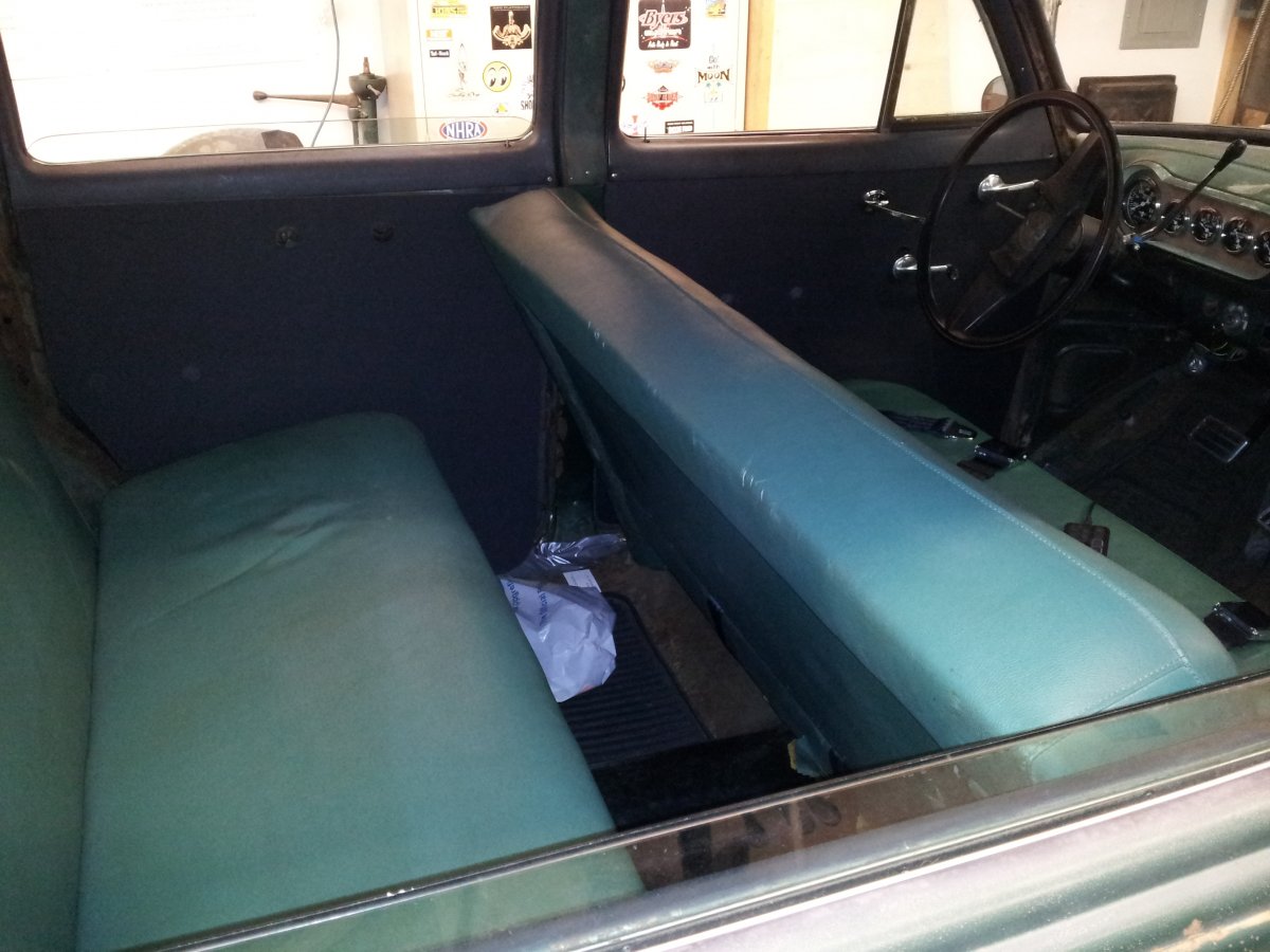

    quick update, 5 days before Goodguys and I am pushing hard. Got the motor to fire but spent most of the weekend troubleshooting a problem with my air ride set up. (still not fixed). got the rear panel over the notch fitted and the back seat installed. (not bad shape for 60 yr old material)≈ The wife actually helped by installed window frames, headlights and other misc tasks
    fabbing rear notch cover.

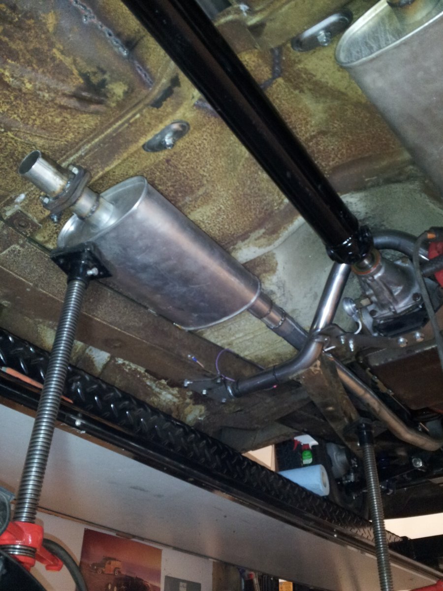

    Did build some exhaust for the car before its maiden voyage
    here she is ready to depart for the show (minus hubcaps as one kept falling off and I did not want to take a chance with my two NOS front covers.
    and proof it made it to the show
    The excitement was short lived. Barely made it home on Friday after the show. Car was surging as the tank is full of ****. (filter is brown). and I was not smart enough to put one between the tank and pump.
    now it back on the rack for more work/ repairs.
