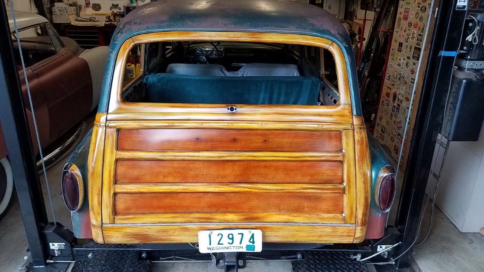

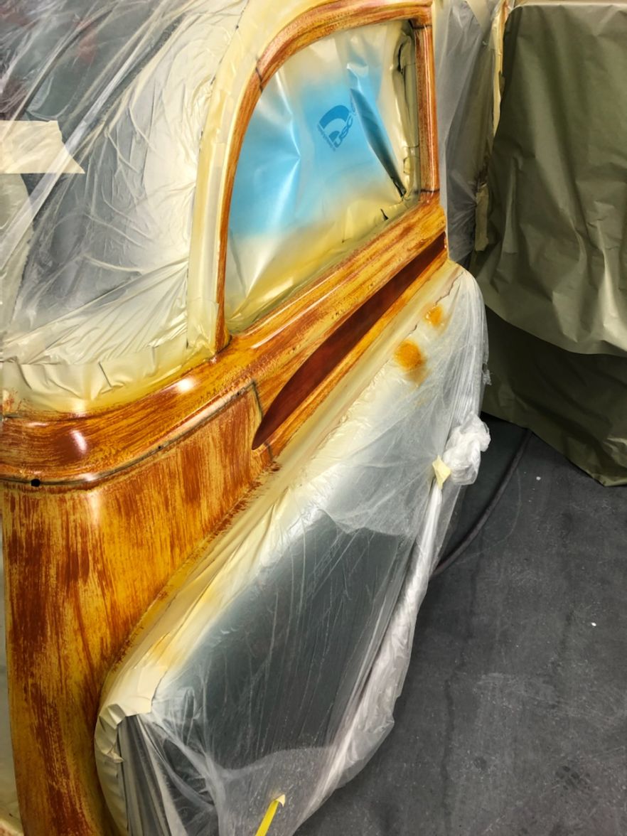

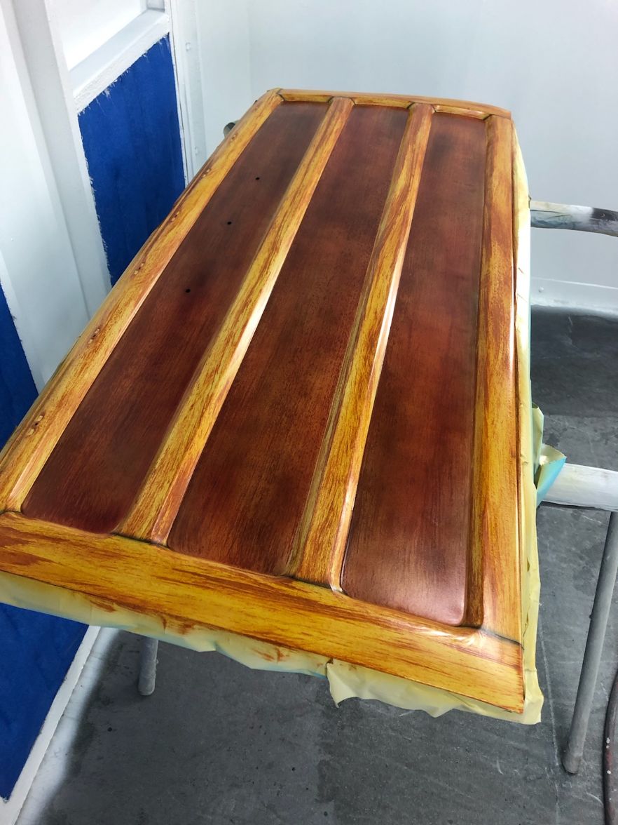

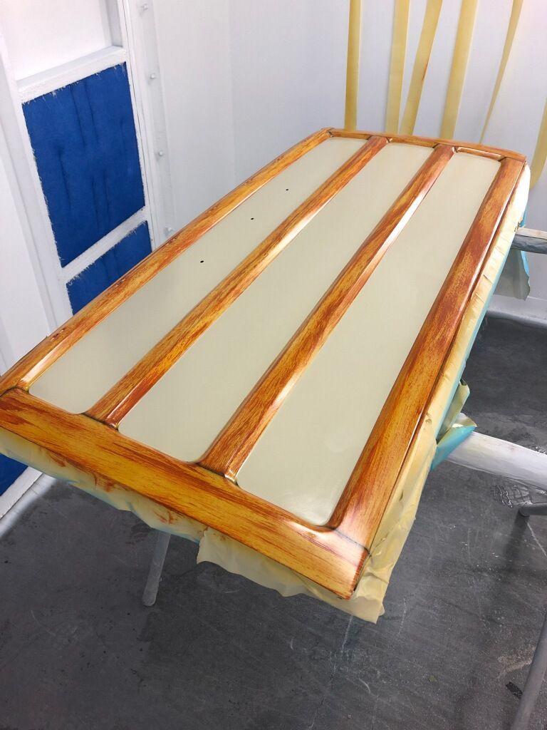

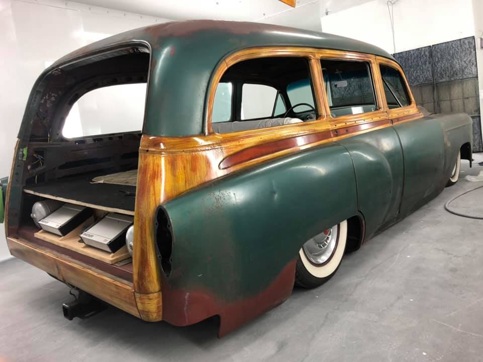

    We went with a semi- gloss clear as I am not a fan of painted wood grain done in shiny gloss as it loses some realistic feature. I never seen real wood that is that shiny on a real woodie.
    Tman, pwschuh, Mtn Goat and 4 others like this.
  3. The woodgrain is amazing!

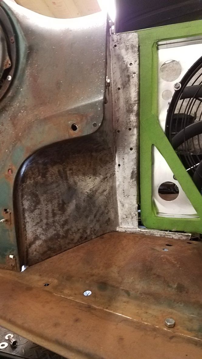

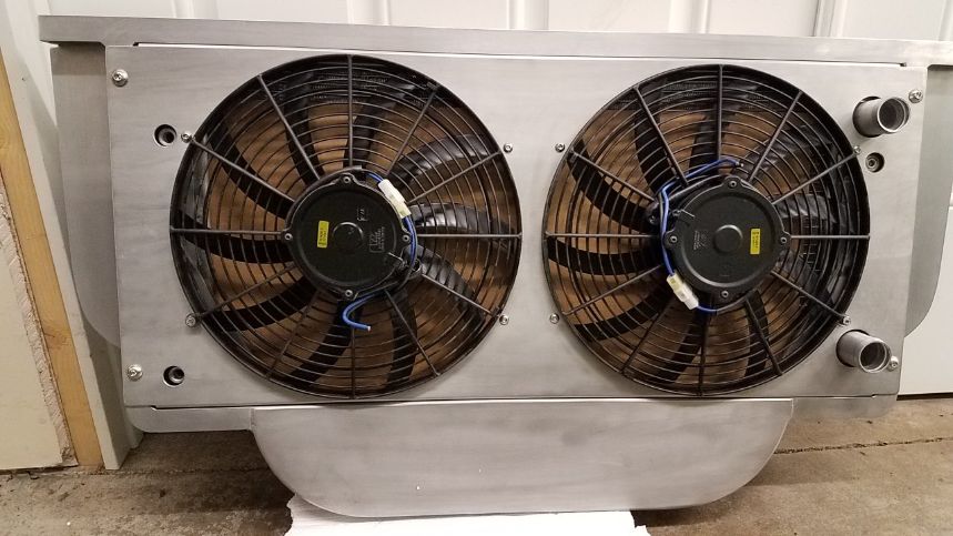

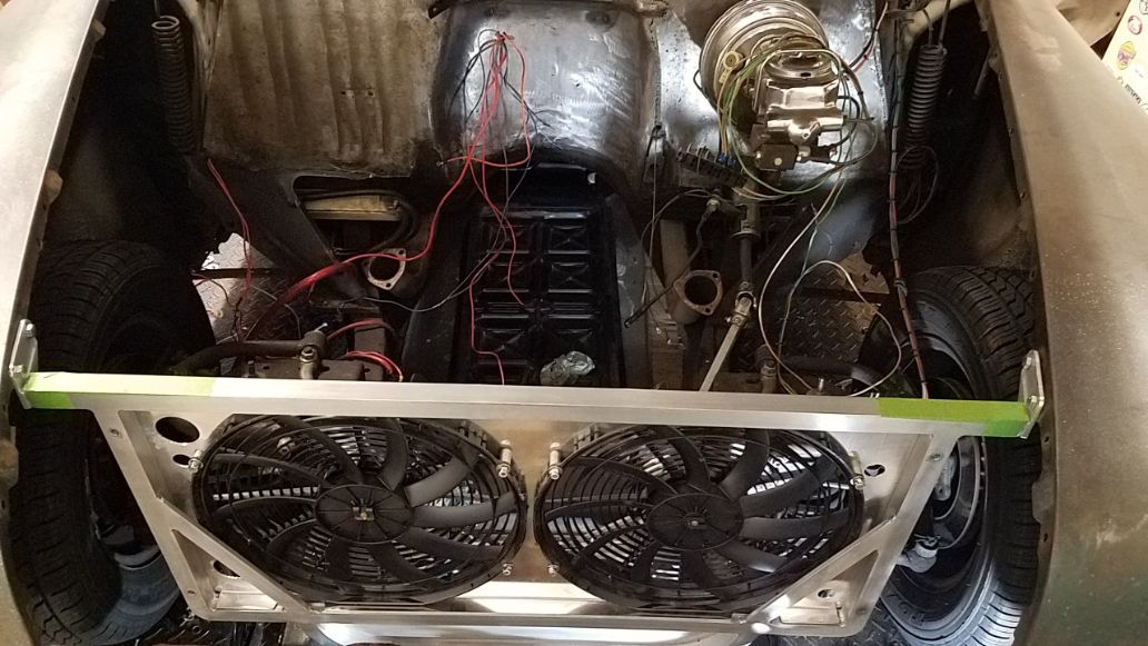

    Now, about that overheating in traffic, time to find a permanent fix. For me that meant upgrading the cooling system. I did not mention but on my last trip to CA, my electric fan rubbed a hole in my core and it started to leak, causing it to run warm (I was up in the siskou mountains with nothing near by). I did make it to Redding after stopping a few times to refill at rest stops and found some leak stop that got me another few hundred miles. about 2 miles from my parents the radiator let go. I rolled into their driveway at over 220 degrees, going 60 down a 25, popped into neutral and engine turned off. coasting into their back yard where my dads shop is. Luckily the next day was turlock swap and I found a nice 2 core aluminum replacement and no damage to the engine it got me thru the rest of the week (Goodguys West Coast nationals) and back home towing the teardrop/

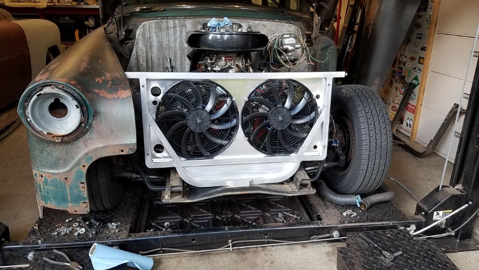

    I went and had a custom radiator support built (similar to those found on higher end 55-57 chevies) that will hold a radiator that is almost double the size and will hold two 13" electic fans. this one has a shroud.
    Somewhere along the process, the new support came out alittle taller, not sure why when it was jigged against a stock radiator support and it looks to be similar when measured but after installing the fenders I could not get the gaps to fit, headlights were sitting high. I decided it might be my frame/ factory crossmember had been damaged along the years (not sure how when factory sheetmetal has great gaps but I got fired of trying to make it fit so I reversed engineered the crossmember and built a new one that was much stronger and allow me to lower the mounting point of the cradle and have adjustment to raise as needed. It also gives more clearance to the ground (thinner but thicker material)
    664.jpg Due to the wider support, I have had to modify the inner fenders (still in progress) but got the front corners done.

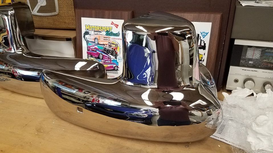

    last update to bring up current. sent a some items to the chrome shop and now they are all back. Rear bumpers, overriders, wiper escalons, wing window frames and a few misc pieces for the interior. I have another pile of pieces going out shortly. Now everything external has been replated exept the grill (that is soon) and most interior pieces I want done. (some tailgate hardware remains)

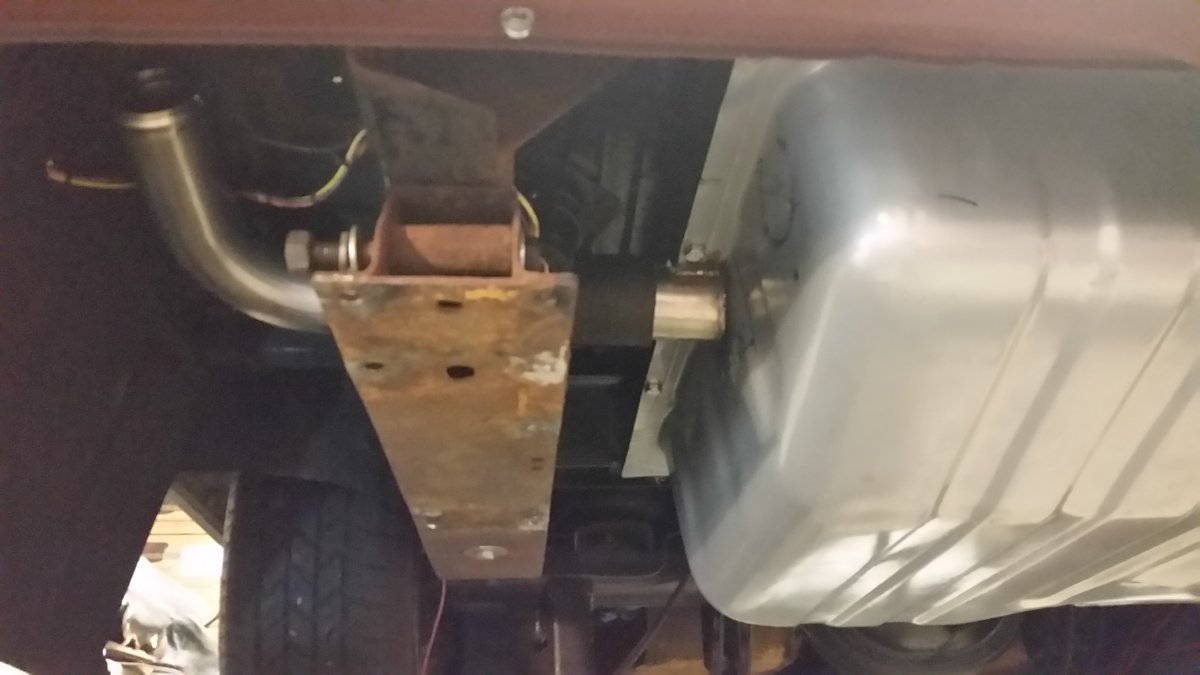

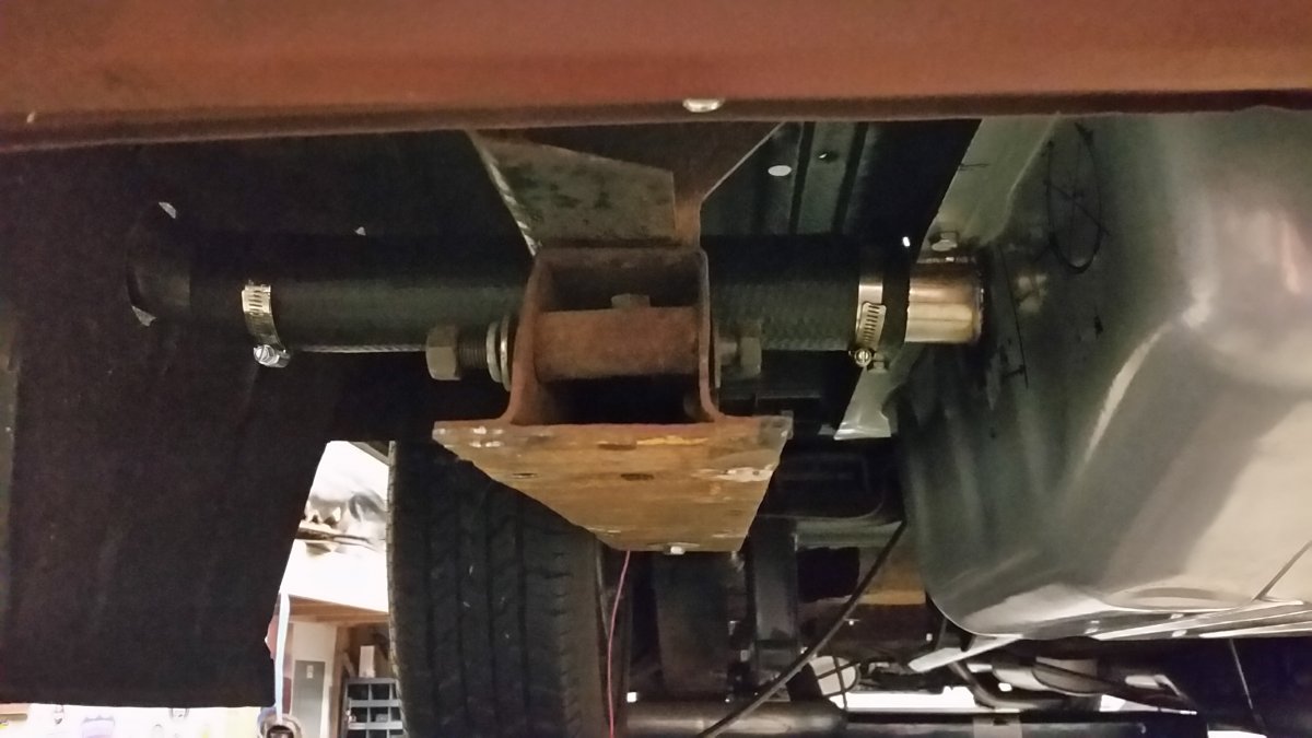

    Ken, do you have any pictures of how you ran the filler neck with the hidden filler? I know you have another tank now, but I have had the taillight filler kit for years and haven’t been able to figure out a good way to route the neck and vent it.

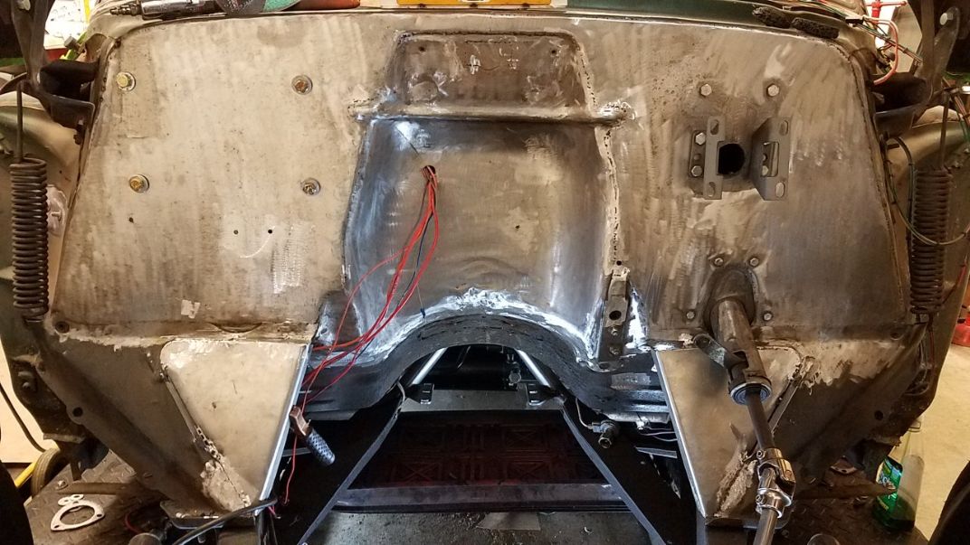

    Got some time to work on the wagon this weekend. Took an old battery box I bought at a swap for $5 a few yrs ago and cut it up. moving mounting location and resizing it. It is now in its final position. Then took some time to fab some filler panels for the body brace. I had cut it up in the past to fit the headers for the old sbc, with a newer engine going in I am going with Cast manifolds (tired of leaks).
    I need to do some more welding of old holes and it should be close to being able to body work the firewall and paint it.

    Wayfarer, I do have several pictures of how I did it. (all build pictures are on my website.) but here are some that might help. I bent some wire and had an exhaust tube amde to go over and up (with bed on the end) above the frame (below the body) . you might be able to possibly take stock tube and rotate it up towards the taillight and then run a rubber hose. I built a filler next (out of a 40 ford I think but it might be something else (I do not remember but there is a pic below. I added a breather port.
