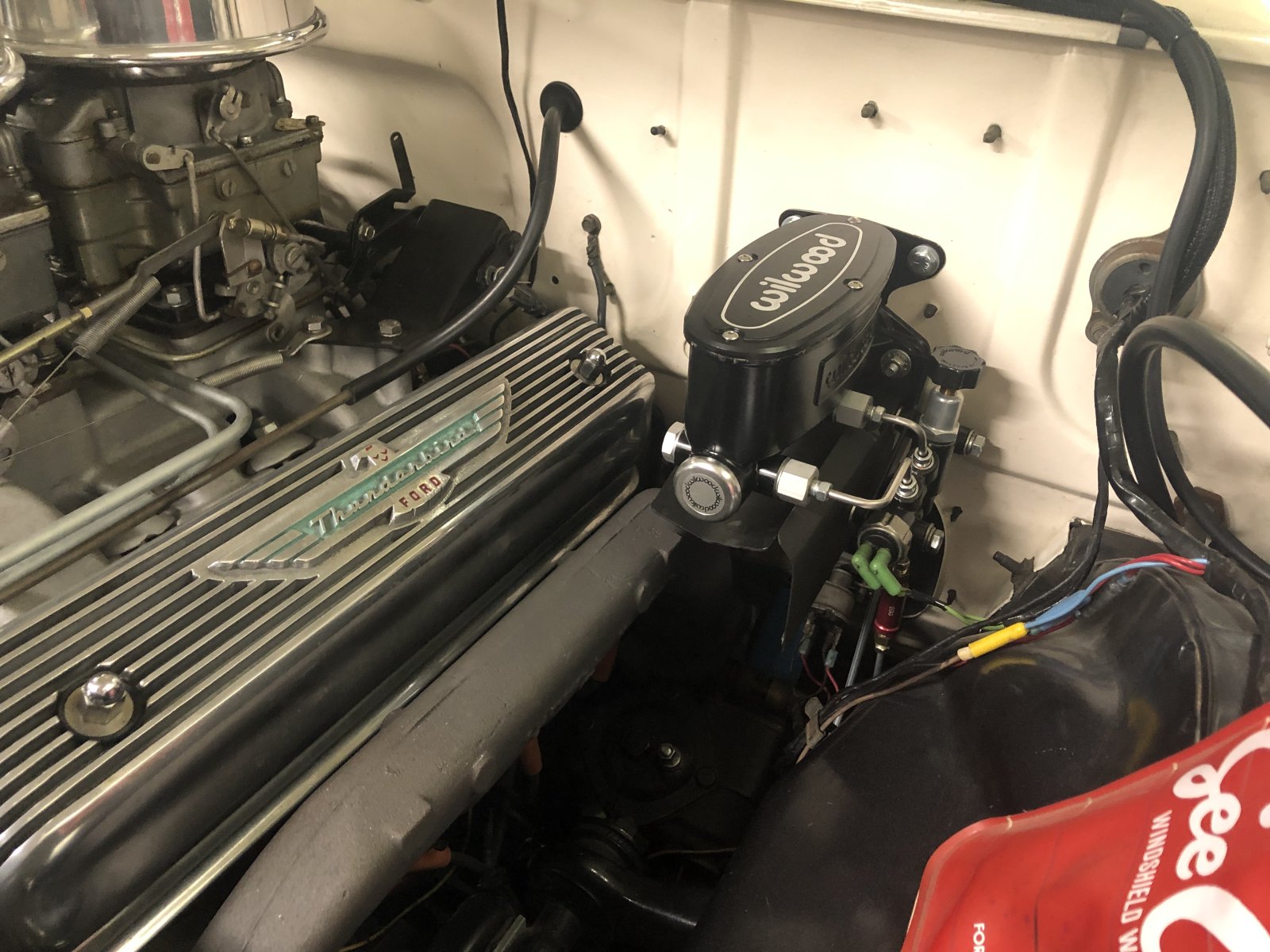

    Put the rod in the top hole, use a 7/8” master cylinder and remove the ugly vacuum can from the firewall. IMG_3484.jpeg
