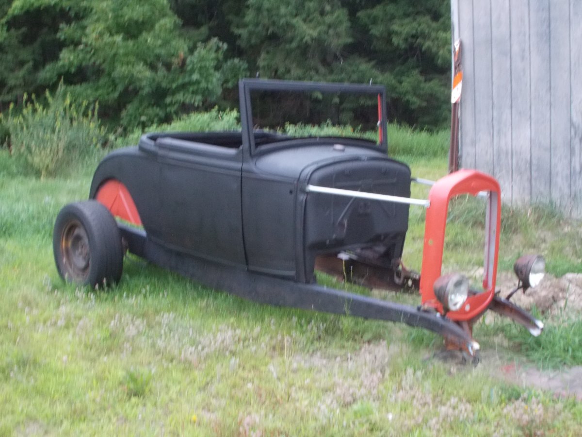

    made a 1" by 2" rectangular steel w/s header...
    a buddy [electrician] bent some conduit for me... made the main bow and the forward tilted bow by bending 90*s as tight as possible...
    went to a boat shop and bought every fitting I needed, coupler, clevis, pivot, etc...
    tied the 2 bows together with 2 canvas straps that had loops sewn into both ends...
    tied the main bow [down / back] to the floor with ratchet straps...

    Was that a Coupe Originally?

    truck cowl, tudor doors, '29 rear quarters, lasalle ****pit combing...
