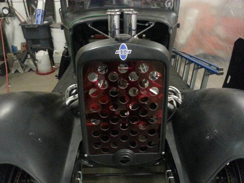

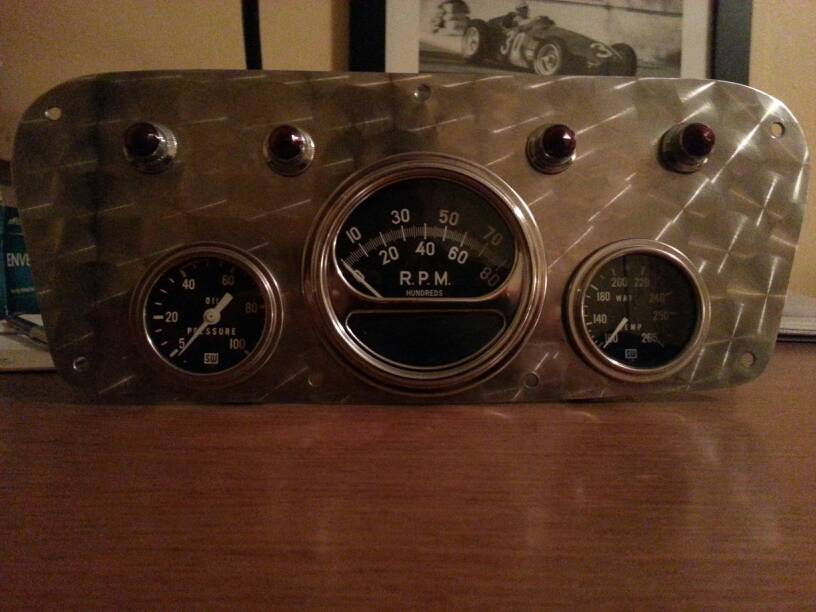

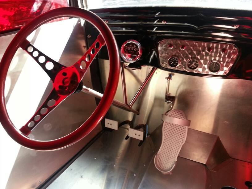

    I made a little progress...I modified my dash insert to hold my tach since I no longer needed a fuel level gauge...saving a little weight too:eek:

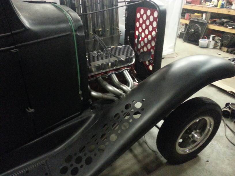

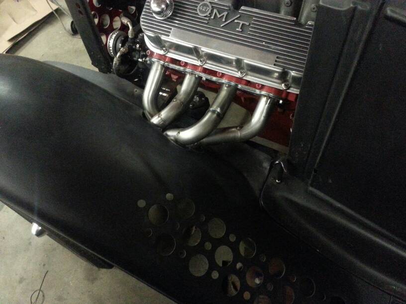

    I finished tacking up the headers...I still have to add about 5.5" in length and fully weld the tubes and collectors, but at least the hard part is done. I still need to trim the fender openings so I don't start the fibergl*** on fire.

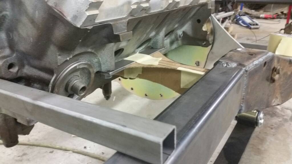

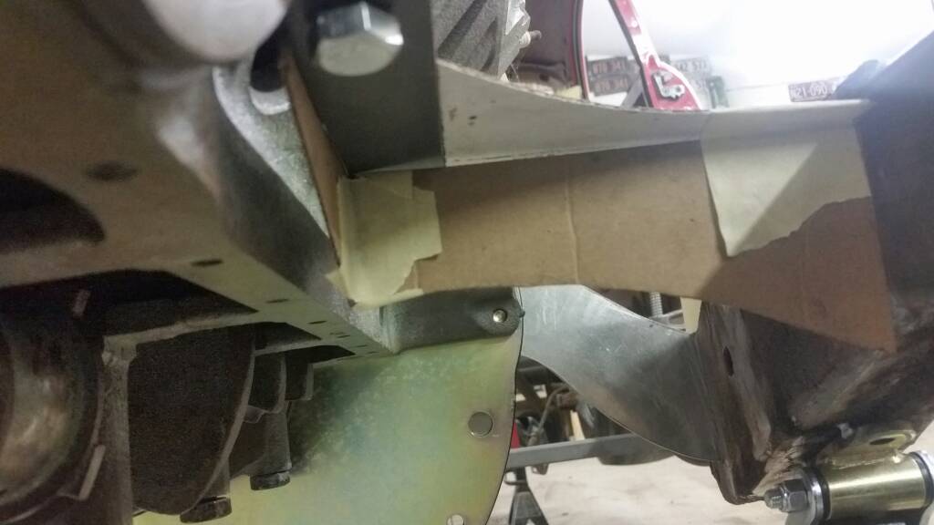

    Got the motor mounts made. Made them out of 1/8 4130 took a few try with cardboard before I got something I liked and can handle the power. I hate the way ford blocks are they made the bolt holes so far apart.

    Cut them out with a 4 1/2" grinder and smoothed them on the belt sander then welded th together

    Kip! Love this car, coming along great. I really like that grill insert! Is it plexygl***?
    II FUNNY likes this.

    Thanks...and yeah its lexan.
    Two years ago the whole club spent two weeks straight in the shop putting the car together to make the meltdown. Jeffery and my brother got stuck laying out and drilling the insert.lol

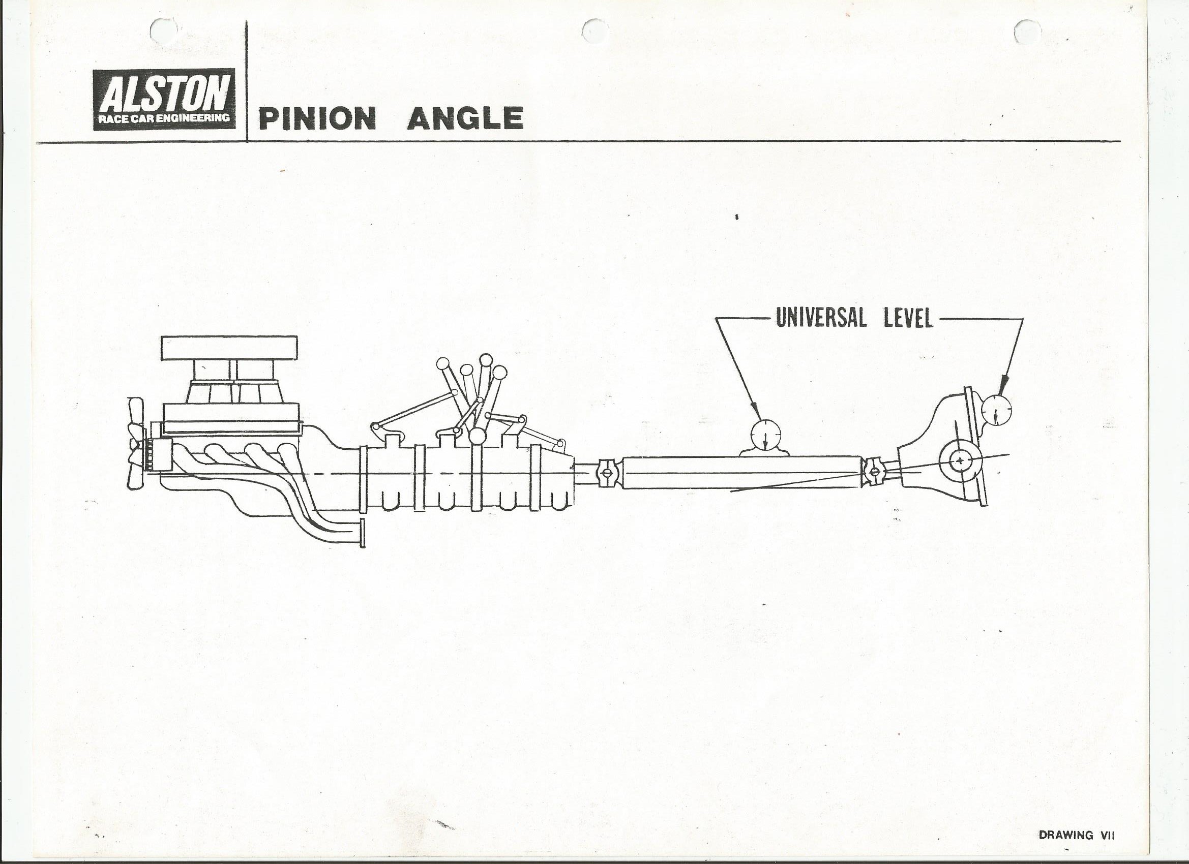

    Hey Ric or Quain...what should a ladder bar car have for pinion angle...I was always told that it should be set -2-3° from what the output shaft is.
  21. I think ours is 3 or 4 degrees, I need to check to make sure.
  22. Dog_Patch
    Joined: Nov 12, 2007
    Posts: 5,133
    Dog_Patch
    I asked Quain this specific question and he told me 1 degree off from the crank center line so that when everything compresses at launch it will be zero. That's just what I recall him saying, I didn't write it down and have not gotten that far along yet to see how that will work.
  23. Saxxon
    Joined: Dec 14, 2008
    Posts: 1,835
    Saxxon
    I resemble this remark !
    The work you guys are doing is great. Makes me feel guilty about the neglected and all but abandoned junk in my sub zero garage and the shop.
    91whitestang and II FUNNY like this.
  24. II FUNNY
    Joined: Jul 31, 2010
    Posts: 1,840
    II FUNNY
    So that would be one degree negative from the output or crank centerline.
  25. saltflats
    Joined: Aug 14, 2007
    Posts: 13,633
    saltflats
    from Missouri
    Just showing how smart I am not but wont a ladder bar car rise the rear end on launch.
  26. saltflats
    Posts: 13,633
    saltflats
    from Missouri

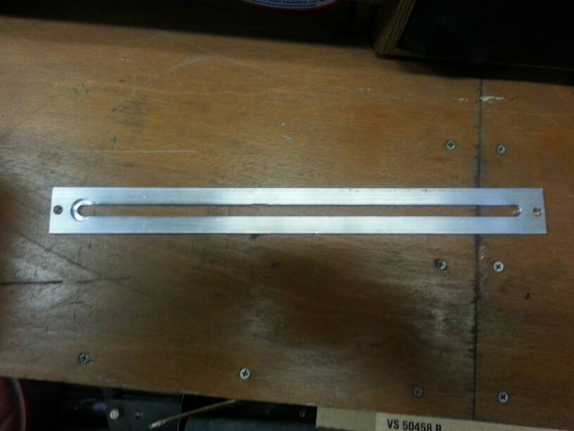

    I've been trying to figure out how to make my plexi side windows go up and down....I think this will work good and will be way lighter than the stock regulators.
  29. II FUNNY
    Posts: 1,840
    II FUNNY

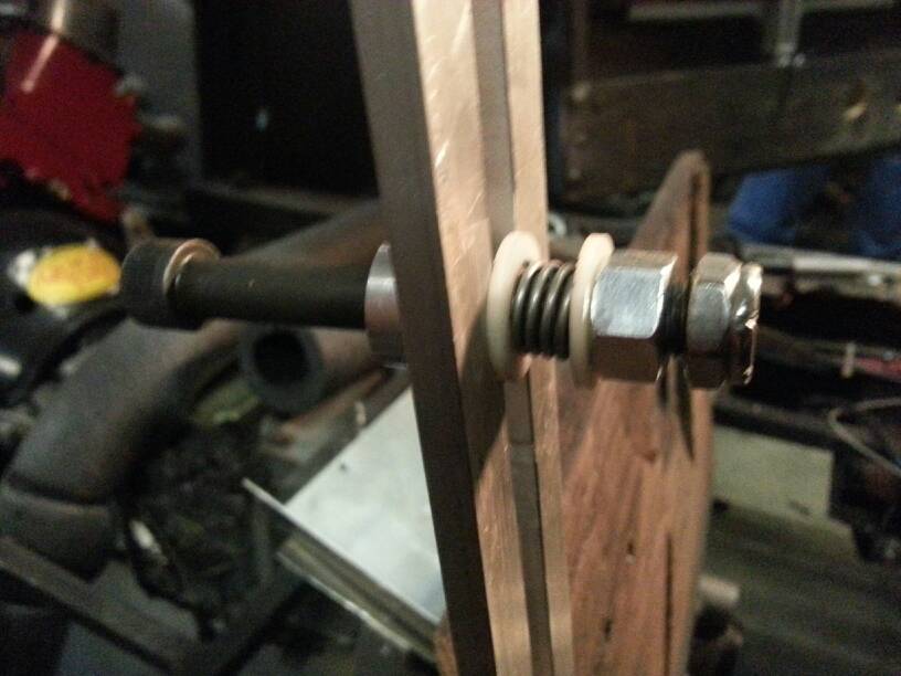

    I first made up the slider and the plate it mounts in...here you can see the counterbored part in the aluminum mount...that way the spring will hold it into place and keep the window up.
    saltflats and powrshftr like this.
  30. II FUNNY
    Posts: 1,840
    II FUNNY
    I then had to slot the wood in the door and hook the plexi to the slider...
