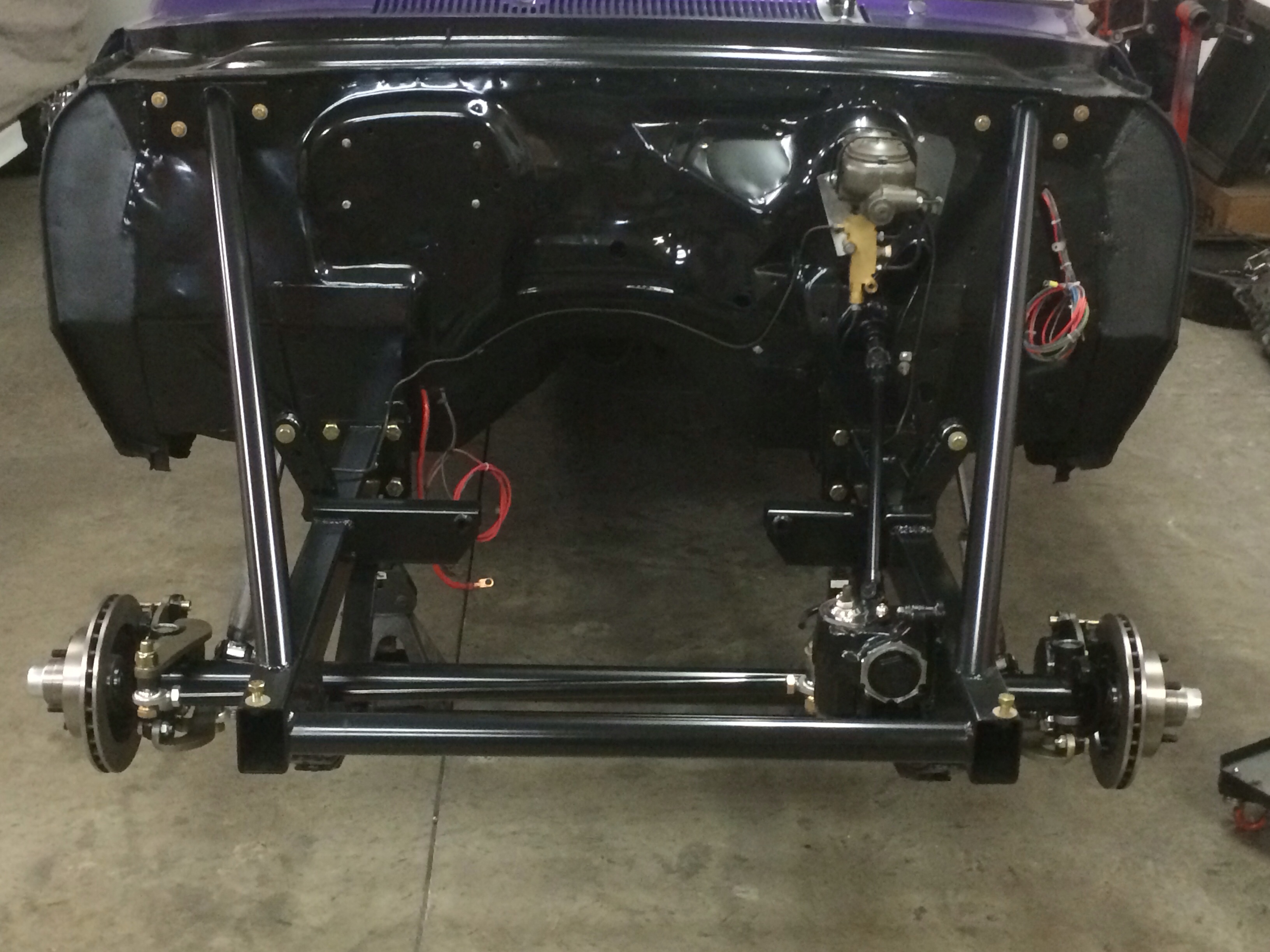

    from illinois
    Thanks to all the help from the Bandits!! Couldn't have done it with out them, it's coming together lots more to do, the shaker is coming together as well thanks Scott.

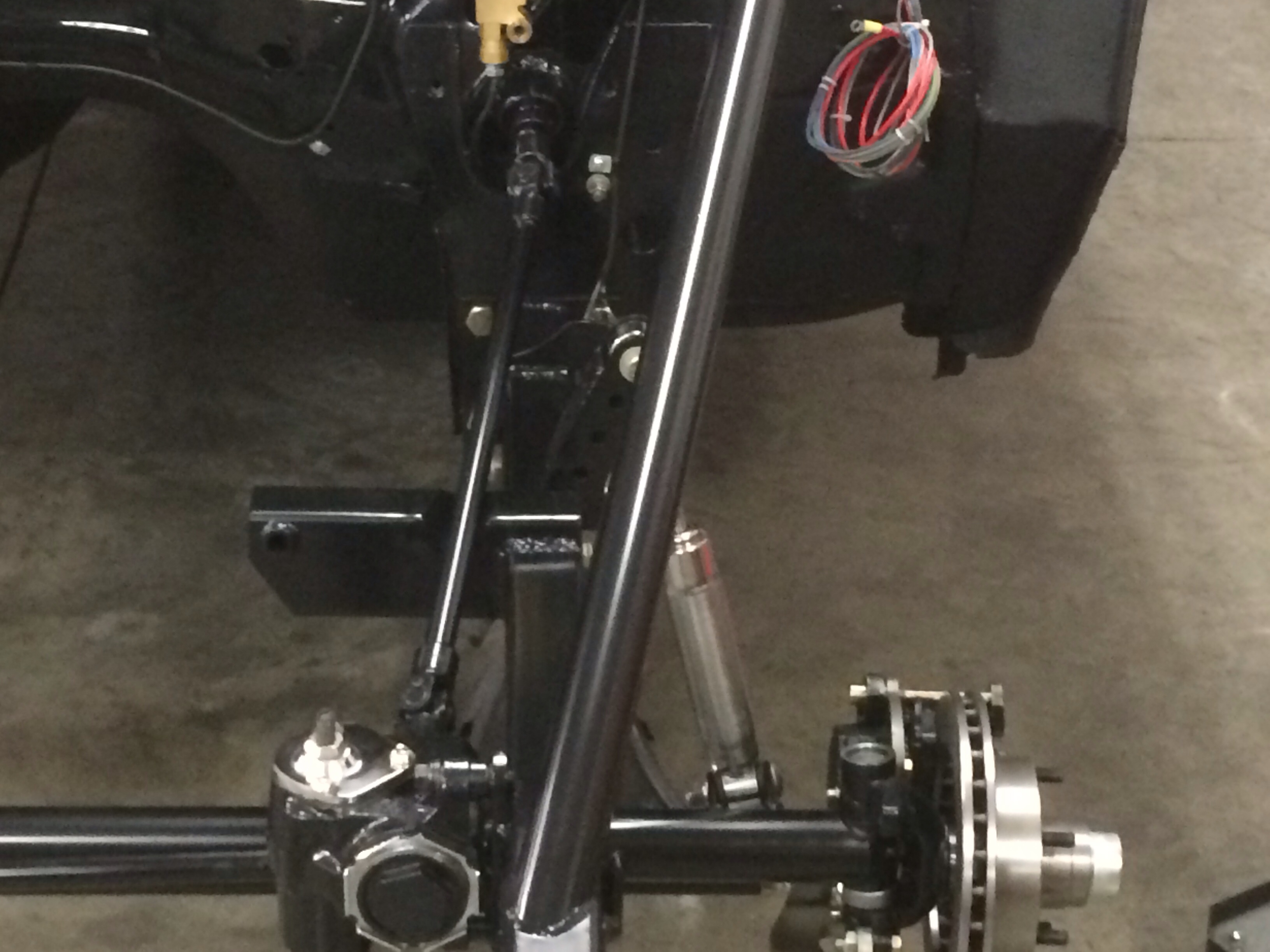

    Ps:Art,the workmanship you guys are doing on that front end is absolutely outstanding!:)

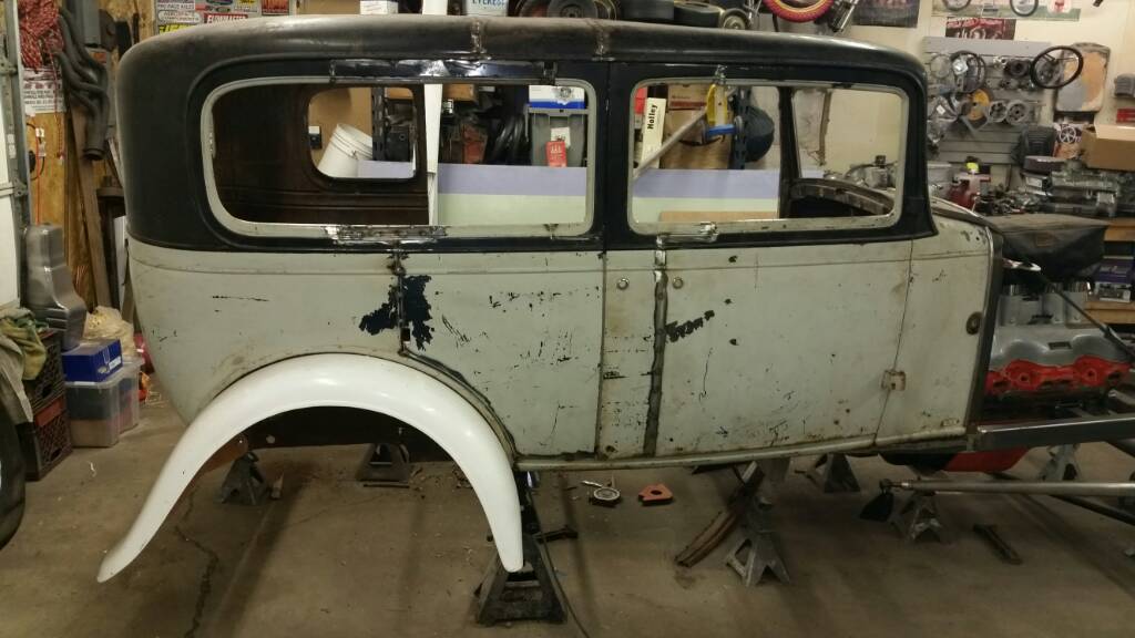

    Here's some pics of the progress make in my shop. Striped all that old wood out (that's weight), lengthened the front door to 2dr specs and got 1 quarter tacked together. No more 4dr. Sorry Ric I couldn't do the 4dr thing. Now that the holidays are over its full speed ahead.

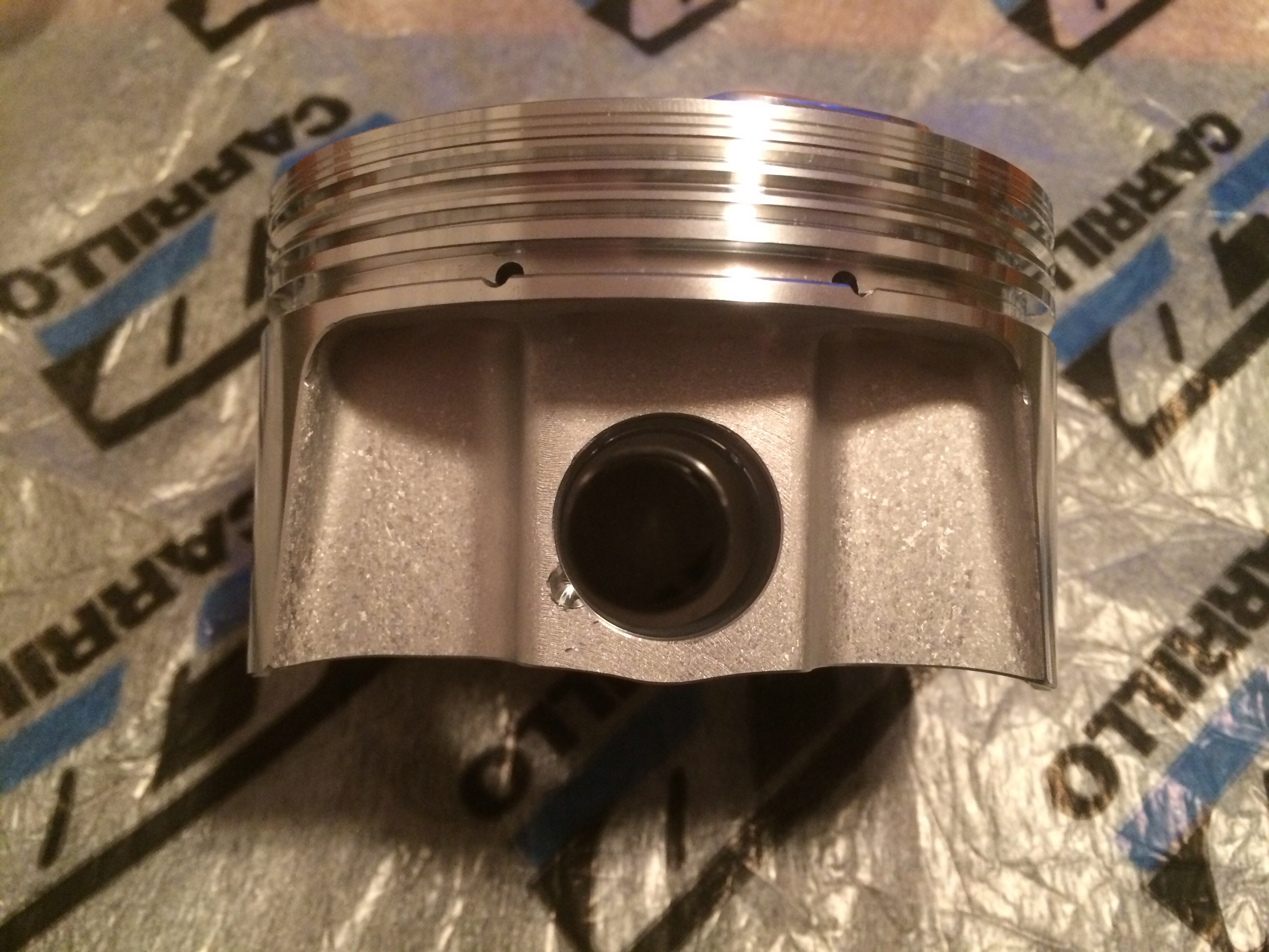

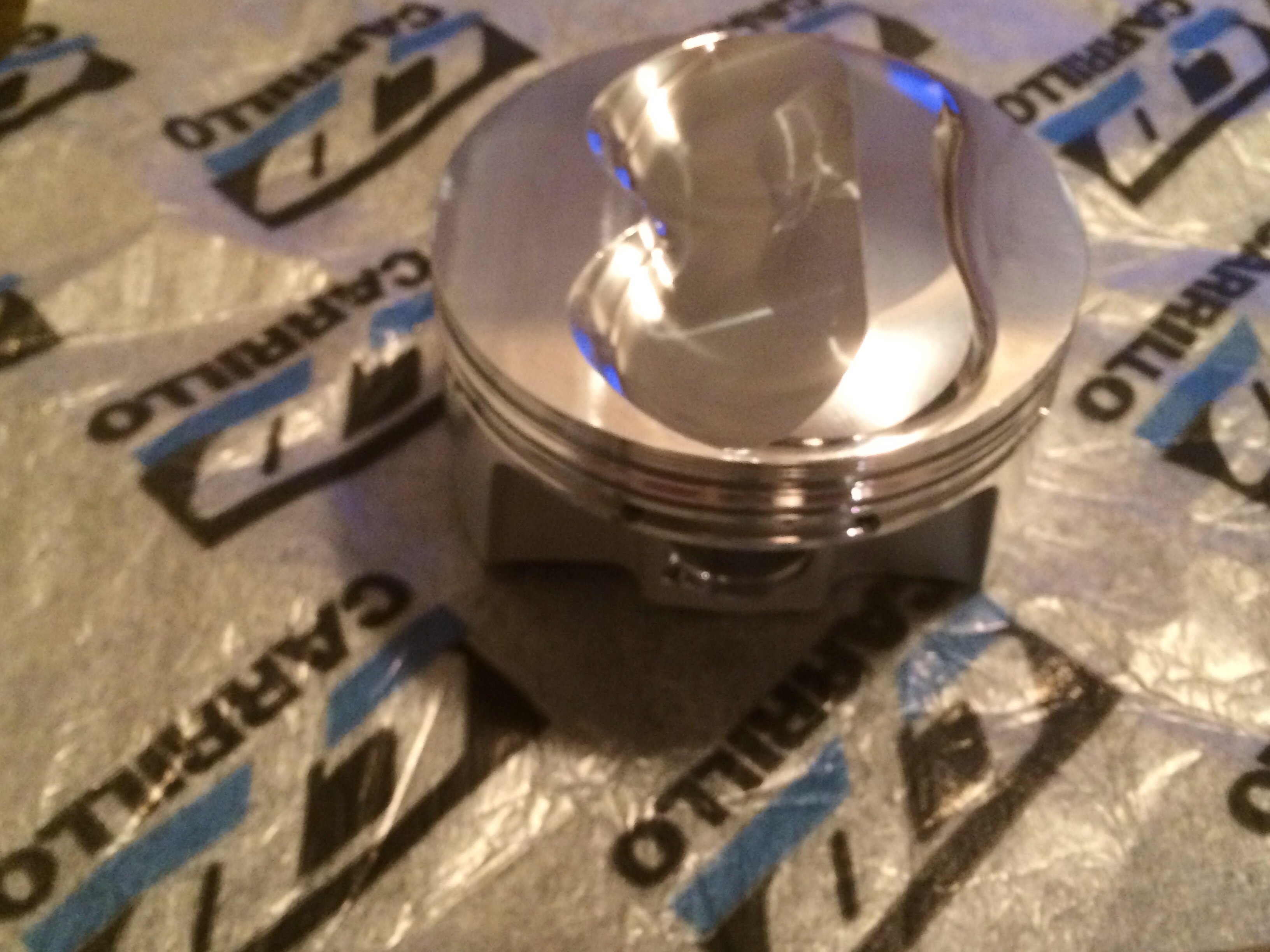

    That pin height looks kinda far from the crown but I am just watching

    Not sure what u mean salty?

    Standard 5.7" rod 355ci SBC

  15. The short skirt length is faking you out Salty, makes it look like a 327 piston.

    I guess that's it Ric. Just use to seeing the wrist pin in the ring pack or damn near any way.

    Painters touch paint primer all in one, local ace store canyon black? It works well.

    Beebee78, Nice job with the paintwork on the front end! I thought maybe you had em powder coated when I first looked at pics! Must be some good paint! Jim...

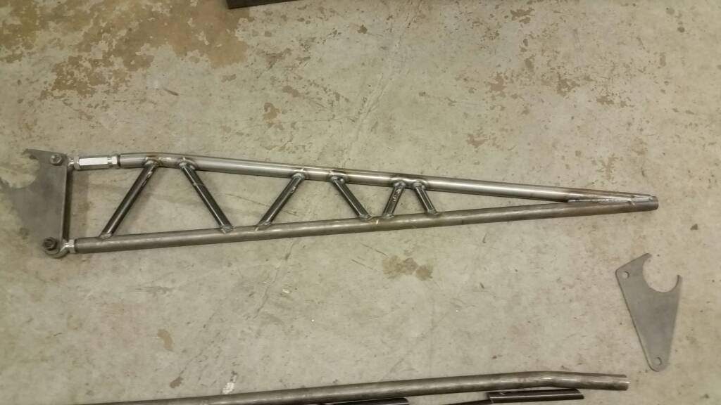

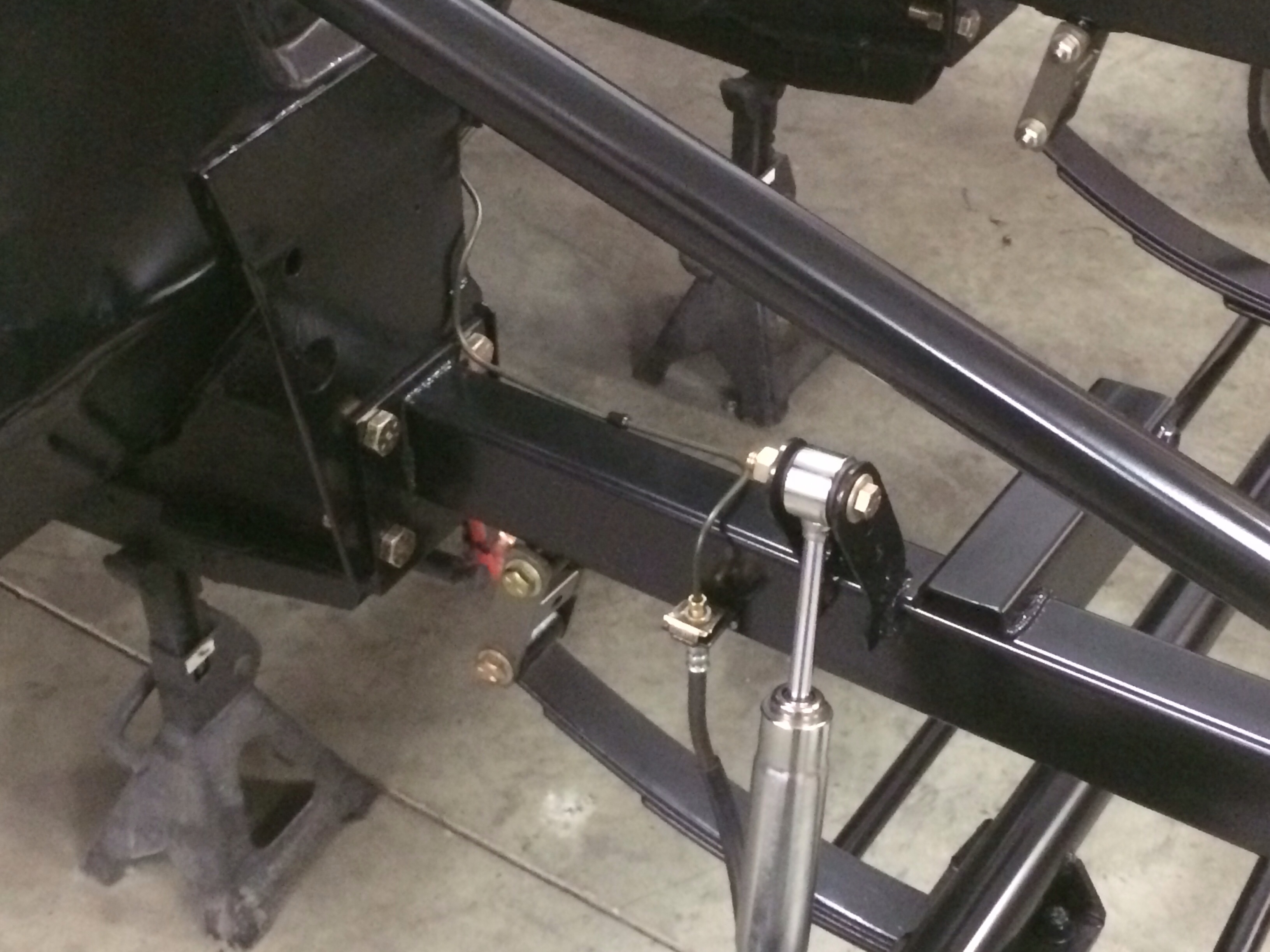

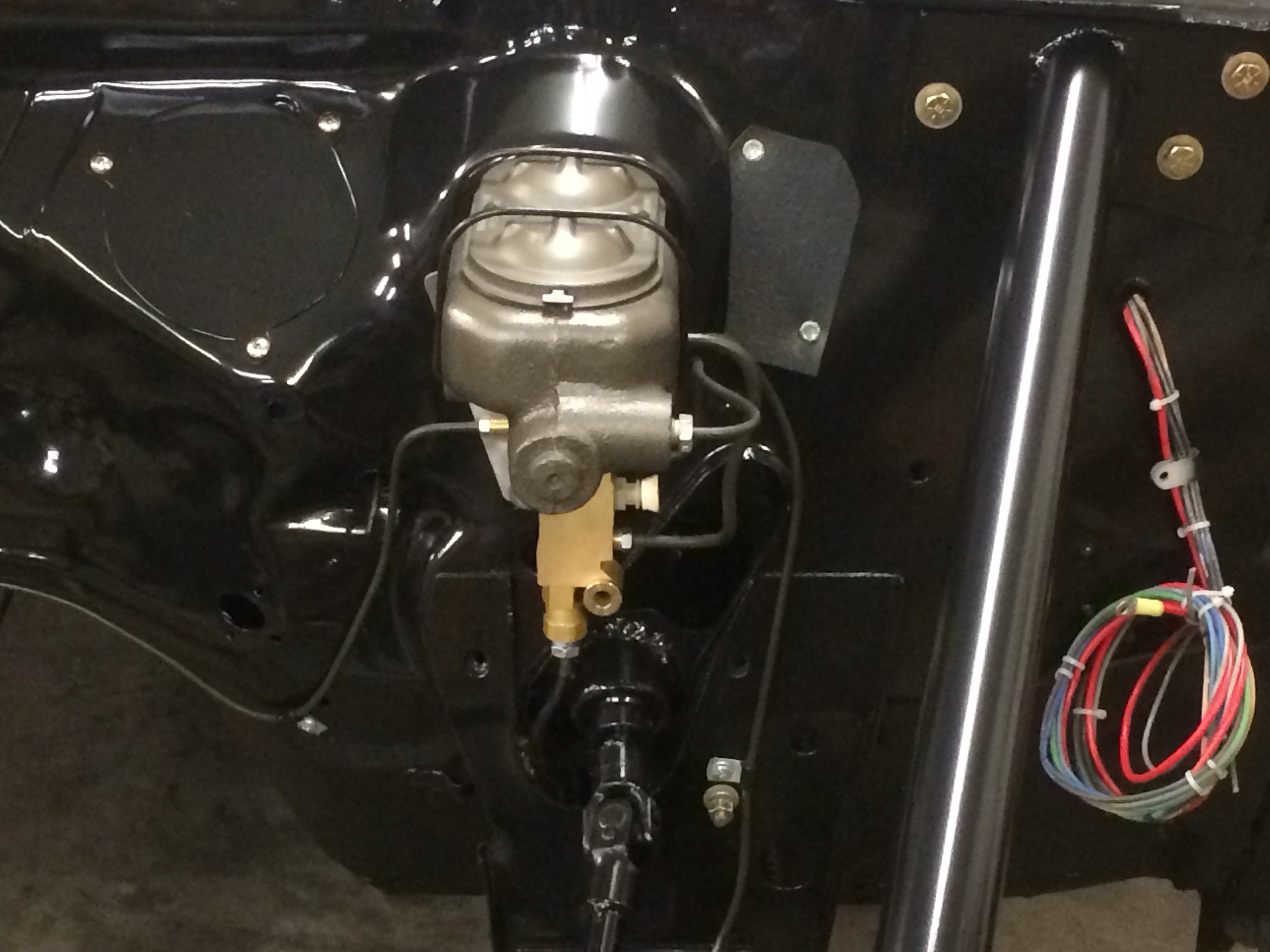

    Got some work done this week built the rear end brackets, bent up the ladder bar crossmember, built the ladder bars, and got my front brakes figured out thanks to Kip. Also Got shipping conformation on the fibergl*** panels getting picked up tomorrow and hopefully will be to me sometime this week.

    I like those ladder bars, look nice and strong!:D

    Thanks I built these ladder bars like the ones Quain Stott builds they are 1 1/4 .120 dom main bars and then we tap 3/4" dom tap tube for the bungs fits snug in the 1 1/4" tube and the cross bard are 7/8 .083. What do u mean by fg parts Scott?
